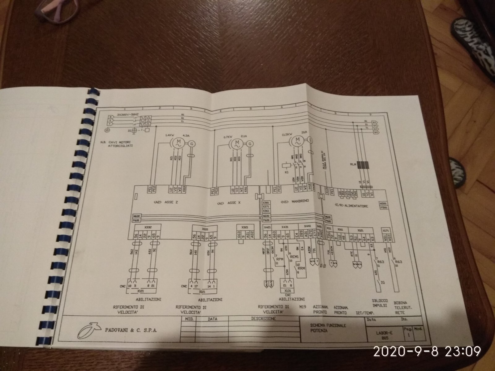

example X axis - simodrive X331 pin 14 & 56 - mesa TB5 pin GND & AOUT0
X331 pin 65 - mesa TB5 ENA0-
X331 pin 9 - mesa TB5 ENA0+
same for Z axis X332
and similar for spindle X421 - pin 14 & 56 is +/-10V signal TB5 GND & AOUT
spindle enable X431 pin 9 - mesa TB5 ENA+, X431 pin 65 - ENA-
you also need to connect pin 663 pulse enable to pin 9, through mesa or safety circuit within your machine (e-stop etc)
it depends if you want spindle to brake or to coast down in a no-current condition when you hit e-stop

yes I was able to start spindle with 1,2v battery
green light is missing enable, yellow/orange light is module ready so you're good
In my lathe power from simodrive to spindle goes through big motor contactor K1,
do you also have this contactor next to simodrive? does it work?
fault F-11 as I understand is basically drive doesnt sense that the motor is turning,
motor is stuck, faulty encoder, faulty wiring or faulty drive

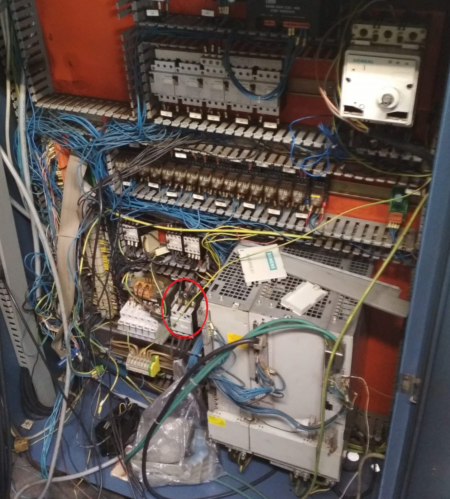

yes friend, mu lathe has doing well until i lost parametres so sinumerik with battery disharged and i didnt replace it properly.. now please see the photo in attach i see there is that contactor K1, How i can find him on motor?
ps i jumped all 24v wires input on 663, 65, e4, 48...on display that says RUN but not clear digits(blinking).. when i put battery on 56 and 14 than is error f11. i hope that encoder is ok and everuthing else but that contactor i dont knor does he enabe via rele?
Please send a photo of your spindle drive to se wires input 24v.
Thank you very much

you need to close K1 contactor before putting battery on 56&14, for testing you can even push it in with a screwdriver and hold it
I don't have an electrical diagram and don't remember at the moment which relay is responsible for K1

thank you i find k1 before reply i also try this, but when i push that lightning and smells on k1:( .. i checked contactor after and it is ok, maybe some induction during contact or it back dc voltage to relay, maybe i can try to unplag wires from contactor which is going to relay and try again to use contactor as switch.can you tell me what says on your drive display?Run?

I just started spindle, that was contactor as you said. Thank you very much i am waiting mesa 7i77 maybe needs some other help.. I am happy like a child, thank you all the best
