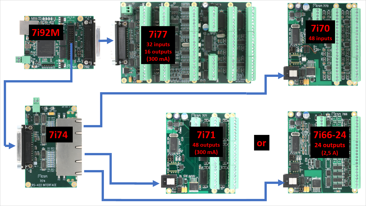

Made a collage of the different cards I need, does it look correct and sensible?

Also; what does the 7i84 bring to the table when talking Biesse - only convenience to add a few extra IO's, or are there technical requirements it fulfills, that the 7i70/7i71 combo does not?

02 Sep 2020 21:38 #180469
Replied by tommylight on topic Biesse Rover 322 MESA retrofit
7i70 and 7i71 have LED for each input or output, 7i84 does not, but 7i84 is very nice for when you need to add inputs AND outputs so you do not have to buy 2 cards.

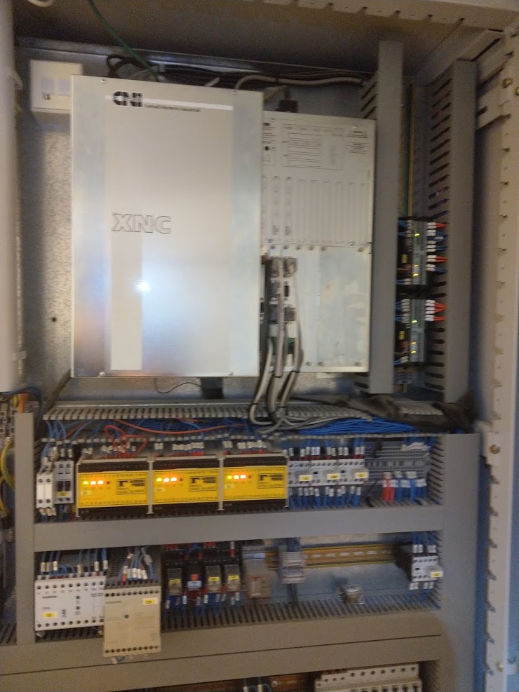

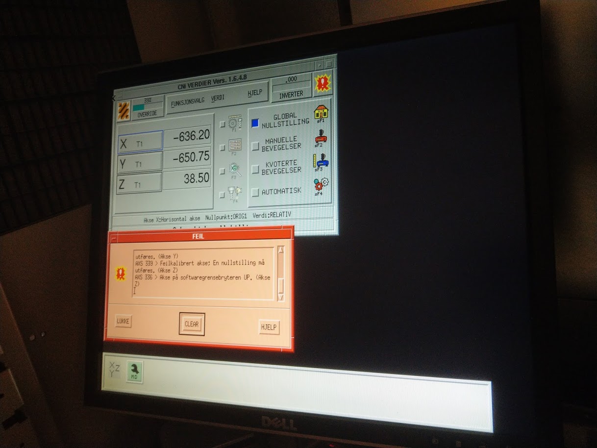

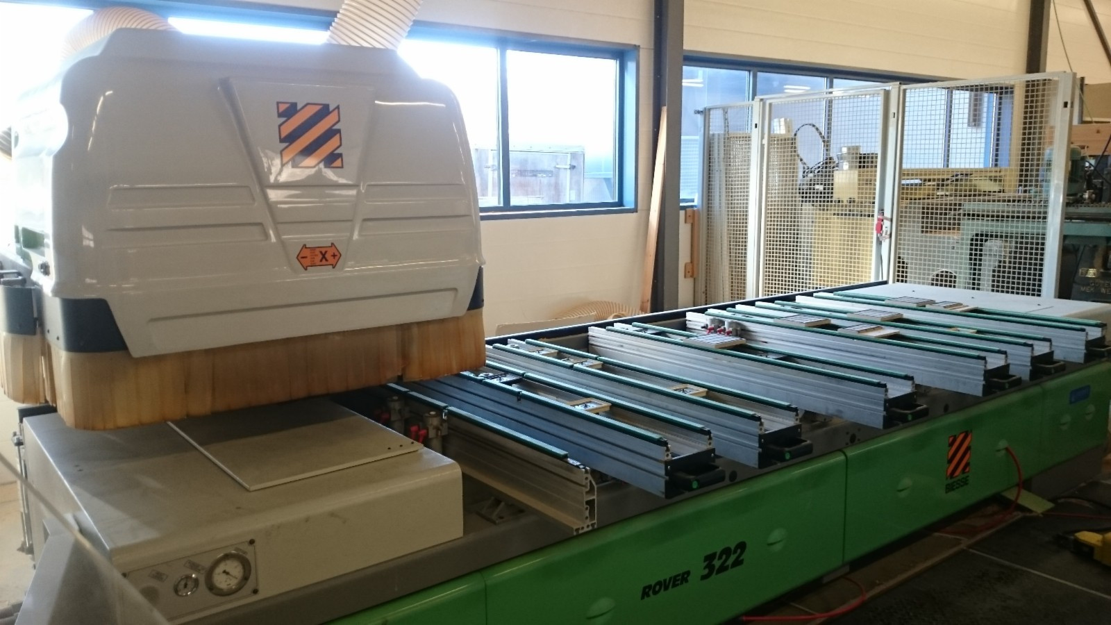

Time for a update.
Picked up the machine last week, got it home and in temporary storage where I can work on it. Got it connected up to power and replaced the broken CRT with a temporary LCD and got the computer booted up. Almost had to wipe a tear of nostalgia with the 640k of memory and 3,5" floppy drive.
The owner got it new in '97 and I got a bunch of documentation with it (original manuals etc). Copied down all the IO's from the schematics into a spreadsheet, including wire numbers and descriptions. Verified at the machine and found a few extra here and there. Will be quite interesting to figure out what they are for. My list contains 168 IO (76 in, 92 outputs) so far. Servos, drive and control panel seem to all use serial connections and will come in addition.
A total of 9 CNI IO modules in the machine: 2 in the main switchboard, 2 in left side of table. 2 in center of table and 3 in the head.
Next up with the machine will be to add compressed air and vacuum pump and see if it comes alive for real. Unfortunately I do not have space currently to allow full Y-axis movement and thus cannot home it. Hope to be able to jog it at least, so I can confirm that everything else works.
