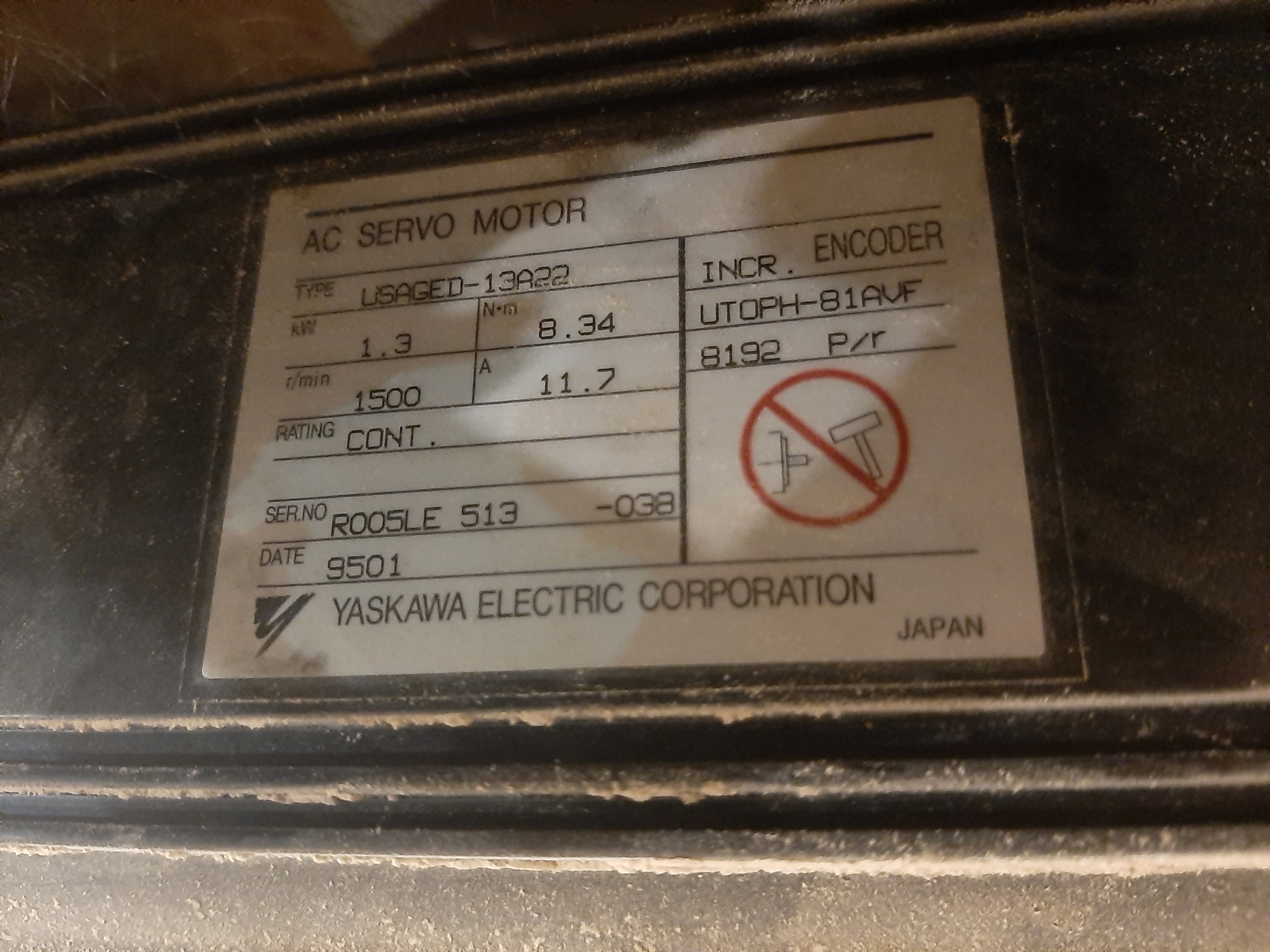

What Servos you have on that machine?

14 Nov 2020 07:17 #189301
by viesturs.lacis
Attached is a picture of a label on Y axis motor.
You mentioned that you changed servodrive settings related to encoder. Today I wanted to start by making sure that encoder feedback works correctly and to get the input scale as precise as possible. Currently it seems to be way wrong, measured and actual distance traveled differs approximately 10 times. Seemed like simple adjustment of scale value.
But what puzzles me is that Y axis is slowly drifting and it can travel 40-60 mm while there is no position change detected. So I wanted to check servo drive settings regarding position output. The manual I found seems good enough to explain, which parameter is that and how to get there, but what I do not understand is how to get in "setting mode". Manual and label on drive says to use SW4. But nothing happens to any of the drives, if I press SW4 shortly or press and hold it for longer time. Tried to hold it up to 10 seconds. Nothing. What am I missing here?
