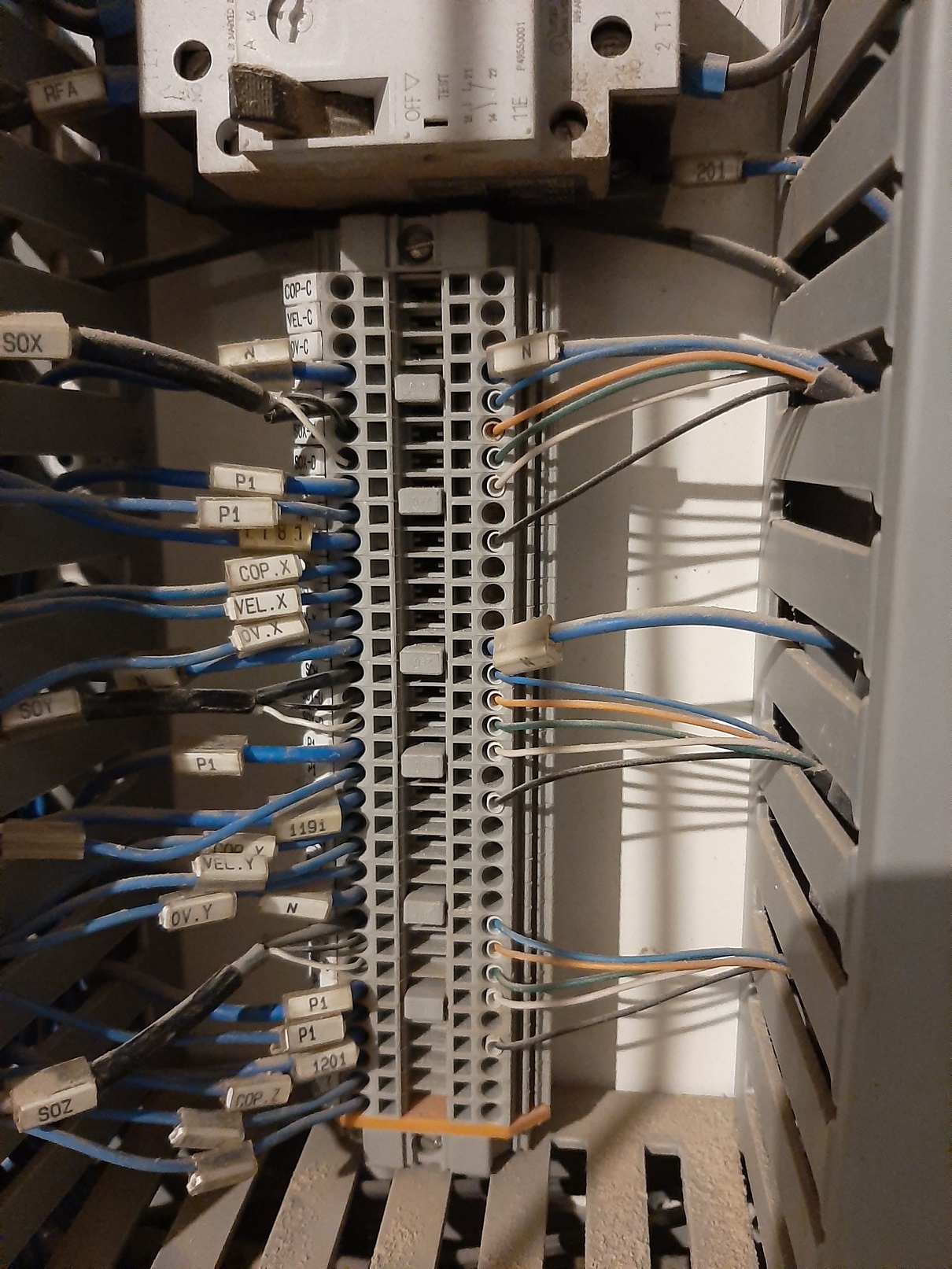

14 Nov 2020 13:08 #189326
by viesturs.lacis
And then there are unconnected wires. I have attached a picture of terminals, where right side are cables from machine, left side goes to servodrives.
SOX, SOY, SOZ seem to be wires for encoder pulses. But I have no idea, what are COP.X and VEL.X 0 they are not connected to anything. Is there some optional equipment that is not present in this machine or is the machine missing something essential?
Replied by viesturs.lacis on topic I am stuck with Biesse Rover 322 retrofit
Did you check your wiring?
Make sure you have continuity from encoder to the 7i77 to make sure there is no broken wire
