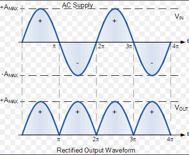

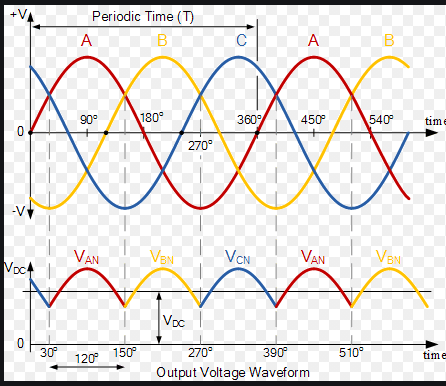

I just got a CHNC with GN6 controls. This has 90v HIAK servo drives. The previous owner "converted" this machine to single phase. I have been chasing quite a few issues down, one of them I think may be due to the extra ripple voltage I would be getting from having a rectified single phase vs 3 phase coming to the servo drives.
To size a suitable cap for this I would need to know what is a reasonable level of ripple voltage for input power to DC drives such as this.

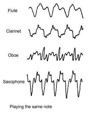

The problem I think may be a result of this is the velocity feedback I am getting from the revolvers looks like the sound wave of an instrument while the axis is in motion.... Also to be noted, is that this setup has the resolver and tach (I dont think I use) on the ballscrew and there is no feedback on the servo itself.

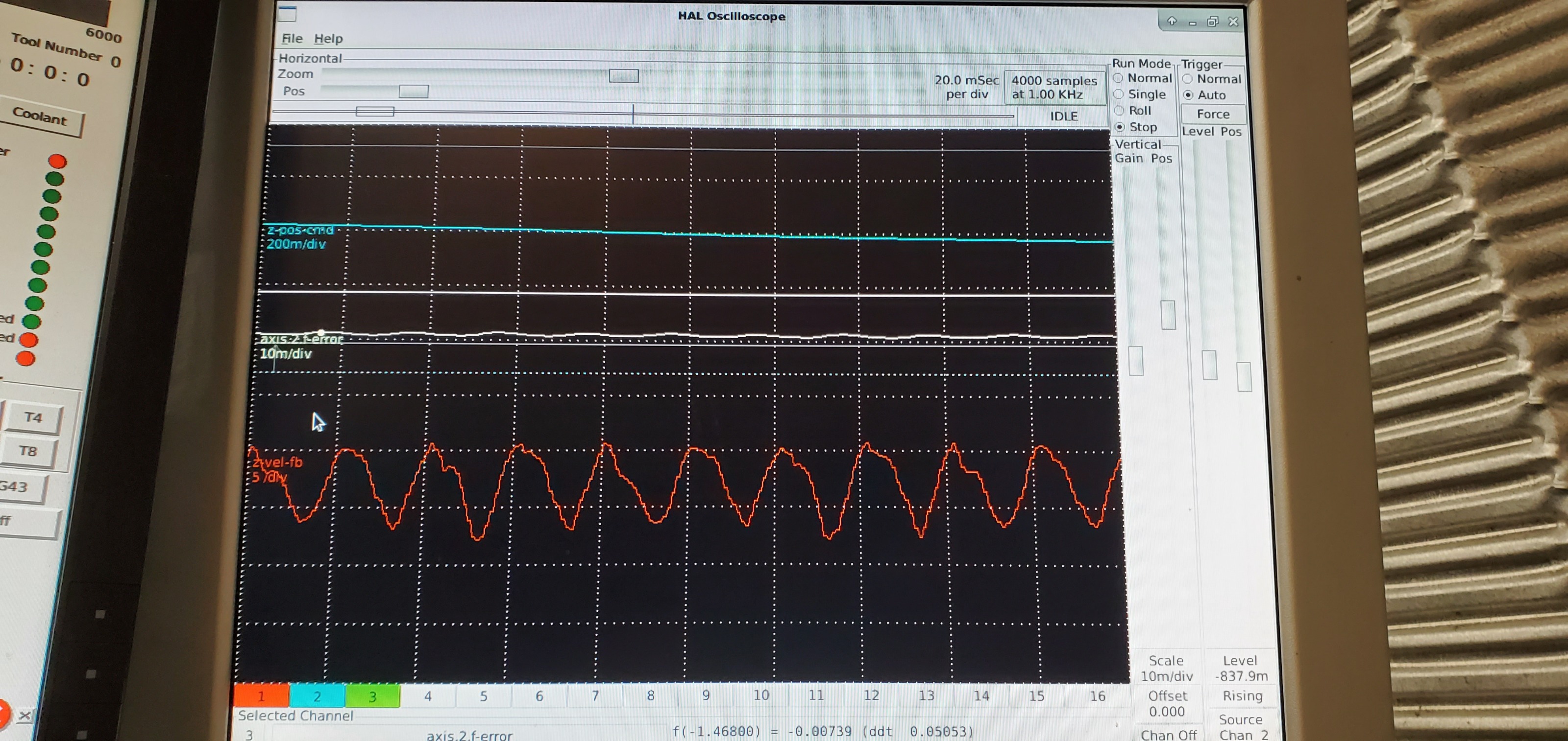

In the video are you driving the motor closed-loop at constant speed?

I did get a shot of this x axis last night at "15" ipm jog.... actually varied from 9 to 16 by halscope readings...

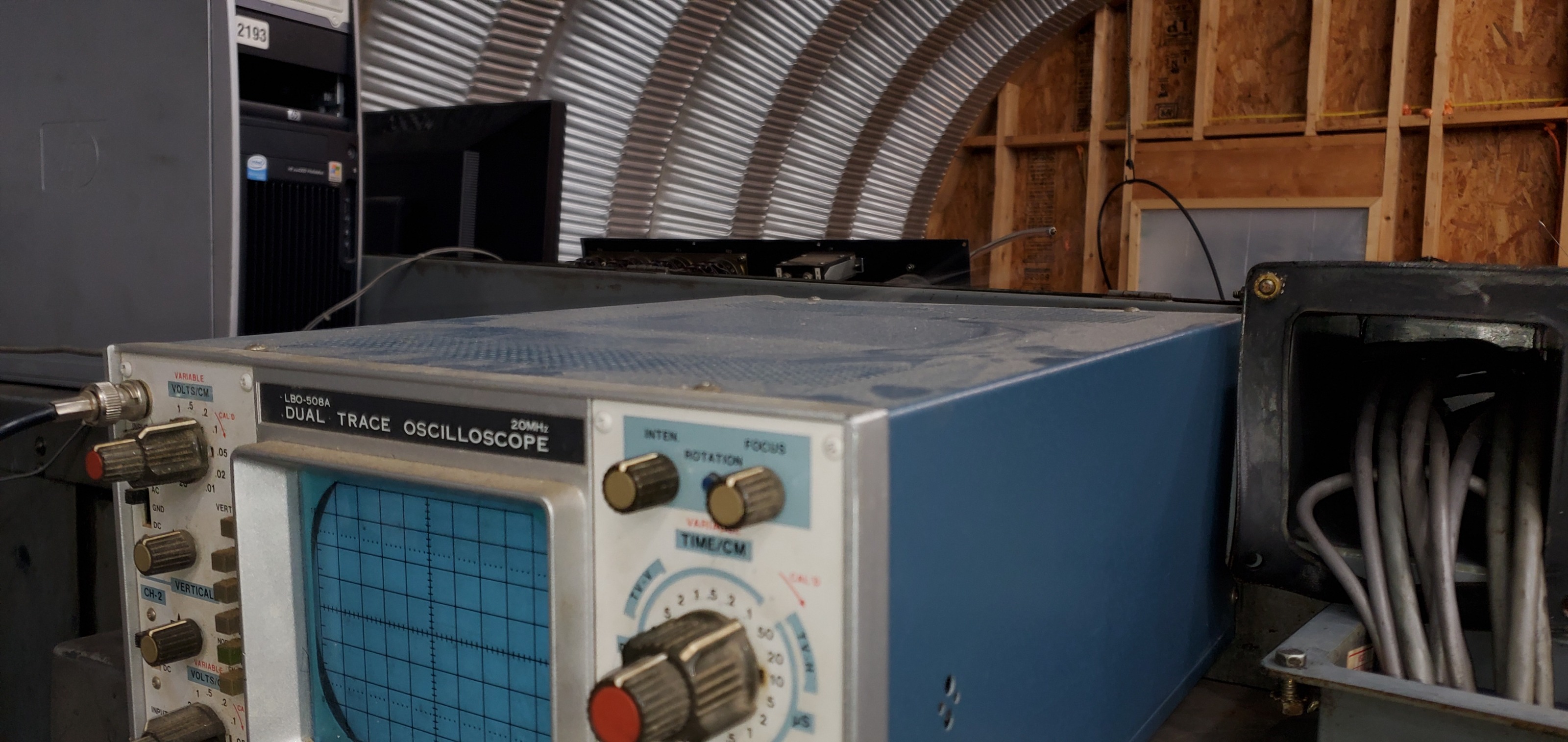

My silly scope let out the smoke last night when I was trying to view dc and servo output waveforms.... now I will attempt the open heart surgery on this old machine....

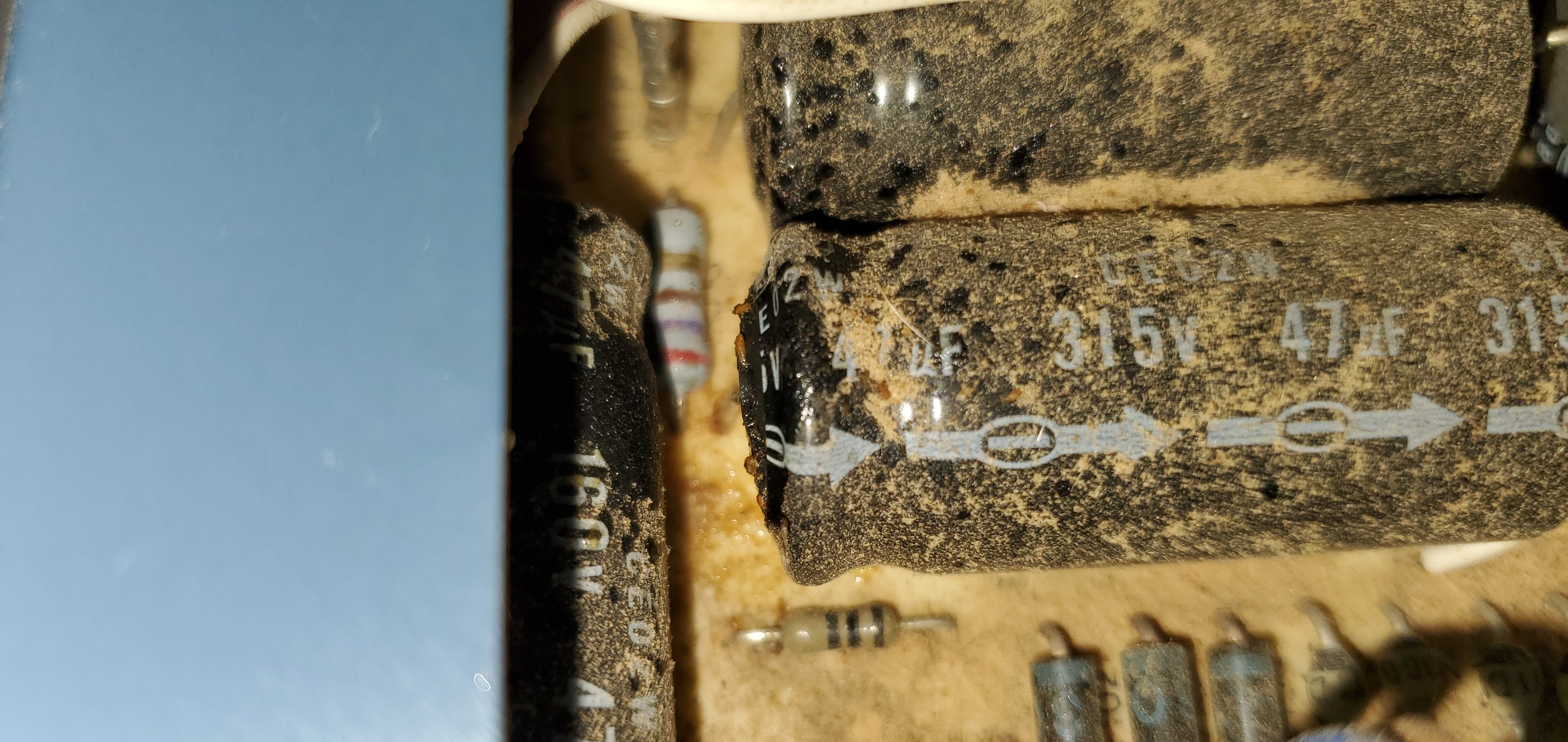

Also notable I measure 0 capacitance on the rectified dc input to the servos when off, I think they have a cap but its tucked behind other parts and I can just see the edges of a large cylinder. Maybe the enable input switches incoming power circuit when off?
