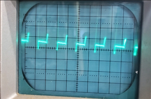

So I got my scope working and discovered a very strange output from the servo amplifier.
I can see some very slight osolations in input signal that seem like they could have a frequency similar to that seen in the velocity from the resolver. I would assume this can be the pid loop? I see similar osolations at a greater amplitude in the drive output.
I find it very odd that half of the signal "disappears" and can only assume a very high voltage during this period. I also get this when the drive is at rest....
Dc 90v supply actually had a very low ripple voltage as it turns out.
This photo is of the servo at reast with the drive powered up.

Replied by andypugh on topic Recommendation for Max ripple voltage for DC servo drives?
I would expect to see PWM, but you seem to be seeing a 1kHz variable amplitude square wave.
But, I have never scoped a servo drive output, so don't know what you would see in practice.
Was that output in the video with a motor connected, turning and reversing?

Replied by Dbsharp on topic Recommendation for Max ripple voltage for DC servo drives?
Yes 20 ipm and it reverses direction a few times. I think ill hook a double aa battery to the drive input next to see if I still get the osolations in output.
In this test I can see osolations in both but the osolations in the drive output seem to be more severe (leading me to believe this could be the source of issues.)
Both x and y do this kind of signal.

Replied by scotth on topic Recommendation for Max ripple voltage for DC servo drives?
The old Hiak driver were pretty solid. Can you use a battery box to slowly run the slide in an open loop and see if you still have the problem?

Thanks for all the suggestions, I verified wiring of resolver last night.
I also scoped out the resolver signals and they look exactly as I expected.
I removed the drive belt to the motor and turned the ballscrew by hand and I am still getting this very choppy velocity feedback. At this point I think I have more or less proven the issue is in the resolver interface or my setup of Linux cnc.
Plan is to redo this setup from scratch, very little actually works well here (even the instal of Linux seems to have weird bugs). I will start clean with 2.8 on a new hard drive (so I can switch back if needed)... and ssd > hdd
In case anyone ever is searching for answers to a similar problem, I found the issue on this. The resolvers on my hardinge are not 1:2 or 1:1. They are "syncro resolver control transformer" with 2:1 ratio. It says 2 pahse in 12v and 1 phase out 6v on the resolver. I was getting 1.6v back from the resolvers using the half voltage ouptut.
So I made a voltage divider circuit to cut the 1v reference signal from the 7i49 down to .5v, and now the resolver signals are right at 1 v and it's working great. I checked motion with a couple different .0001" indicators and it's on the money, no more nonlinear issues.
