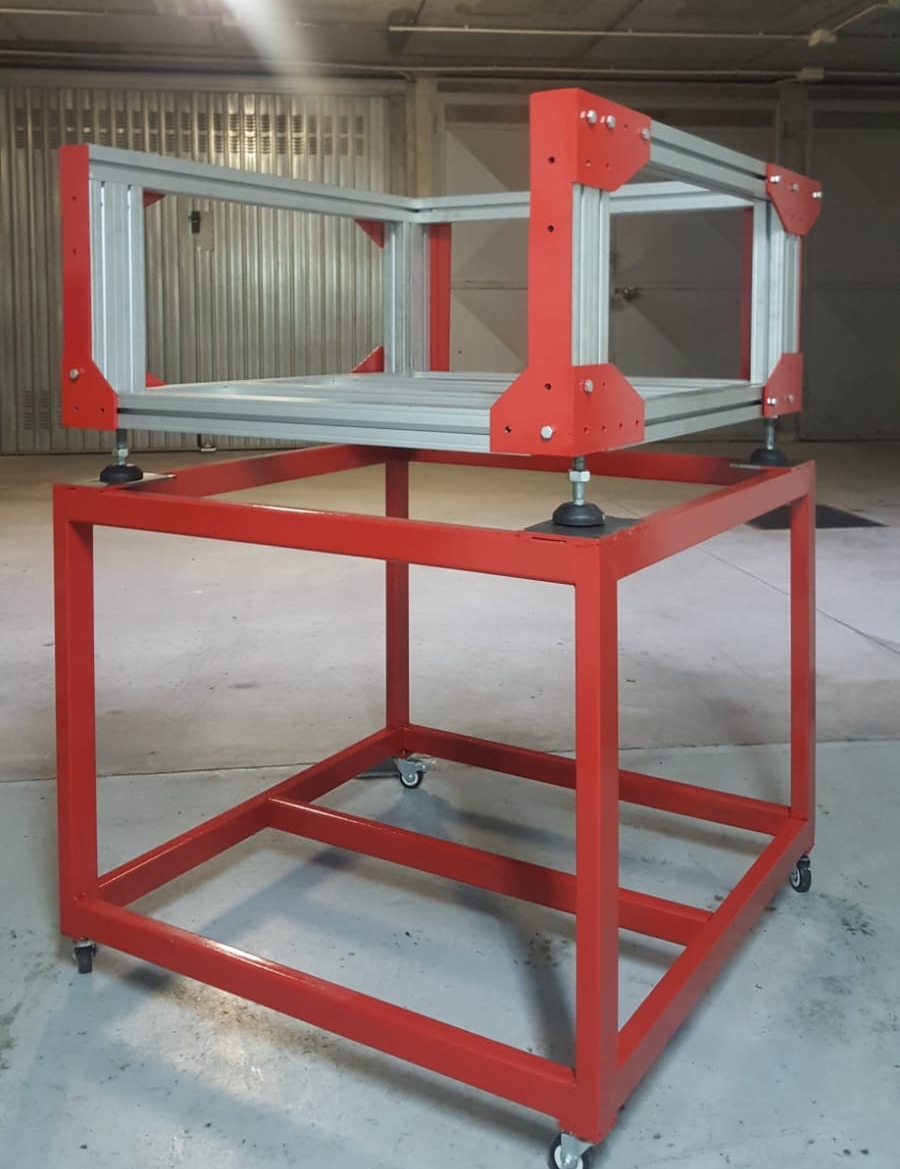

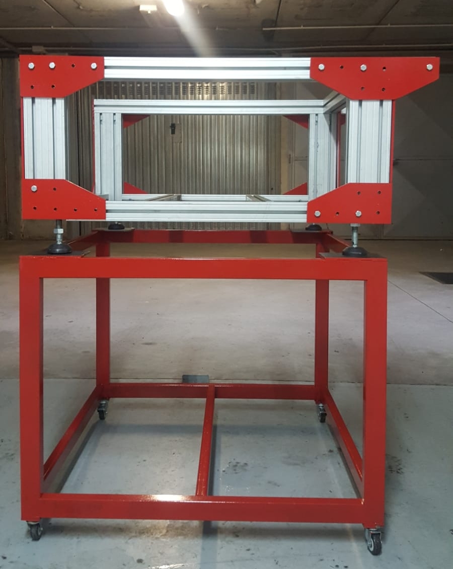

Hi to all, how's it going?
This is my first post here on the forum, I'm still a total noob regarding both LinuxCNC and cnc in general so please be patient with me. I'm slowly getting there. By looking at some forum posts around here I'm feeling like a dwarf in the middle of titans.

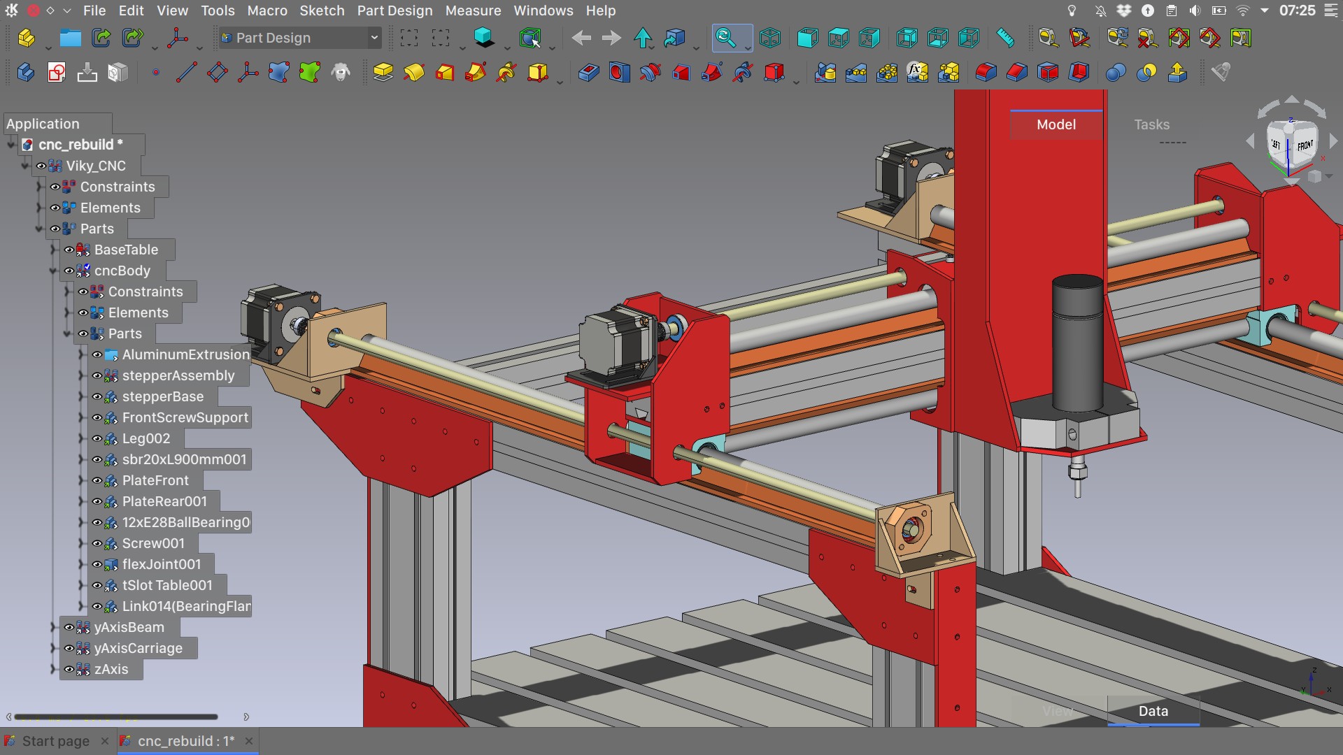

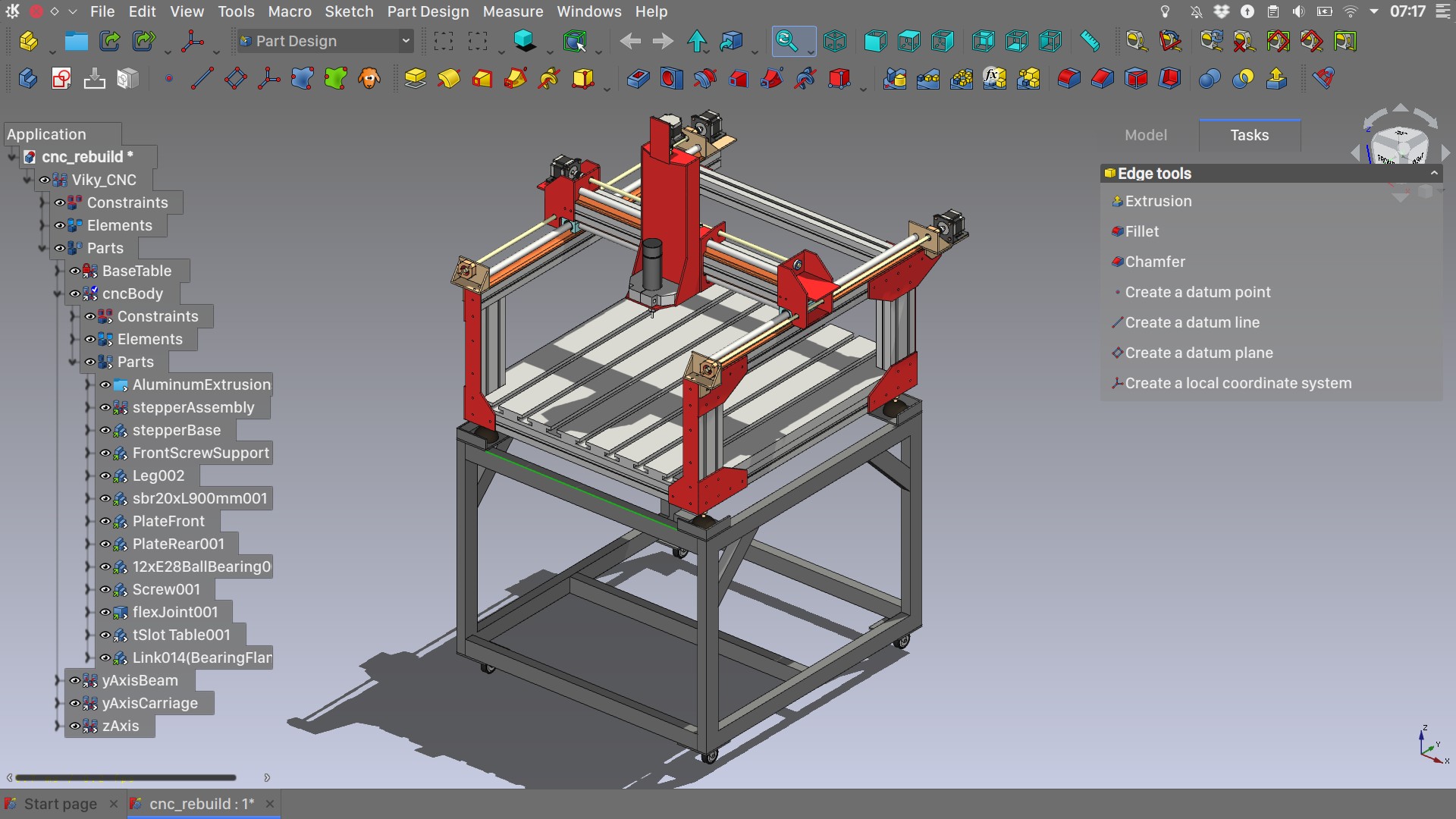

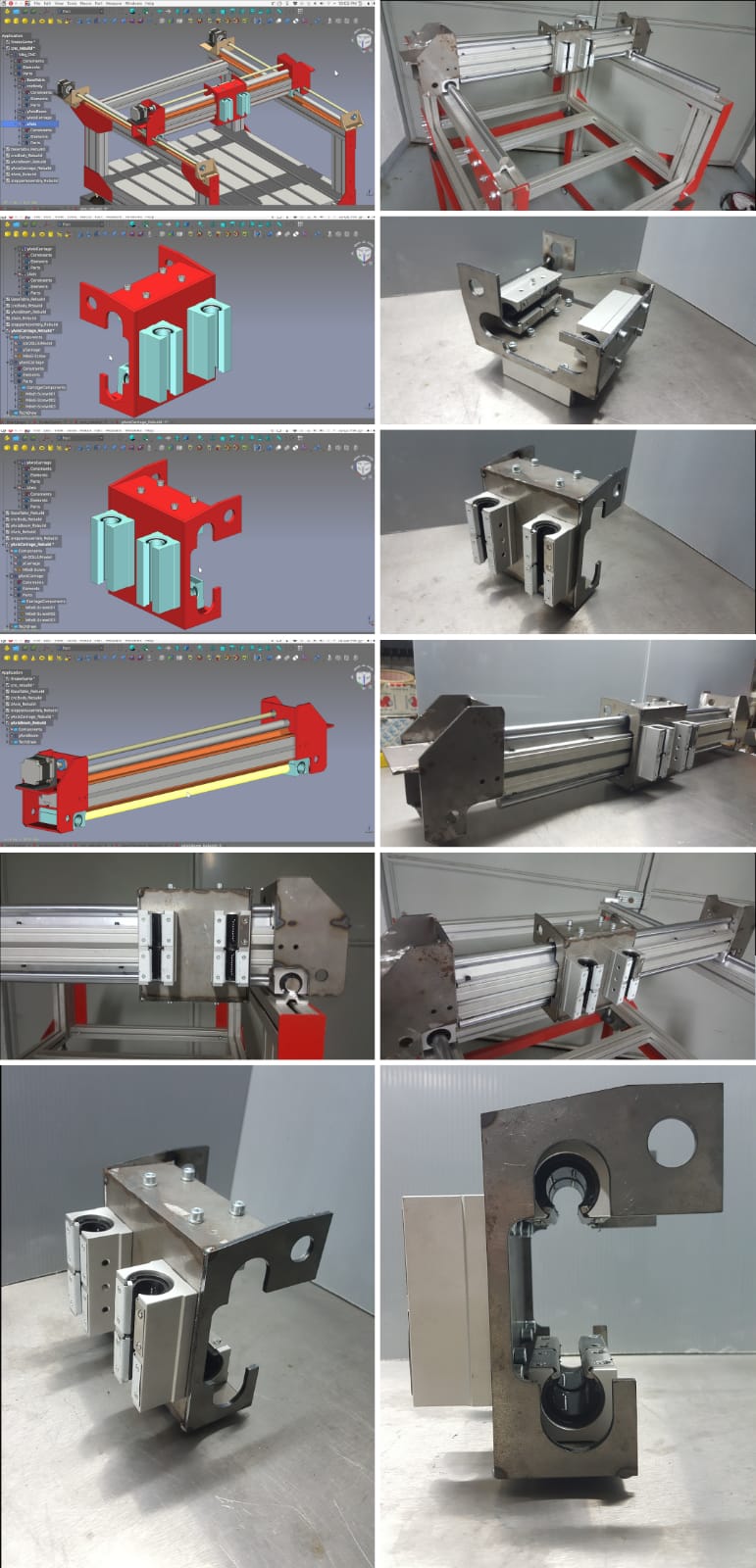

Anyway, to the point. As I'm kind of involved with the FreeCAD developers and community, this project was started as a test bench file for the modelling and assembly capabilities of the cad software. (for credibility points, the hexapod model on the splash screen of version 0.19 is one of my models).
Some screenshots of the cad model inside freecad

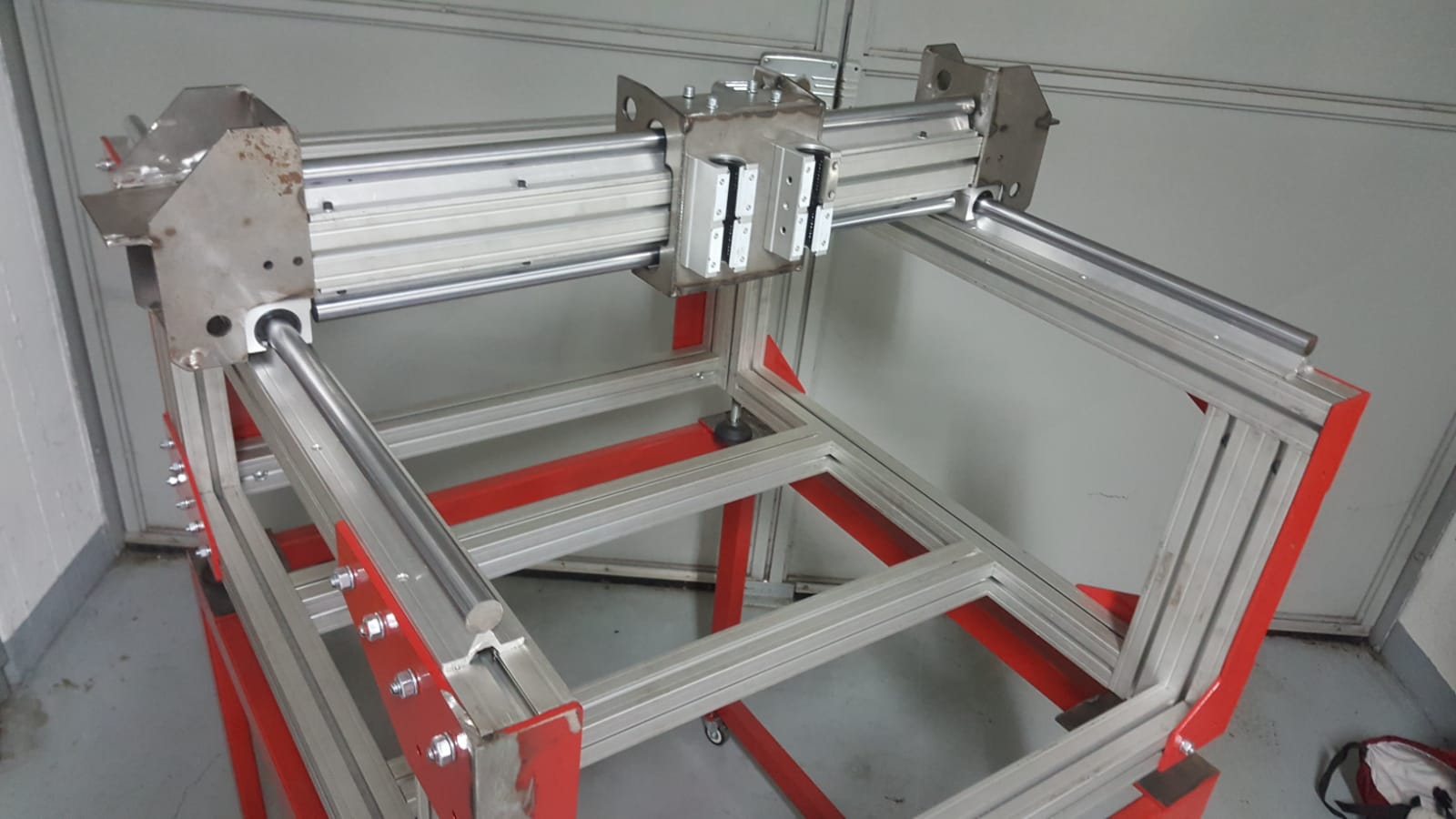

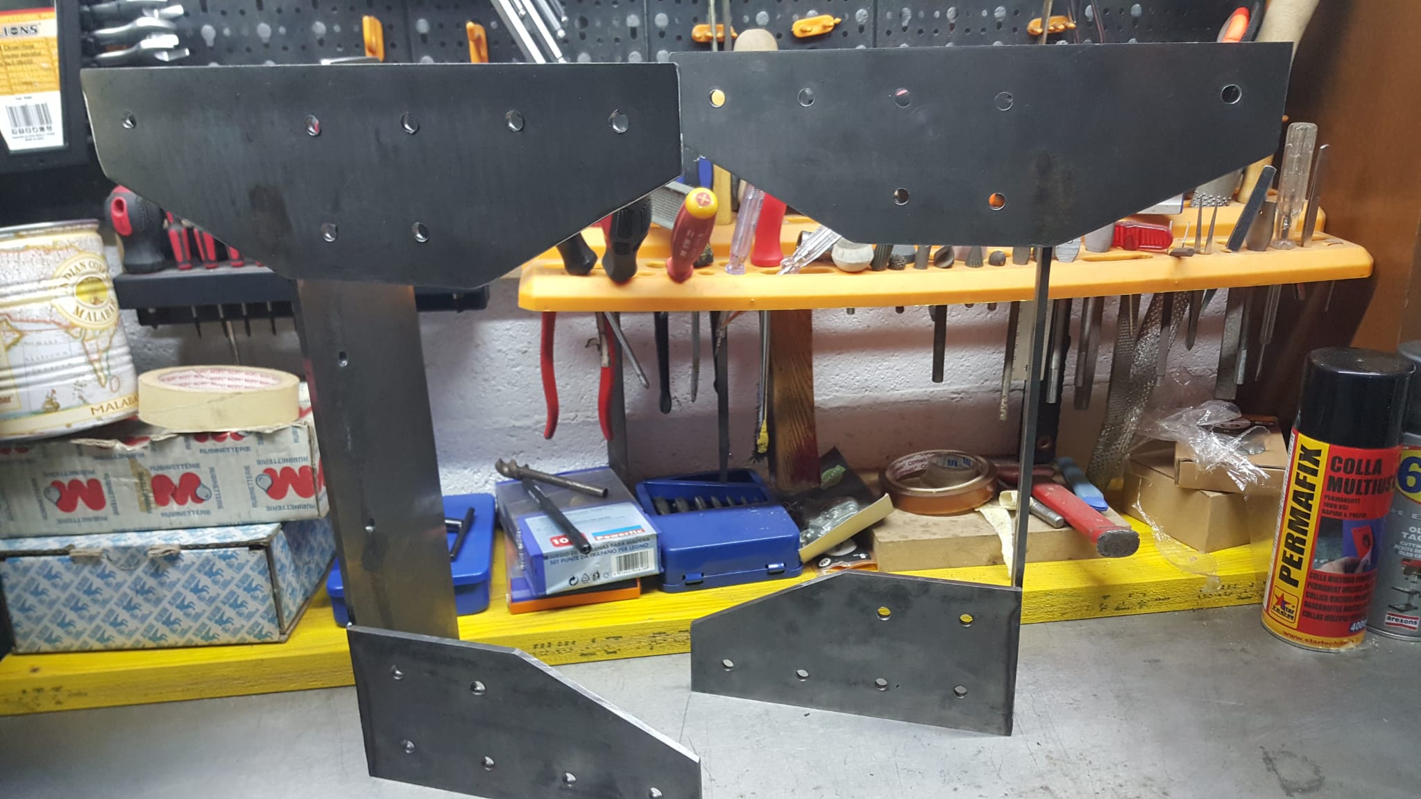

Allot of the design decisions for this machine were driven by cost. I tried to get the best bang for the buck pretty much everywhere as this is a hobby project. Some design and material choices will make the hair rise on people around here that work with micron tolerances. My excuse is that I still have to buy a proper micrometer. It is all a learning experience.

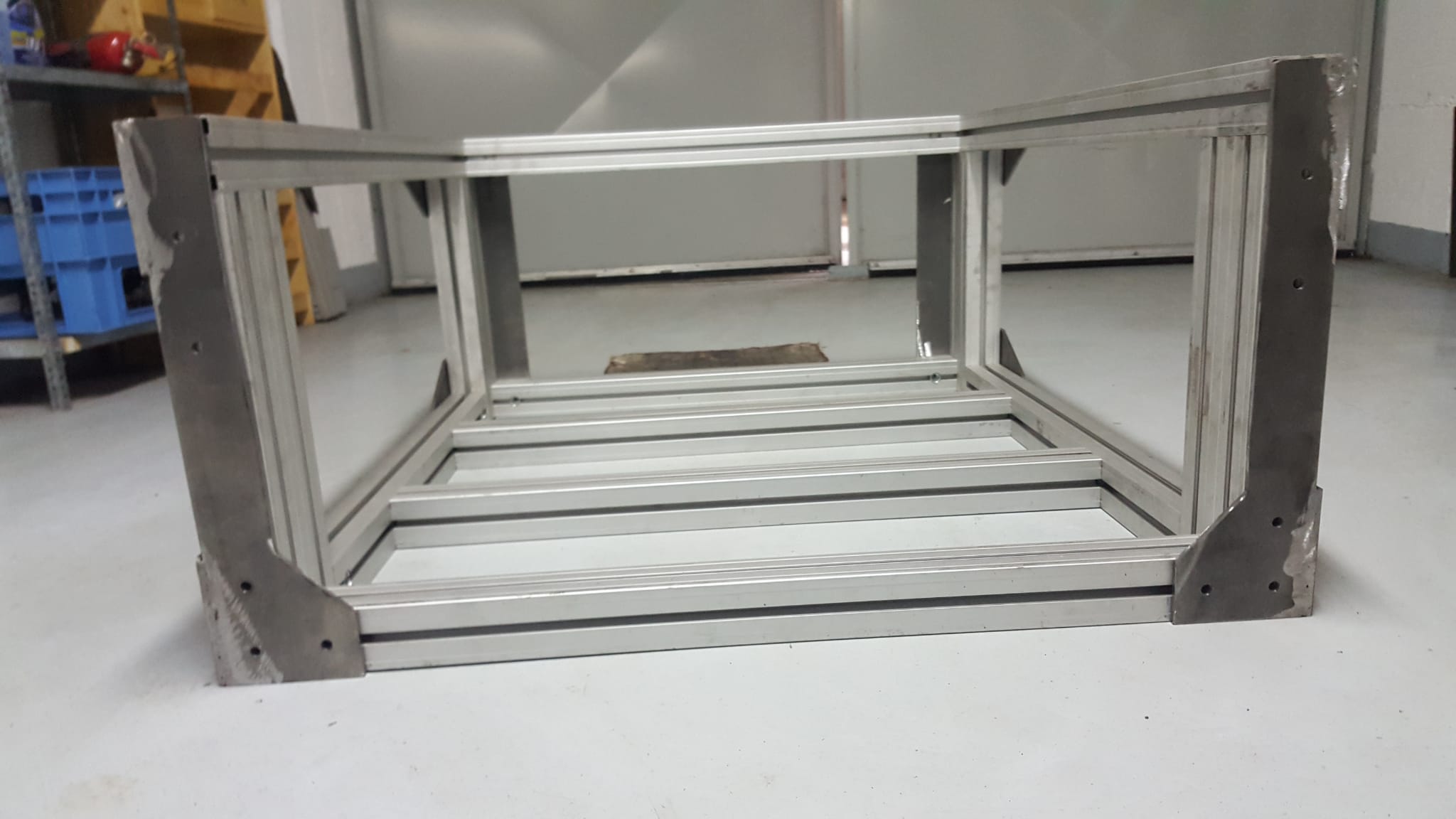

The frame is out of 50x50 or 50x100 aluminum extrusion that I was lucky enough to recover from some dismissed industrial machines. The aluminum extrusions were reinforced with 5mm cold rolled steel bolted to the frame. These reinforcements were cuted and driled by hand with allot sweat and tears. None the less I think they came out pretty good.

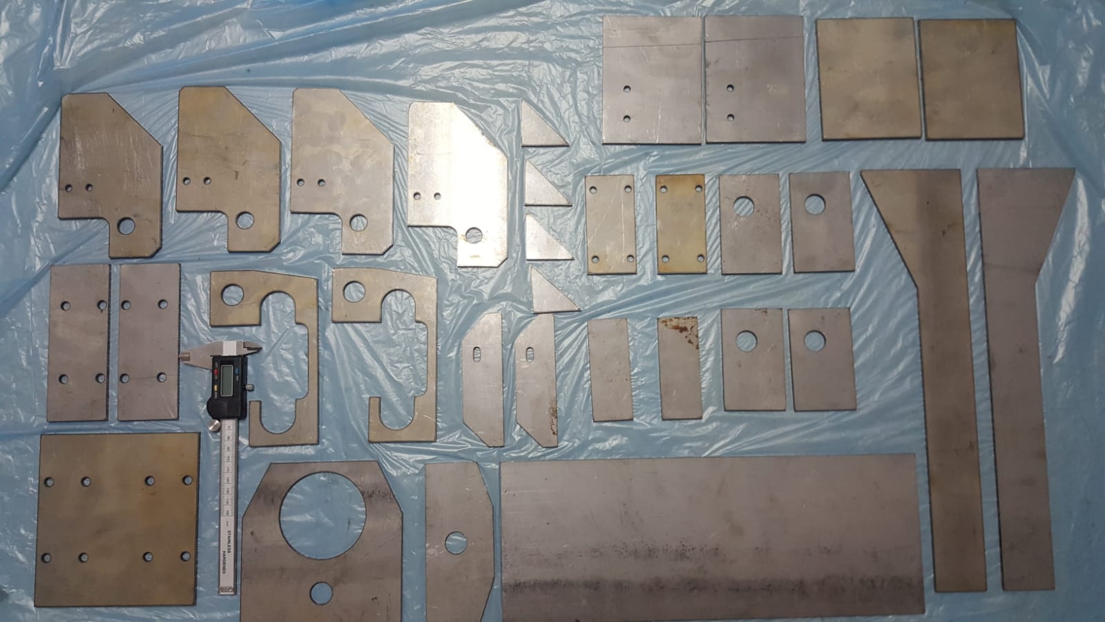

After learning that cold rolled steel is tough to work with by hand I decided to laser cut some of the components that were missing.

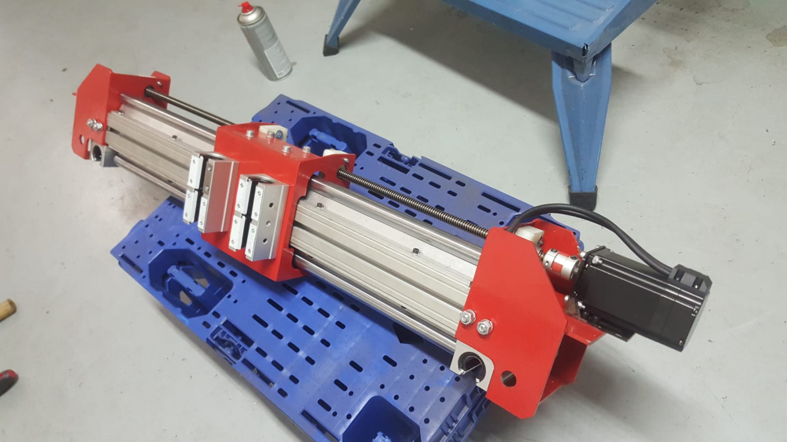

And this is the X axis after a bit of work

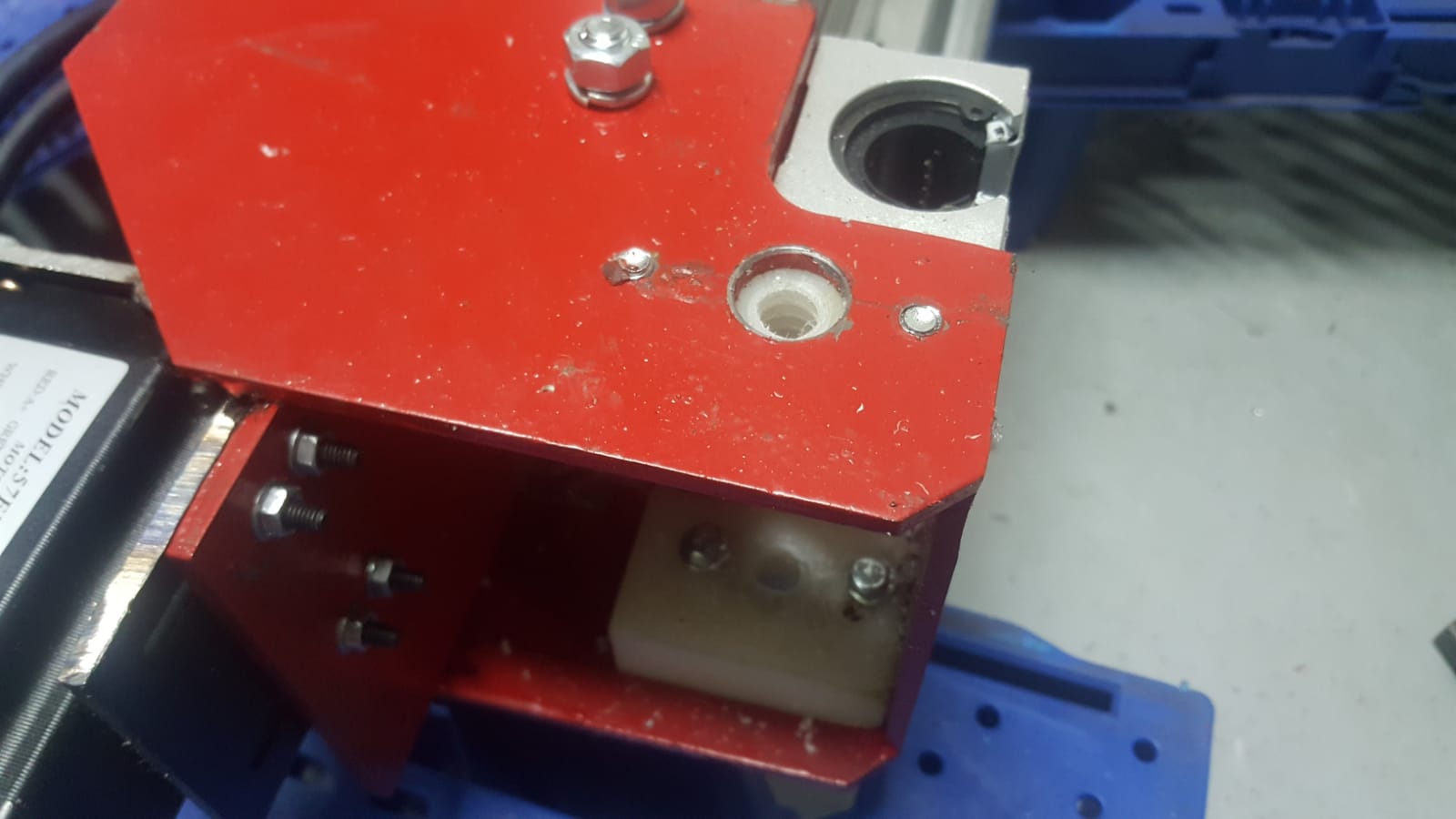

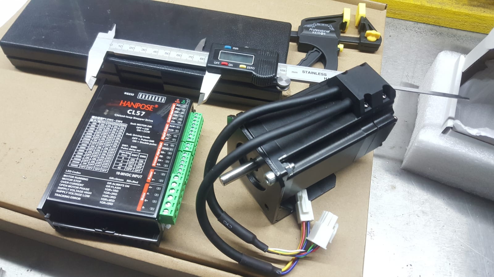

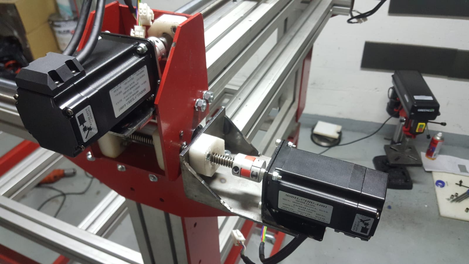

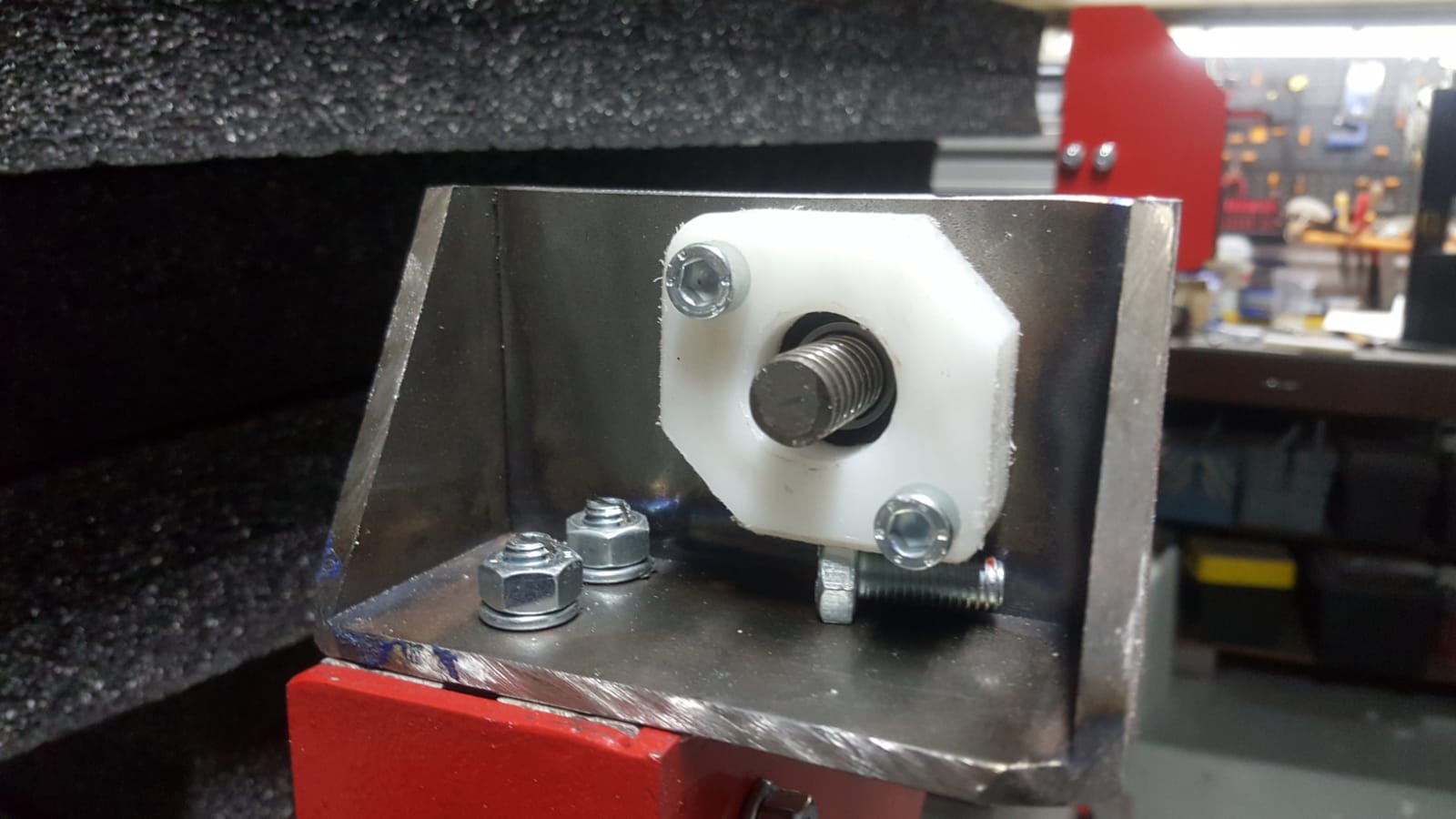

The machine electronics choice is Mesa7i96 Etherenet card coupled with cheapo closed loop nema 23 steppers from AliExpress (they seem to work allot better than expected tough). I had a really hard time wiring them because I NEED TO PAY ATTENTION TO WHAT I AM DOING. While testing the first motor and after loosing countless hours on the internets thinking I have wired wrong the mesa card or the encoders I realized that i have inverted one of the coils wires. These motors are pretty much plug and play. With that solved i went ahead and wired the tandem Y axis too

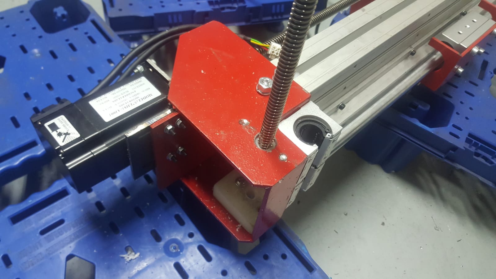

As previously stated, allot of the design decisions for this machine were driven by cost. One of those decisions was to use trapezoidal screws instead of higher quality ball screws. The design is made so that thees can be added at a later time.
Now for the problem: the trapezoidal screws are not strait. It seems they arrived curved and this is a HUGE problem. Now I don't want to wait for another set of screws and I'm pretty sure that misalignments, wrong design choices or wrong parts will happen again in the future. If the build doesn't continue I will never know where the problems are.
The intention is to buy precision ball screws at a later moment and modify the machine accordingly. Lukly that will be easily done but at the moment I decided it is time to spend no more money on this type of motion and to self fabricate the trapezoidal nuts in Teflon.

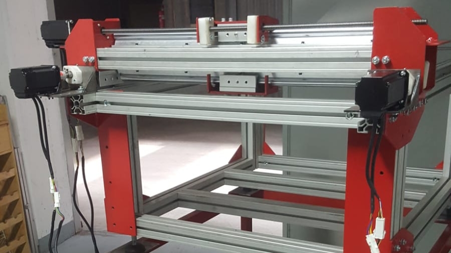

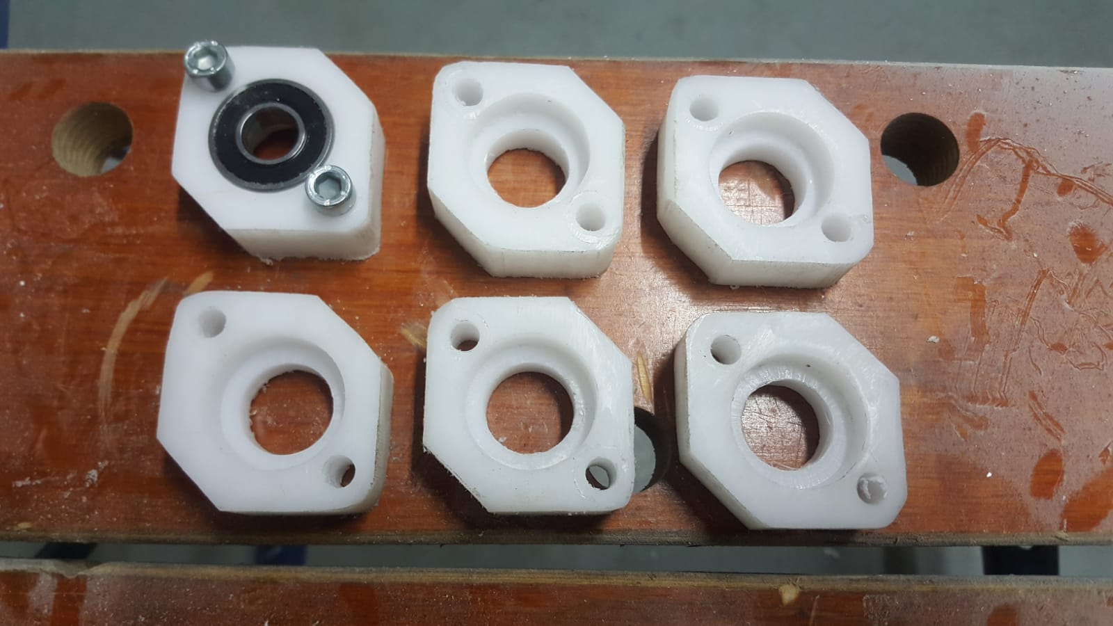

With the awareness that I will need to swap the motion with higher quality screws , I fabricated my self some teflon bearing holders in order to finally see some motion.
And low and behold we have motion. This is where my LinuxCNC adventure is starting.

Now for the first noob dillema I'm facing. Using the axis gui and after I have setted up Y as tandem in PncConf how on earth do I jog the x axis for homing? Before homing it seems that I can only jog each motor independently not together. Unfortunately I have the axis mounted on the machine at the opposite side of the home position.
I have tried to jog the axis in PncConf with the test axis utility but even there only one motor is used instead of the tandem.
I know that there might be many information missing from this question for anyone to help but if someone could give a suggestion of where to start to troubleshoot this issue I will be forever grateful.

There are no limit switches set in hal also, tandem axis will not work without them (well it can but not a good idea any way you look ta it), so you can use PncConf and edit the existing config to add limit switches and homing stuff, no need to redo everything.
So if you do not plan to use the gantry squaring and homing switches, do a new config with no tandem axis, but choose steppgen0 (or whatever the tandem axis uses) and steppgen1 as X axis, basically have to outputs for the same axis.
