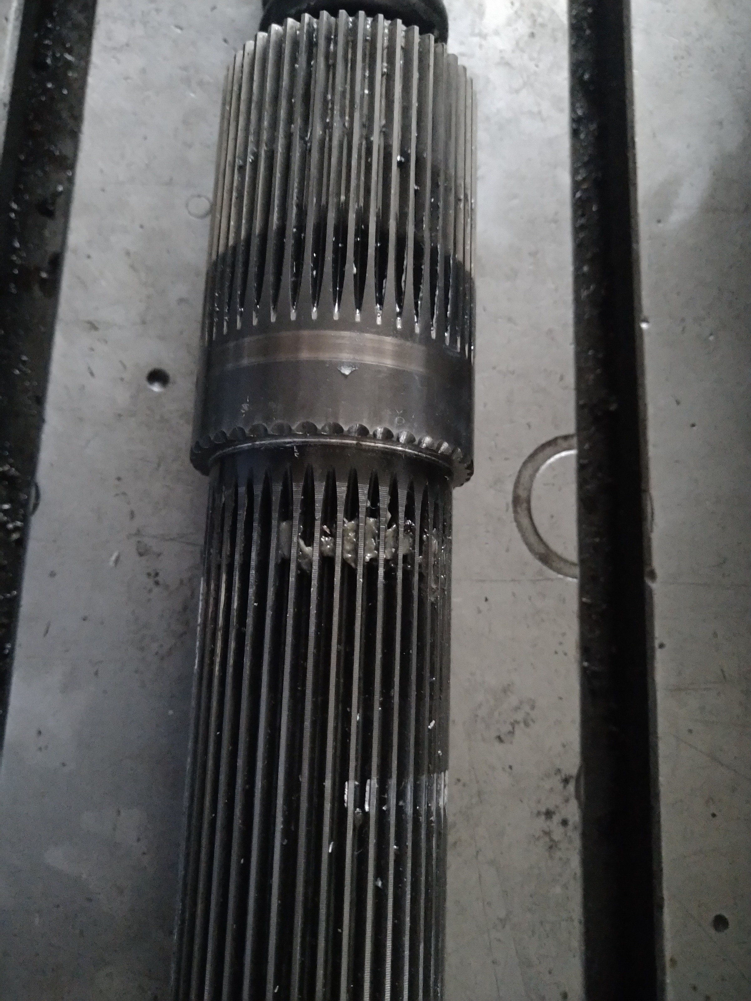

I am not really understanding the purpose of the splined shaft. It seems like a lot of engineering for no readily apparent reason.
- myval
- Posts: 137
- Thank you received: 7
18 Nov 2021 14:25 - 18 Nov 2021 14:28 #226868
by myval

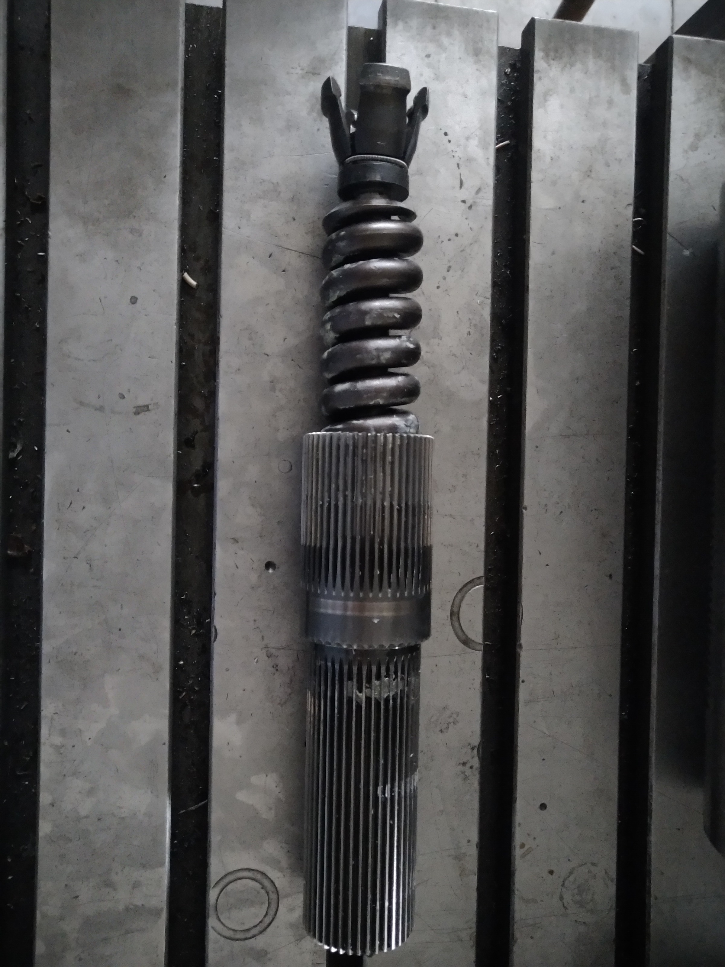

Replied by myval on topic Mikron WF 31 CH horizontal spindle disassembly
It is actually. The spline shaft moves forward and back there is the draw bar screwed in it and the hydraulic piston at the back pushes whole shaft with draw bar forward to release the tool and compresses that big ass spring.
the hydraulics pushes on that shoulder between splines.
Picture attached shows whole draw bar spline spring assy.

not sure either
i think a lot of the bits and pieces makes for easier construction when it comes to making it if you have some high end tools to build it with. the down side to something complex like this one is all the small pieces have to be about as perfect as you can make something so all the error does not stack up and defeat all the effort to make something precise. sometimes simple is good less to go wrong
i guess if you have things like oilers for bearings ,thru spindle coolant and hydraulics you need seals to keep everything separated and the complexity go up pretty quickly as a result.
this spindle makes mine look like a 1st grade science project
