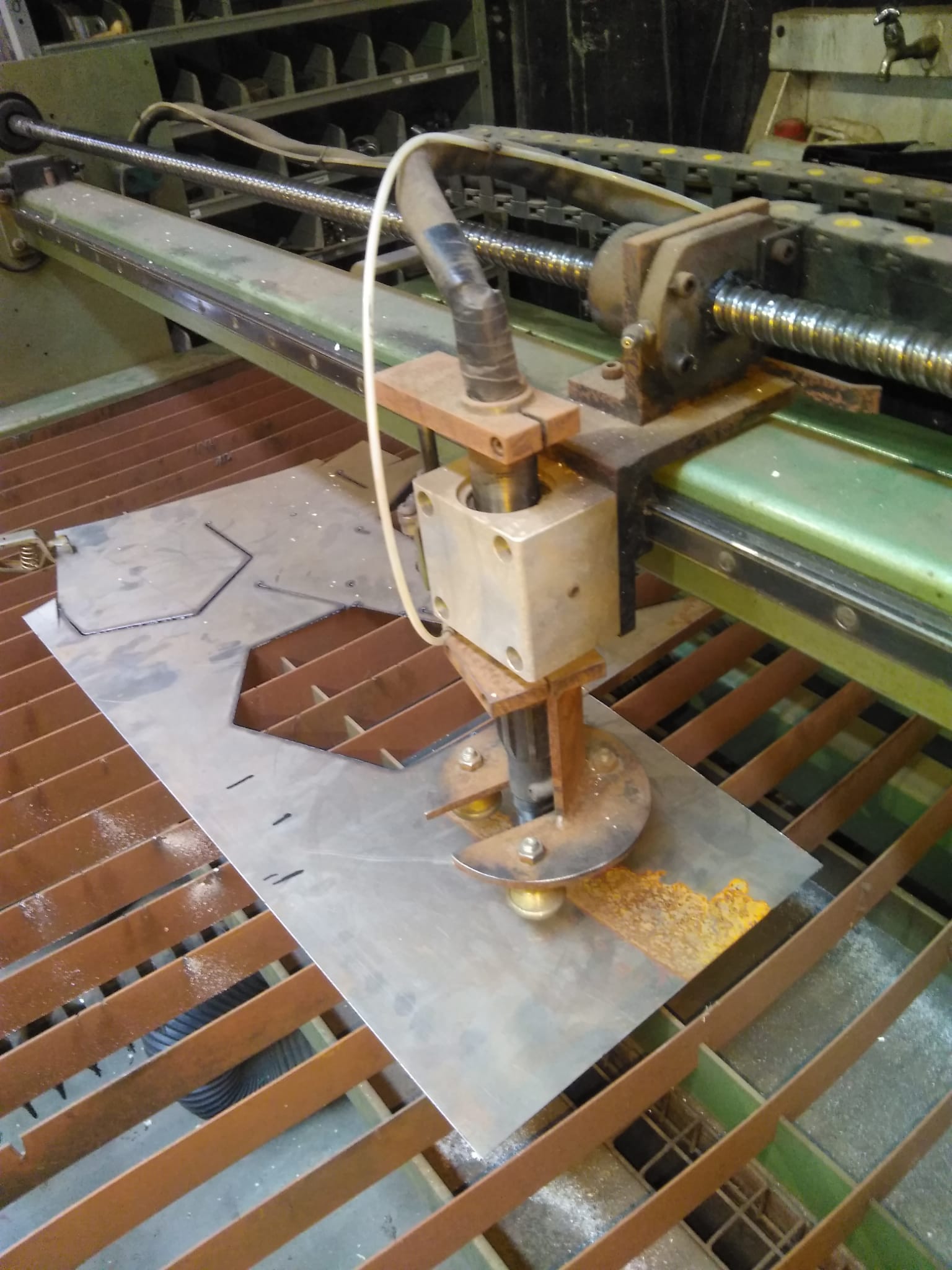

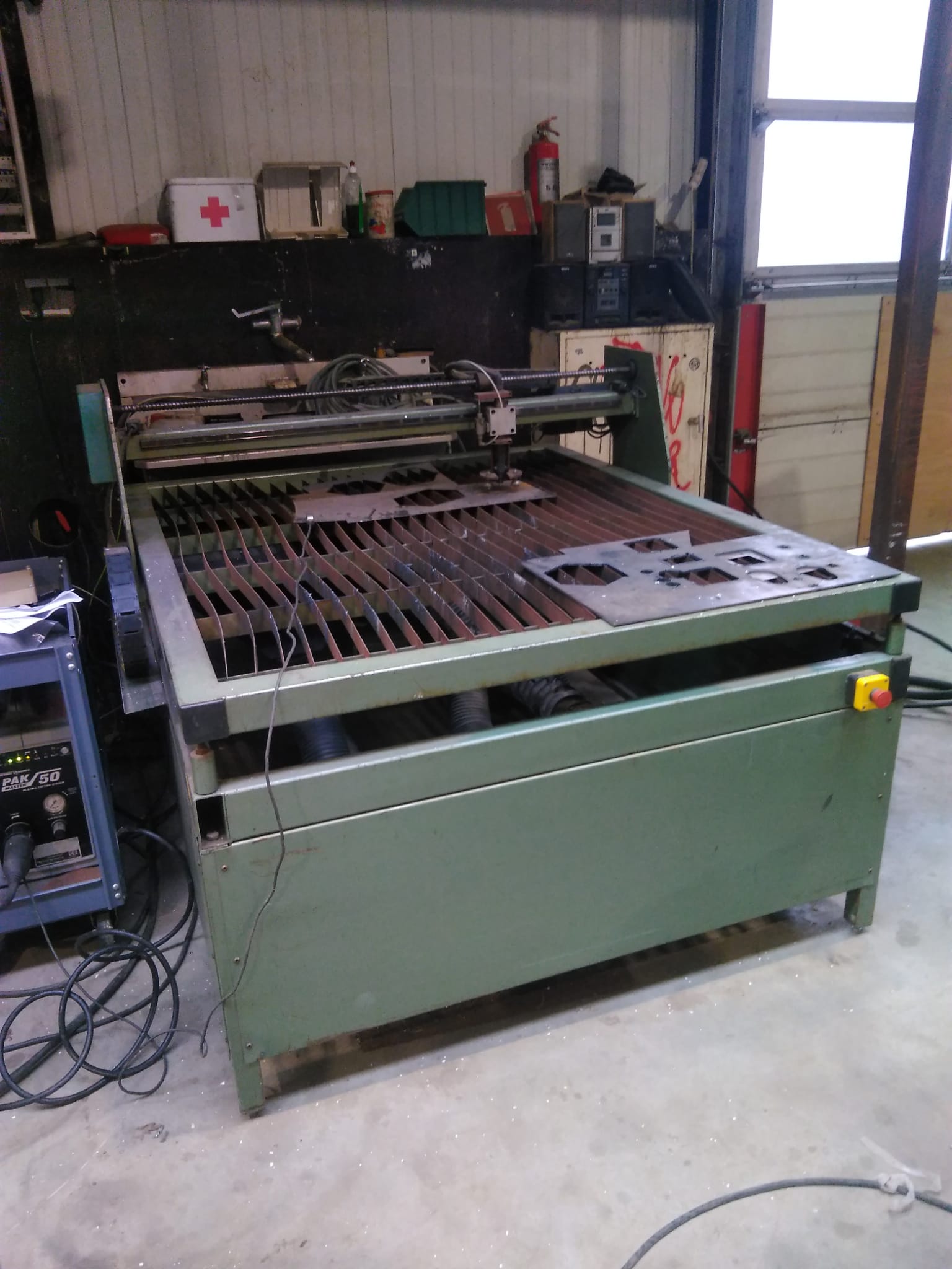

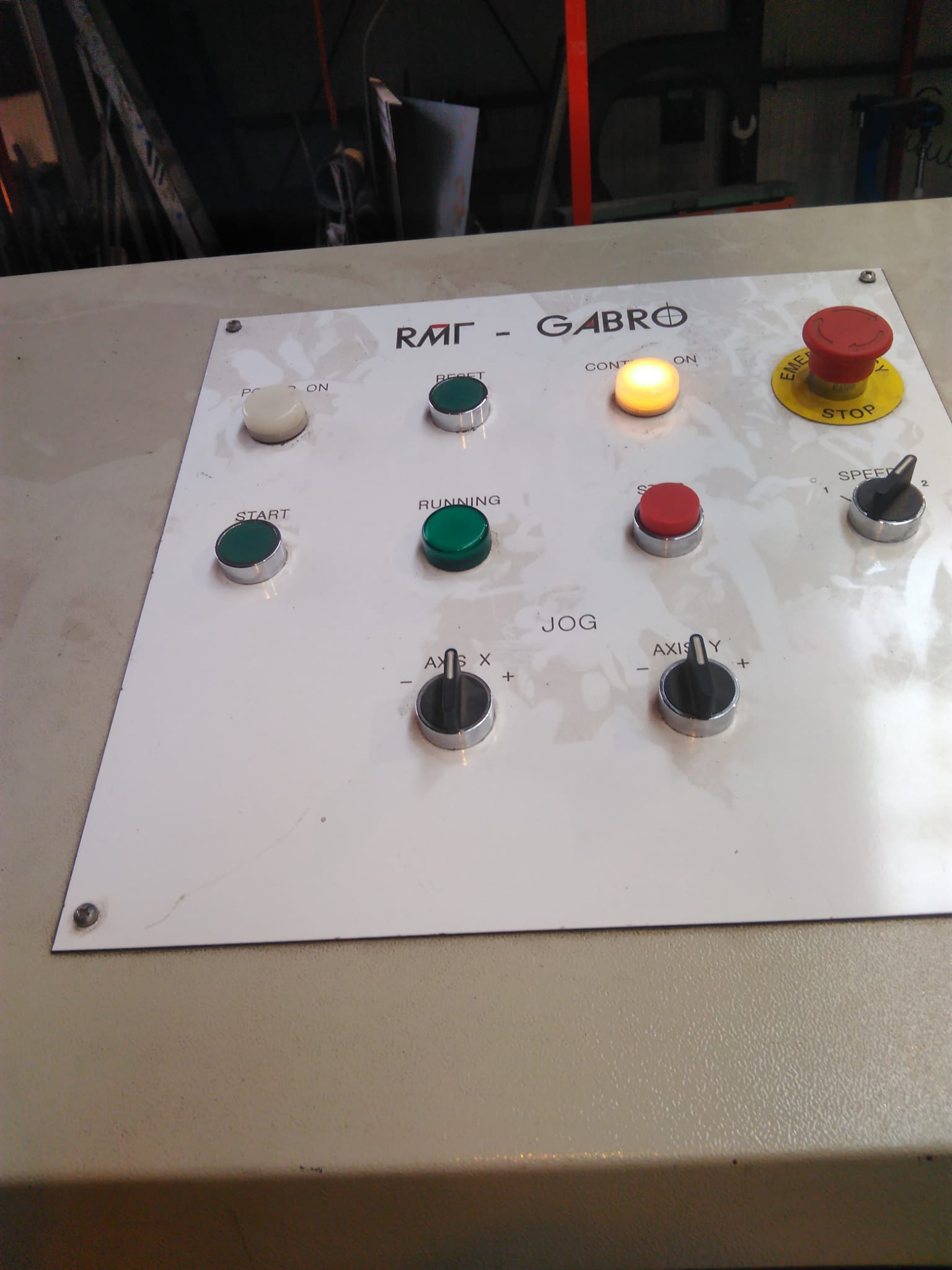

Hey
I'm working on an old plasma cnc machine. Quite an obscure piece. Its made by Rother Machine Tools ltd. and probably they didn't make many of them. It has a super low-tech torch height control: three ball bearings which roll over the surface of your sheet Its solenoid actuated with a air valve for the z-up movement.
I'm planning on fitting a real z-axis (with real THC) in the future but for now I want to get the machine working as it is. Originally it was fitted with a TRIO motion coordinator series 1, which I managed to get going. It was working with CADLINK 2000 software on a xp-machine and written in TRIO-BASIC language. Since I didn't really planned to learn cadlink2000 I decided to learn linuxcnc instead. Which is way better.

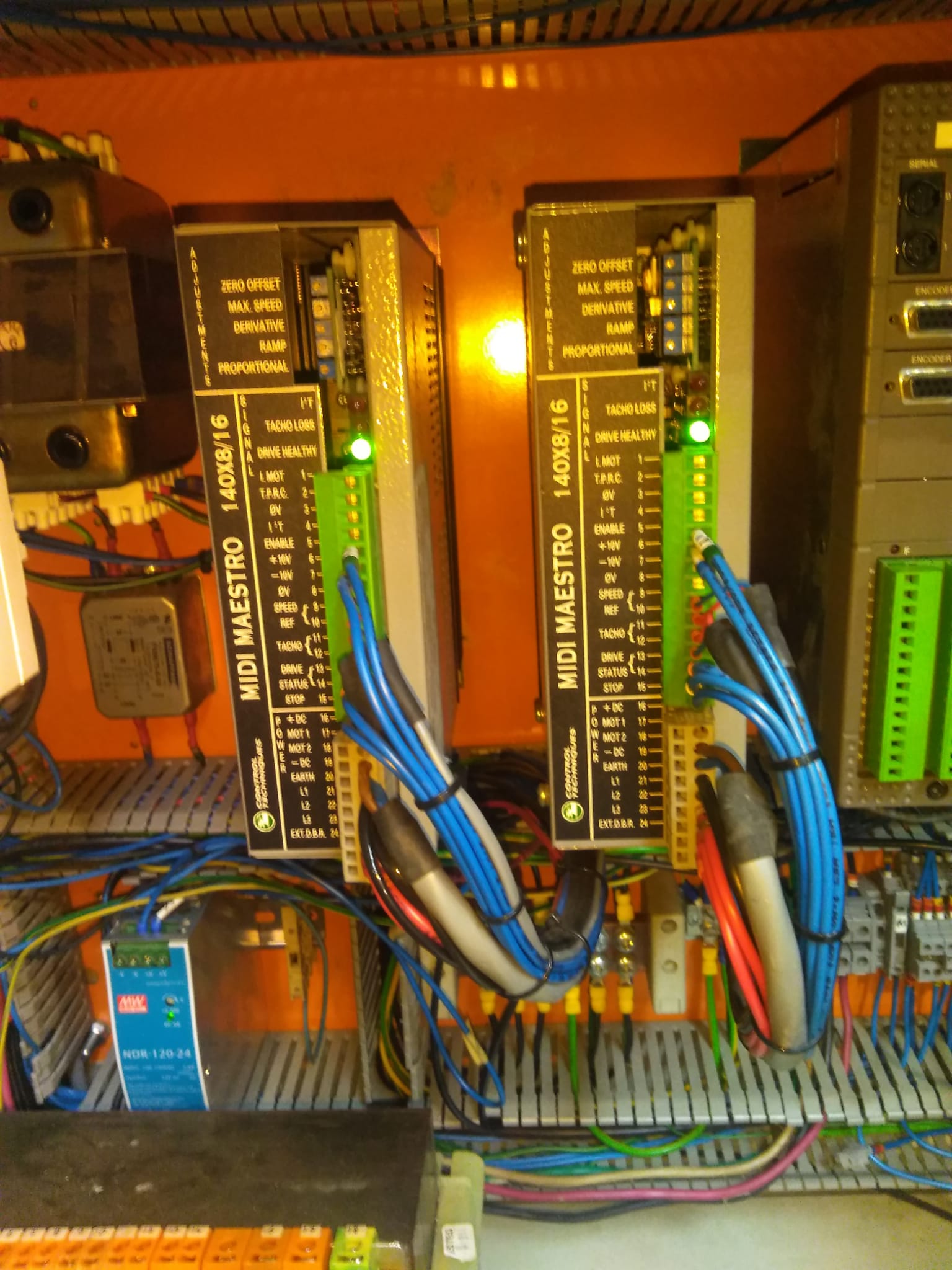

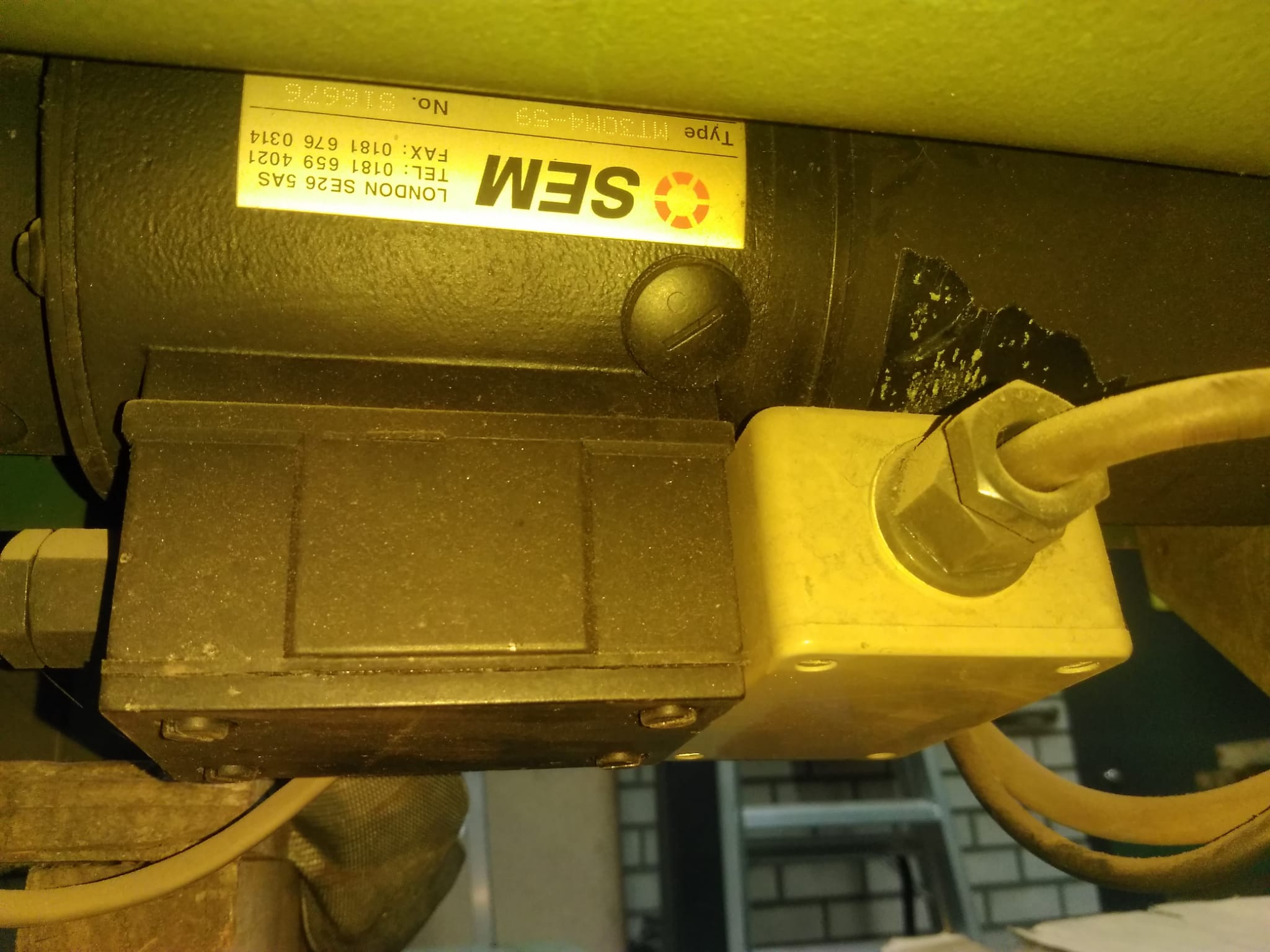

So my new basic setup is:
Qtplasmac
mesa 7i76e with 7i77 (bit overkill but decided to have a 7i76e as backup in case I couldn't get the servo to work).
2 midi-meastro 140x8/16 drives. These are analog dc servo drives with tach feedback and I believe internal PID-loop control.
2 SEM MT30M4-59 brushed DC motors fitted with 1000ppr British encoders.
I managed to get everything hooked up and haven't fried anything so I'm quite happy with where I am now.
I think the midi-meastro drives have a PID controller inside and since it was working before I figured it could be working with minimal PID settings in linuxcnc.
With a bit trial and error I got the motors not to walk away.
I've set P to 0.6 and FF1 to 0.3 and when I jog very slow there are no following errors. When I turn up jogging speed I get following errors.
So my question is what is a good starting point for the PID settings in linuxcnc? Do I need to tune the loop here as well? Or is the PID controller of the drive sufficient?
Another thing I've been trying to figure out is how to get the Z-axis to work with Qtplasmac in this setup.Since I'm planning on building a z-axis with stepper motor and THC control I've set-up the z-axis with pncconf on the 7i76e IO connector2 0:stepgen.
For the z-axis to move up I need to actuate a solenoid so I figured I could simply use the direction signal of the stepgen.
But I don't seem to understand where this pin is in the Halshow. I figured it should be hm2.7i76e.0.gpio.003 or 004.
But somehow this doesn't correspond with the z-axis movement. gpio pin 000 does go true when z-axis is moving down.
So how do I read the mesa 7i76e gpio pins? TB2 on the 7i76e starts with 1 GND. So I figured that should be gpio.000. And TB2 4 Dir0- should be gpio.003. I'm I missing something here?
I also have issues with some of the functionality in Qtplasmac. Since I don't have a float switch the program keeps on probing down until the max limit it reached. I did make a sort of workaround with a wcomp function as an input for the float switch. But it doesnt feel elegant at all.
So is there a example of some kind for a xy machine with just a up down movement for the z-axis? Like a pen plotter or something.
I attached a few photos of the machine and the manual for the midi-meastro drives
Thanks in advance,
Boele

I have the z-axis sort of working.
I made a wcomp function which takes joint.2.pos-fb as an input and output this to the plasmac.float-switch to simulate a float switch for plasmac.
Now the problem is that while probing it hits the (virtual) float switch and then backs off again to the cut/pierce height. Which makes my z-axis move up again and that is problematic for the arc to be ok.
Is there a way around the probing function?
thanks
thanks
