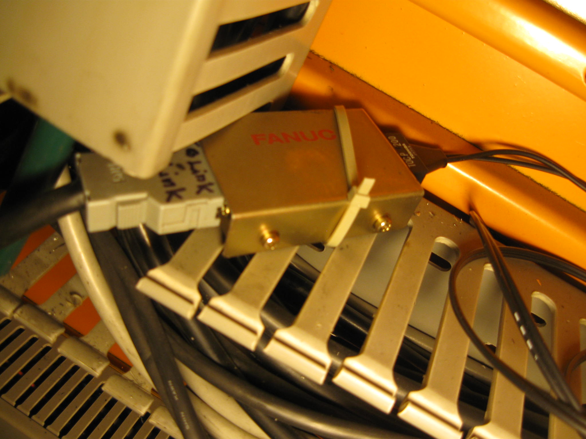

Replied by andypugh on topic How complex retro fit is a Fanuc O-M Alpha red cap controller to LinuxCNC
If the servo motor has UVW connectors then it is three-phase and probably a brushless motor, with commutation provided by the encoder.
Do you have the encoder part numbers?
The fibre-optic part would concern me, I don't think anyone has managed to reverse engineer that protocol for LinuxCNC yet.

20 Jan 2023 13:07 - 20 Jan 2023 13:09 #262517
by new2linux
Replied by new2linux on topic How complex retro fit is a Fanuc O-M Alpha red cap controller to LinuxCNC
andypugh, thanks. You don't care what encoder I have p/n for, I think the easy one is the belt driven spindle encoder, looks like a small enclosed electric motor. If this does not work, I will try to get inside one of the motors for the encoder info.
The fiber optic part (the wire tie is around it, the black wire looking to the right is the fiber part) pic is attached, if the electric cable the goes to this was longer, it would not be needed. What would I miss, as far as fetchers, if I did not worry about spindle position because of the optic part? The optic part label reads; Optical I/O Link, Type: A13B-0154-B001, No. N4284 1994 12; Fanuc.
Many thanks
Many thanks

The Parameter N0038 P 00001000 says you have a Full Keyboard.
Can you please check where the RS232 port cable is connected in CNC Connector (M5 or M74)
Accordingly we need to set the device and communication parameter.
Fanuc default protocol is 4800, E, 7, 2 ( Parameter 552/553=10)
To upload/download parameters from PC using data Punch IN or OUT
