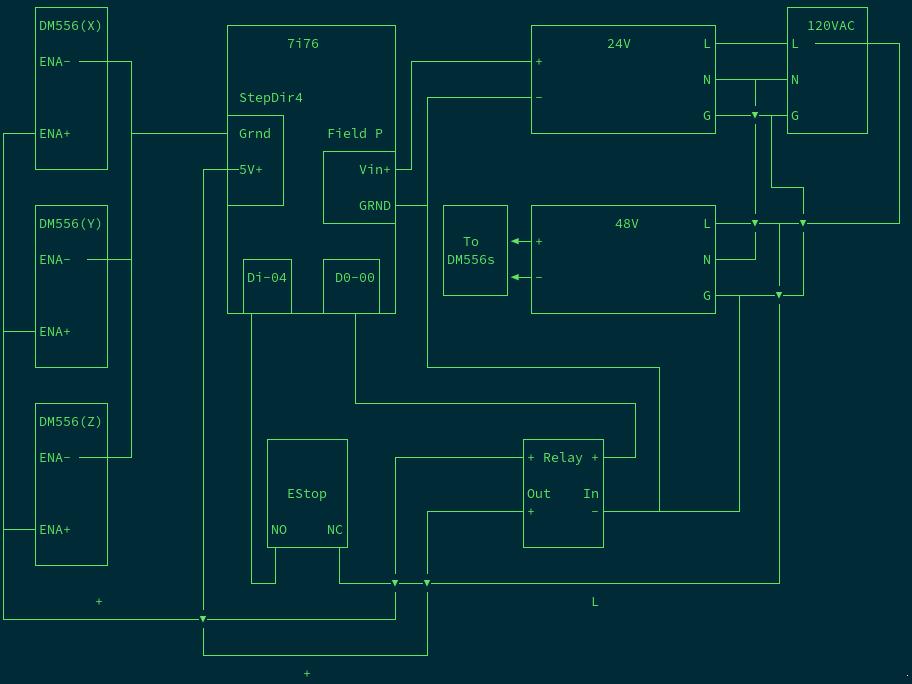

Posting to see if there's problems with this plan on how to wire up the E-stop, and also just from my own reference. This is based on what I've read on the forums and from the hardware I'm working with.Again any input is appreciated.Note: So far the DM556s have been great they're very smooth with tons of power.

Just making sure I am understanding your diagram. Are you tying in the DC ground from your relay to A/C Main ground?
if so don't. just return all of the DC- or Common back to the DC negative of your 24 volt power supply. The main reason being is
you want to avoid creating ground loops which introduces electrical noise into your controller (7i76). I would recommend
checking out this link for Wiring Best Practices
linuxcnc.org/docs/stable/html/integrator/wiring.html The wiring from the 48 volt power supply to the Stepper drives looks ok but I would recommend adding fuses in line .
