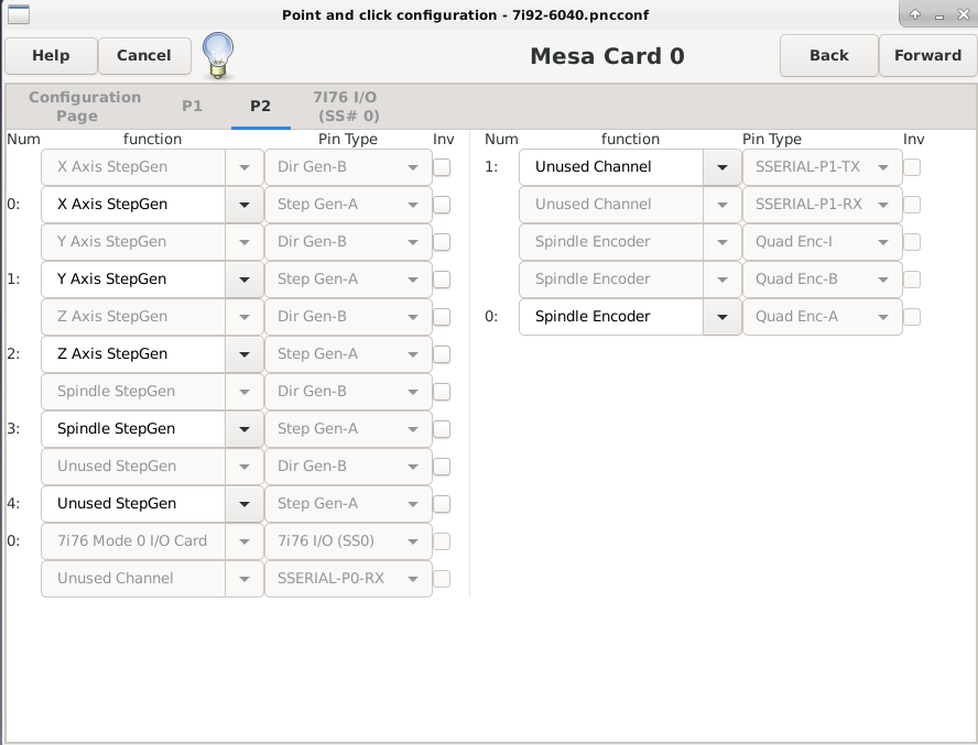

P2 Pin3 is set to spindle stepgen with spindle encoder on Num 0

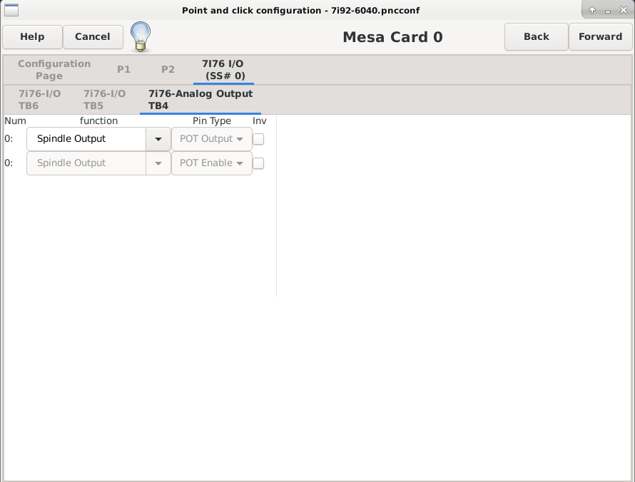

TB4 is set to spindle output
everything else is default

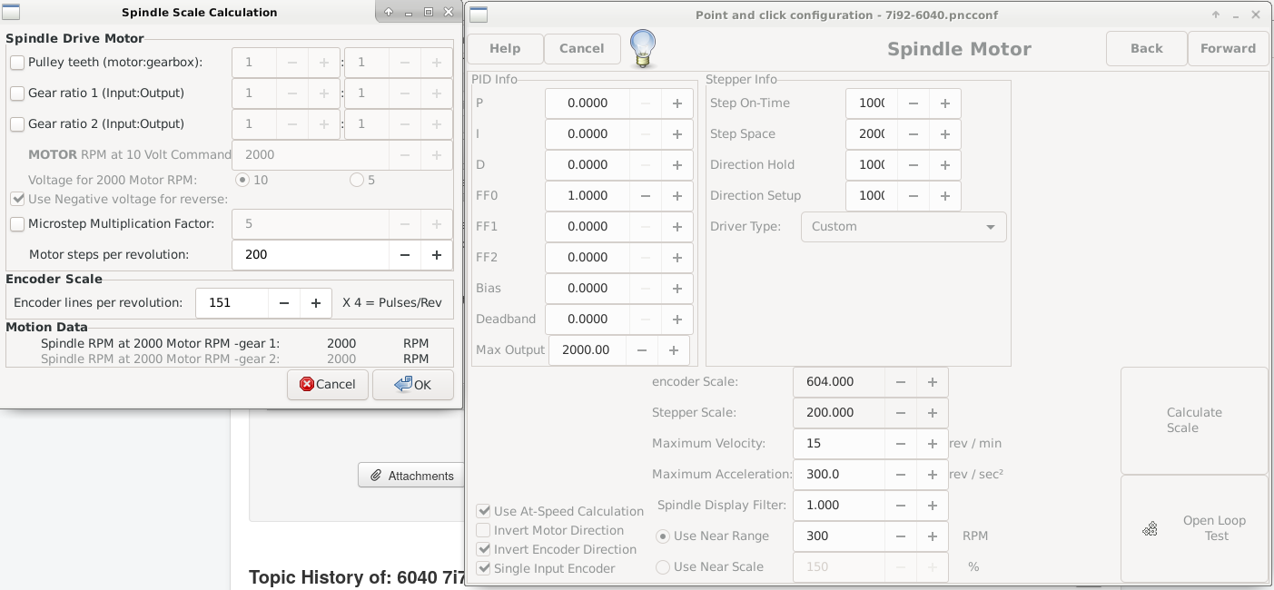

Are TB4 SPIN-,SPIN+,and SPINOUT connected as I suggested?
Is your spindle scale set properly in LinuxCNCs ini file?

I connected them and it works it can start and stop the spindle. But I'm not sure the scale is set correctly because there's no way to change the spindle speed, it just speeds up to max once started.
- Posts: 18096
- Thank you received: 5326
06 Aug 2023 19:09 #277136
Replied by PCW on topic 6040 7i76 Conversion
You should set the spindle scale to the full scale RPM (the RPM at 5V)
This is typically done when you run the configuration utility
but you can change it later by editing the .ini file (in the [SPINDLE] section)
or using the calibration popup

It may be the you have not set up the spindle properly in the configuration
utility, that is, why is there any stepgen related setup in the spindle section?
Posting the hal file would help
Also Spindle PID FF1 and FF2 should be 0

in term sof the config I used step conf
screenshot of it

net spindle-output => hm2_7i92.0.7i76.0.0.spinout
net spindle-enable => hm2_7i92.0.7i76.0.0.spinena
net spindle-ccw => hm2_7i92.0.7i76.0.0.spindir
# Step Gen signals/setup
setp hm2_7i92.0.stepgen.03.dirsetup [SPINDLE_0]DIRSETUP
setp hm2_7i92.0.stepgen.03.dirhold [SPINDLE_0]DIRHOLD
setp hm2_7i92.0.stepgen.03.steplen [SPINDLE_0]STEPLEN
setp hm2_7i92.0.stepgen.03.stepspace [SPINDLE_0]STEPSPACE
setp hm2_7i92.0.stepgen.03.position-scale [SPINDLE_0]STEP_SCALE
setp hm2_7i92.0.stepgen.03.step_type 0
setp hm2_7i92.0.stepgen.03.control-type 1
setp hm2_7i92.0.stepgen.03.maxaccel [SPINDLE_0]STEPGEN_MAXACCEL
setp hm2_7i92.0.stepgen.03.maxvel [SPINDLE_0]STEPGEN_MAXVEL
net spindle-enable => hm2_7i92.0.stepgen.03.enable
net spindle-vel-cmd-rps => hm2_7i92.0.stepgen.03.velocity-cmd
# ---Encoder feedback signals/setup---
setp hm2_7i92.0.encoder.00.counter-mode 1
setp hm2_7i92.0.encoder.00.filter 1
setp hm2_7i92.0.encoder.00.index-invert 0
setp hm2_7i92.0.encoder.00.index-mask 0
setp hm2_7i92.0.encoder.00.index-mask-invert 0
setp hm2_7i92.0.encoder.00.scale [SPINDLE_0]ENCODER_SCALE
net spindle-revs <= hm2_7i92.0.encoder.00.position
net spindle-vel-fb-rps <= hm2_7i92.0.encoder.00.velocity
net spindle-vel-fb-rpm <= hm2_7i92.0.encoder.00.velocity-rpm
net spindle-index-enable <=> hm2_7i92.0.encoder.00.index-enable
net spindle-vel-cmd-rps <= spindle.0.speed-out-rps
net spindle-vel-cmd-rps-abs <= spindle.0.speed-out-rps-abs
net spindle-vel-cmd-rpm <= spindle.0.speed-out
net spindle-vel-cmd-rpm-abs <= spindle.0.speed-out-abs
net spindle-enable <= spindle.0.on
net spindle-cw <= spindle.0.forward
net spindle-ccw <= spindle.0.reverse
net spindle-brake <= spindle.0.brake
net spindle-revs => spindle.0.revs
net spindle-at-speed => spindle.0.at-speed
net spindle-vel-fb-rps => spindle.0.speed-in
net spindle-index-enable <=> spindle.0.index-enable
net spindle-vel-cmd-rps => near.0.in1
net spindle-vel-fb-rps => near.0.in2
net spindle-at-speed <= near.0.out
setp near.0.scale 1.000000
setp near.0.difference 5.000000

# SPINDLE
setp pid.s.Pgain [SPINDLE_0]P
setp pid.s.Igain [SPINDLE_0]I
setp pid.s.Dgain [SPINDLE_0]D
setp pid.s.bias [SPINDLE_0]BIAS
setp pid.s.FF0 [SPINDLE_0]FF0
setp pid.s.FF1 [SPINDLE_0]FF1
setp pid.s.FF2 [SPINDLE_0]FF2
setp pid.s.deadband [SPINDLE_0]DEADBAND
setp pid.s.maxoutput [SPINDLE_0]MAX_OUTPUT
setp pid.s.error-previous-target true
# This setting is to limit bogus stepgen
# velocity corrections caused by position
# feedback sample time jitter.
setp pid.s.maxerror 0.012700
net spindle-index-enable => pid.s.index-enable
net spindle-enable => pid.s.enable
net spindle-vel-cmd-rpm => pid.s.command
net spindle-vel-fb-rpm => pid.s.feedback
net spindle-output <= pid.s.output
# ---digital potentiometer output signals/setup---
setp hm2_7i92.0.7i76.0.0.spinout-minlim [SPINDLE_0]OUTPUT_MIN_LIMIT
setp hm2_7i92.0.7i76.0.0.spinout-maxlim [SPINDLE_0]OUTPUT_MAX_LIMIT
setp hm2_7i92.0.7i76.0.0.spinout-scalemax [SPINDLE_0]OUTPUT_SCALE
screenshot of it
- Posts: 18096
06 Aug 2023 20:35 - 06 Aug 2023 20:36 #277160
That's pncconf, not stepconf
You must have selected a spindle stepgen on the "Mesa Card 0" page
though looking at the hal file, I don't think it's harmful (other than wasting a stepgen)
Did you set FF1 and FF2 back to 0?
You may have a connection issue, which I would debug by reading the actual
input voltage at the VFD (from VFD 5VIN to VFD GND)

And here's a couple screen shots on the pins I set up for the spindle in the conf config. So far this is all Ive configured.
But the voltage between the VFD ground and VFD 5Vin is 3.98v
Yes, they're both set back to zero
