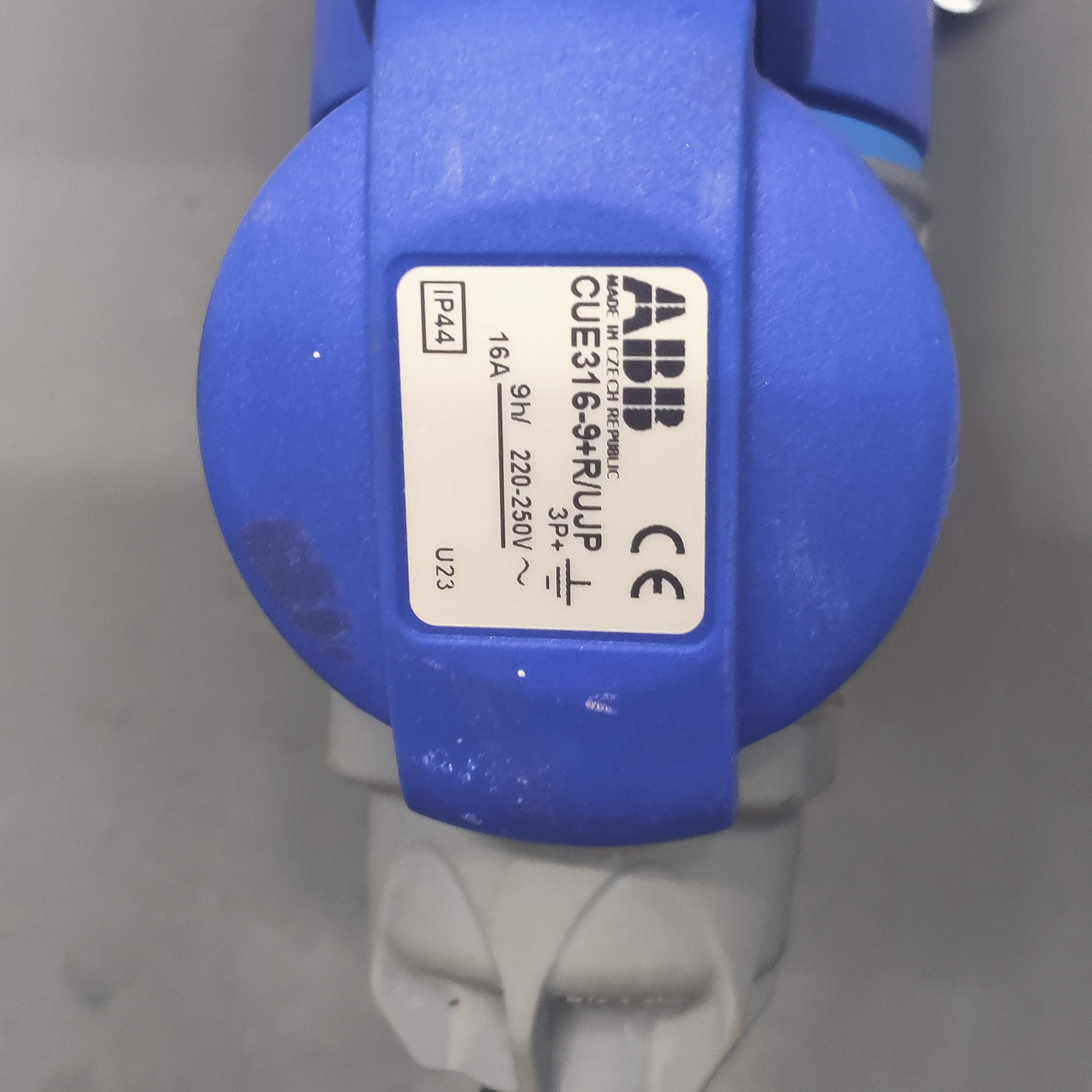

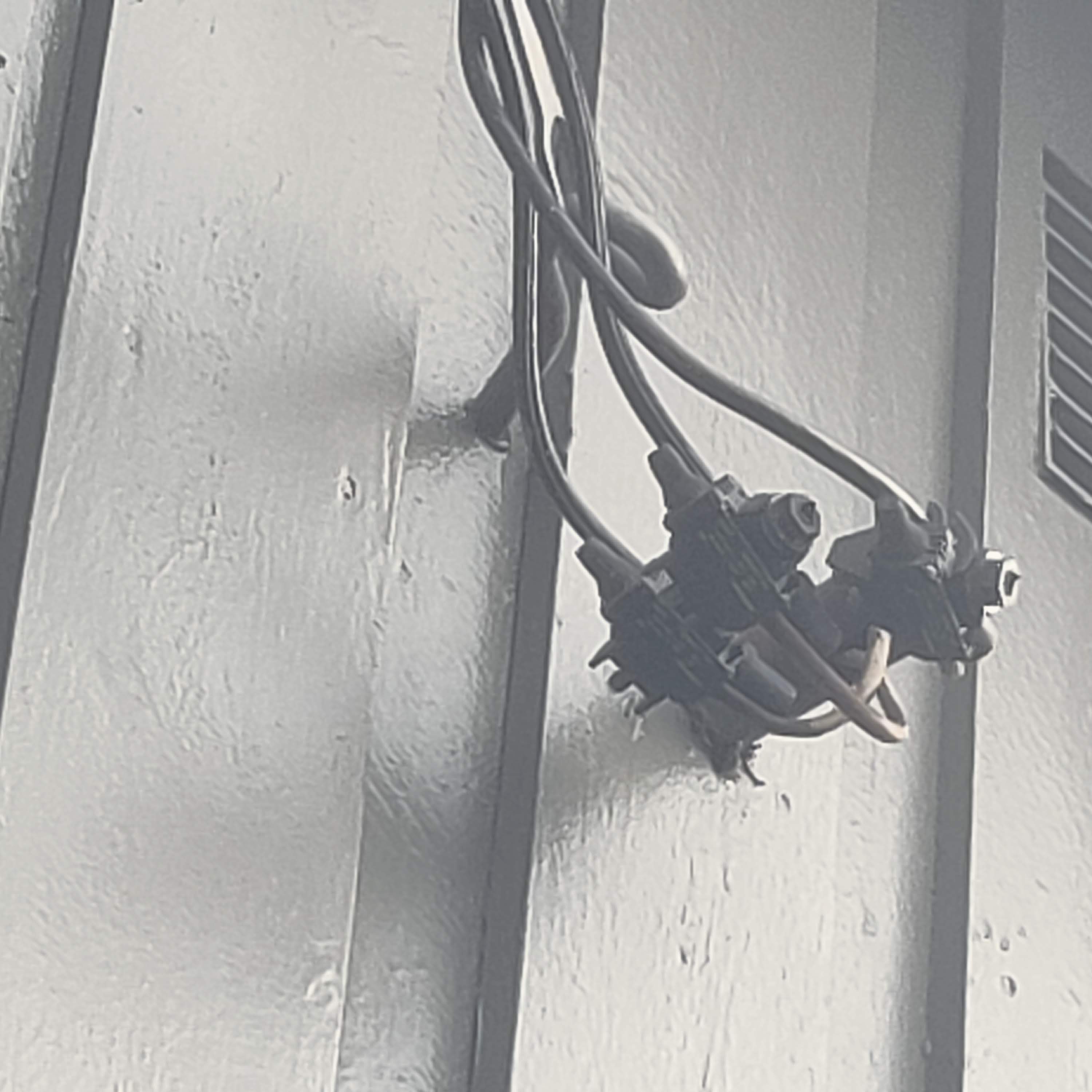

It kinda threw me for a loop when i first moved here from Sweden. It never crossed my mind that there were different ways of delivering household electricity. I get three phases from the supplier in to my house. In addition there is a PE pole staked in to the ground outside, and a PE cable that run in the my distrubution box. On older houses it is common to still the the PE line connected to the copper water pipe.

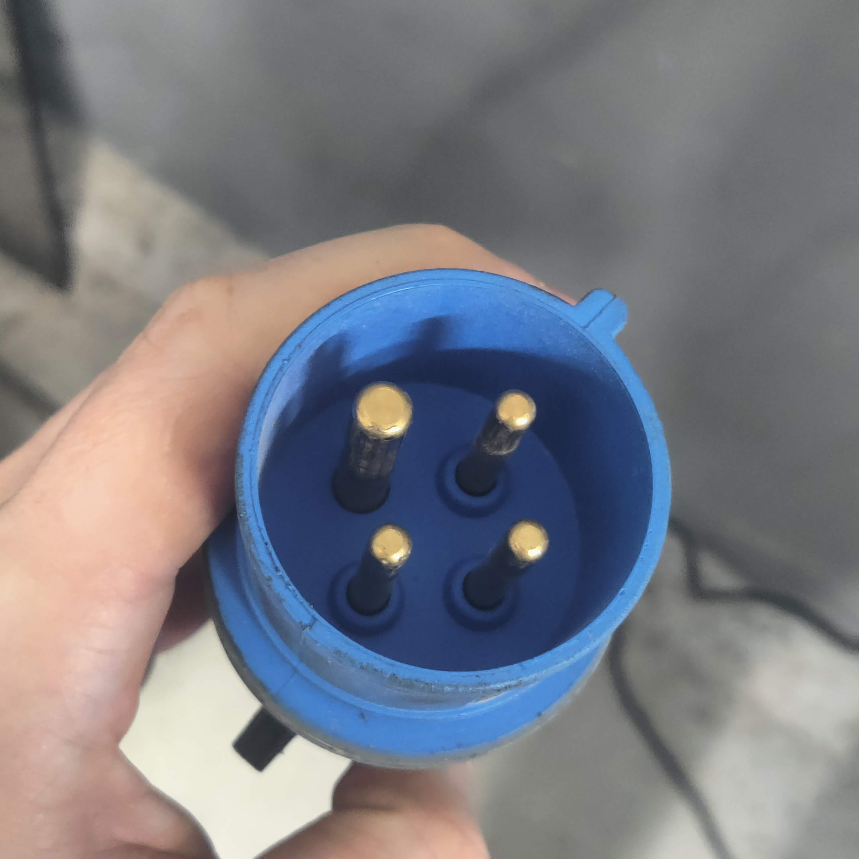

Just to add to the confusion, here are some more pictures.
Wires coming in to my house. 3 phase, no neutral.
Installation certificate in my distribution box:
A 3phase connector:
A 3phase connector:

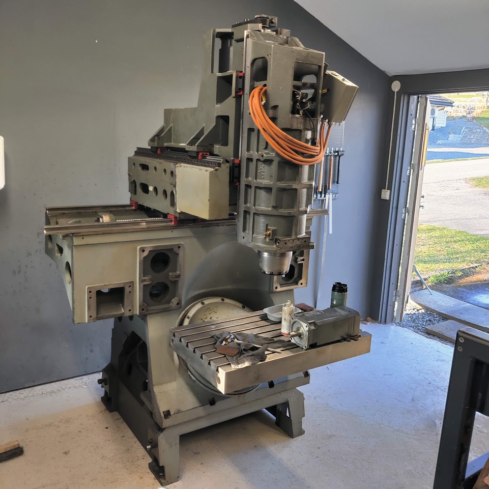

The elbow grease is paying out. starting to look less and less like a rust pile
I also remounted the Y + Z axis that I had to take of to fit it through the garage doors.

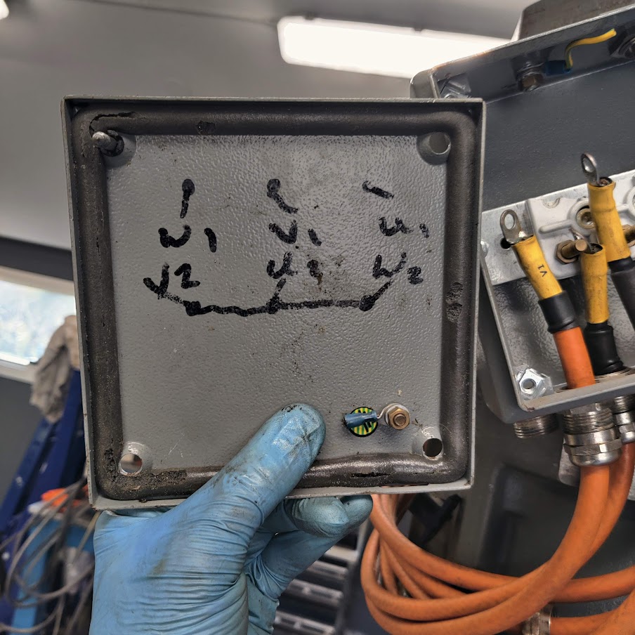

I found this drawing on the backside of the lid for the junction box for the spindle.
If im not mistaken is diagram show a Y(Star) connection. It leads me to believe that the nameplate previously posted here checks out
Is there any risk to the spindle if connect up a 220V VFD configured as delta? Would be nice to see it spin
I need to make up my mind if I should pursue to get the original spindle running (buying a VFD and try to get a 32 A line drawn in).
I also have the possibility to use a big transformer to get the line voltage up to 380. Although it would perhaps be more VFDs to choose from, they are quite expensive. Any tips/thoughts/ideas are very much appreciated.

Running it on 220V-delta shouldn't hurt it since the voltage across the individual windings would actually be lower than when wired as 400V-Y (which is _probably_ what is was wired to before judging from the scribbles on the connector box).
My guess is that 32A might not be quite enough though.
