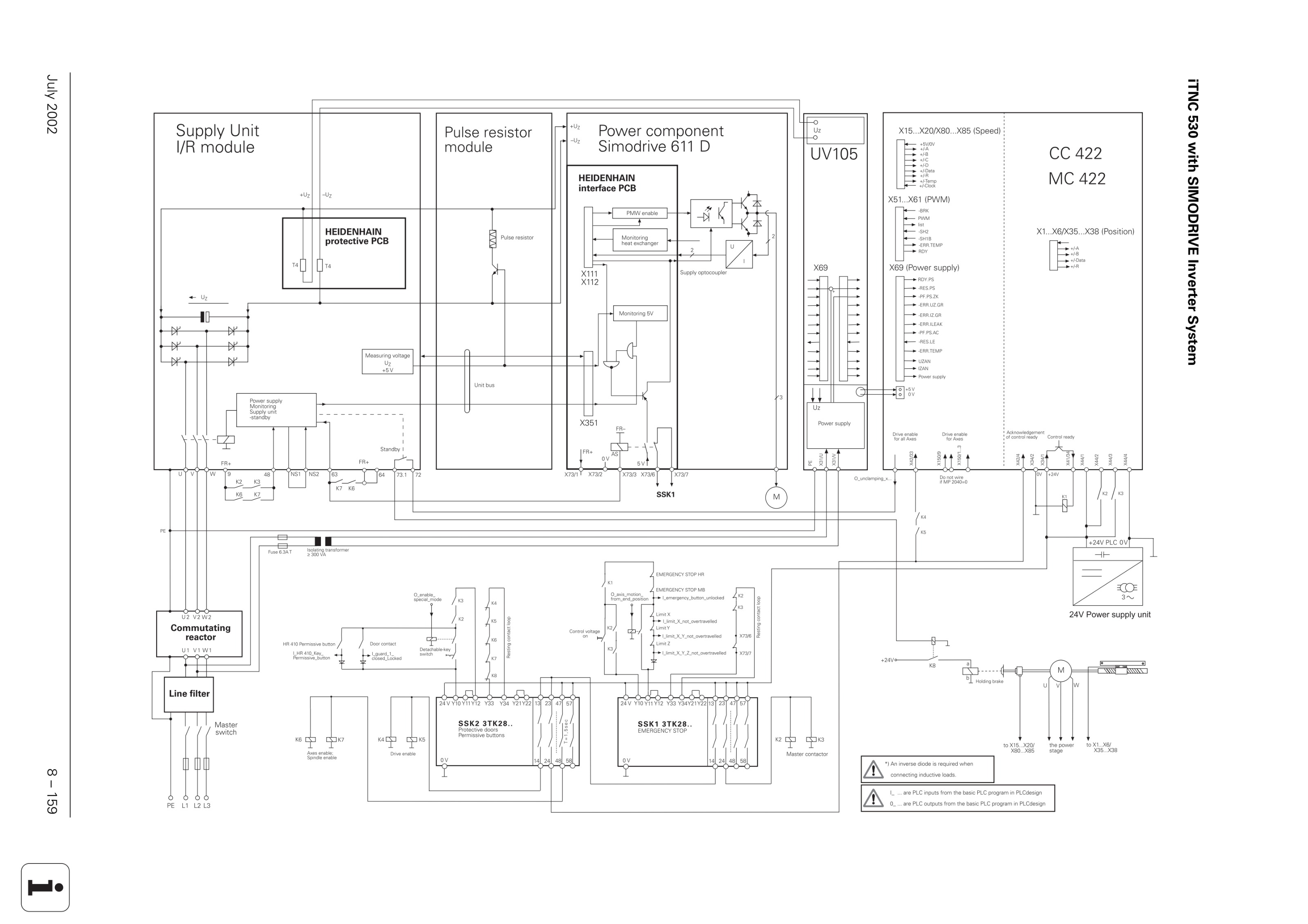

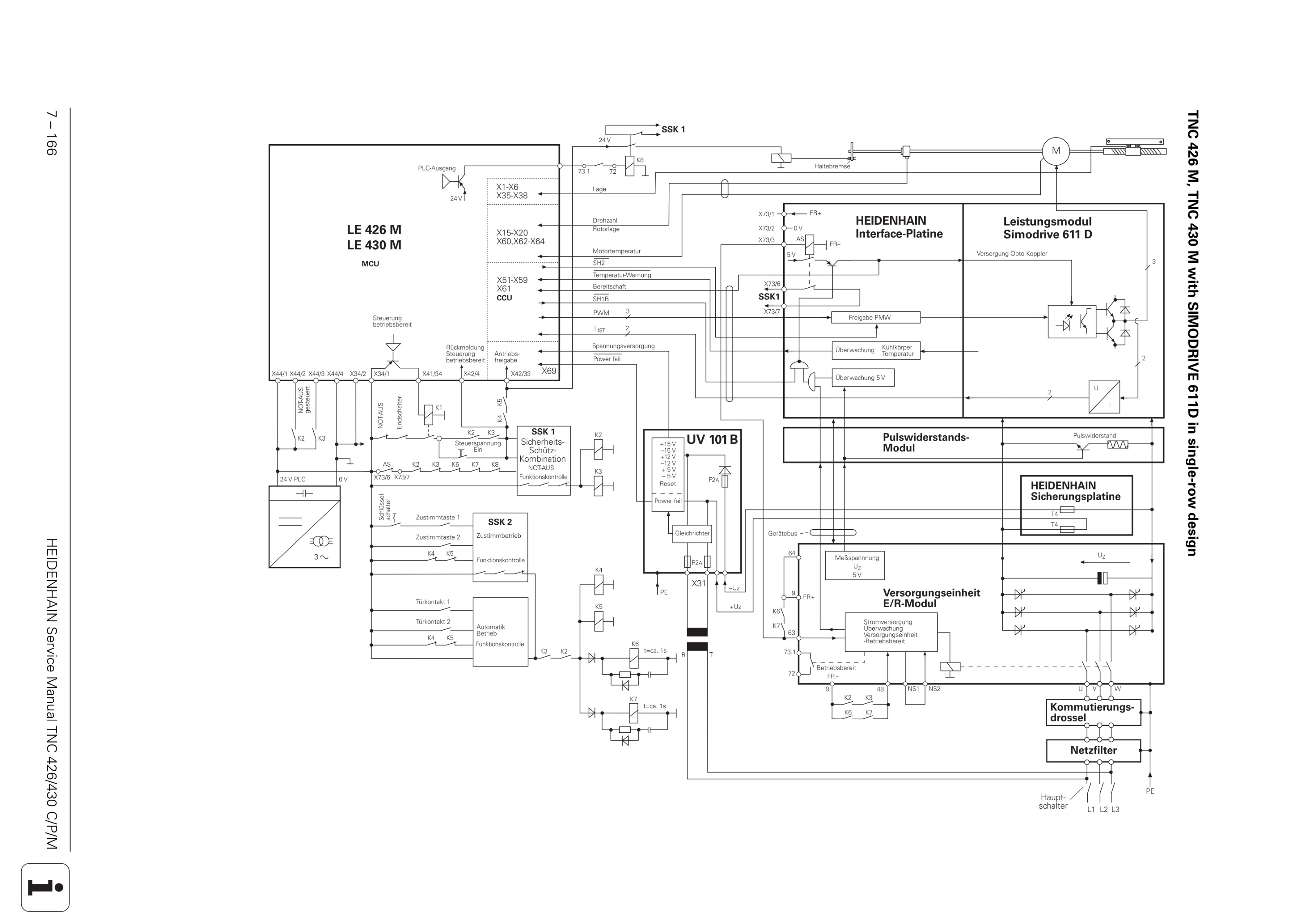

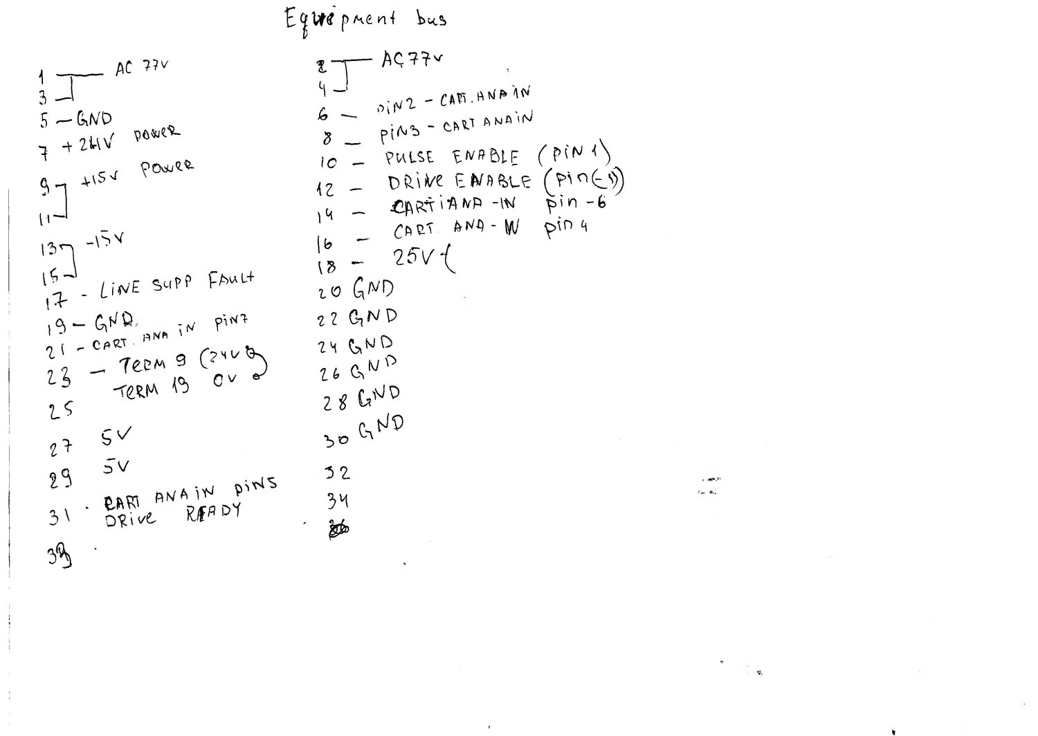

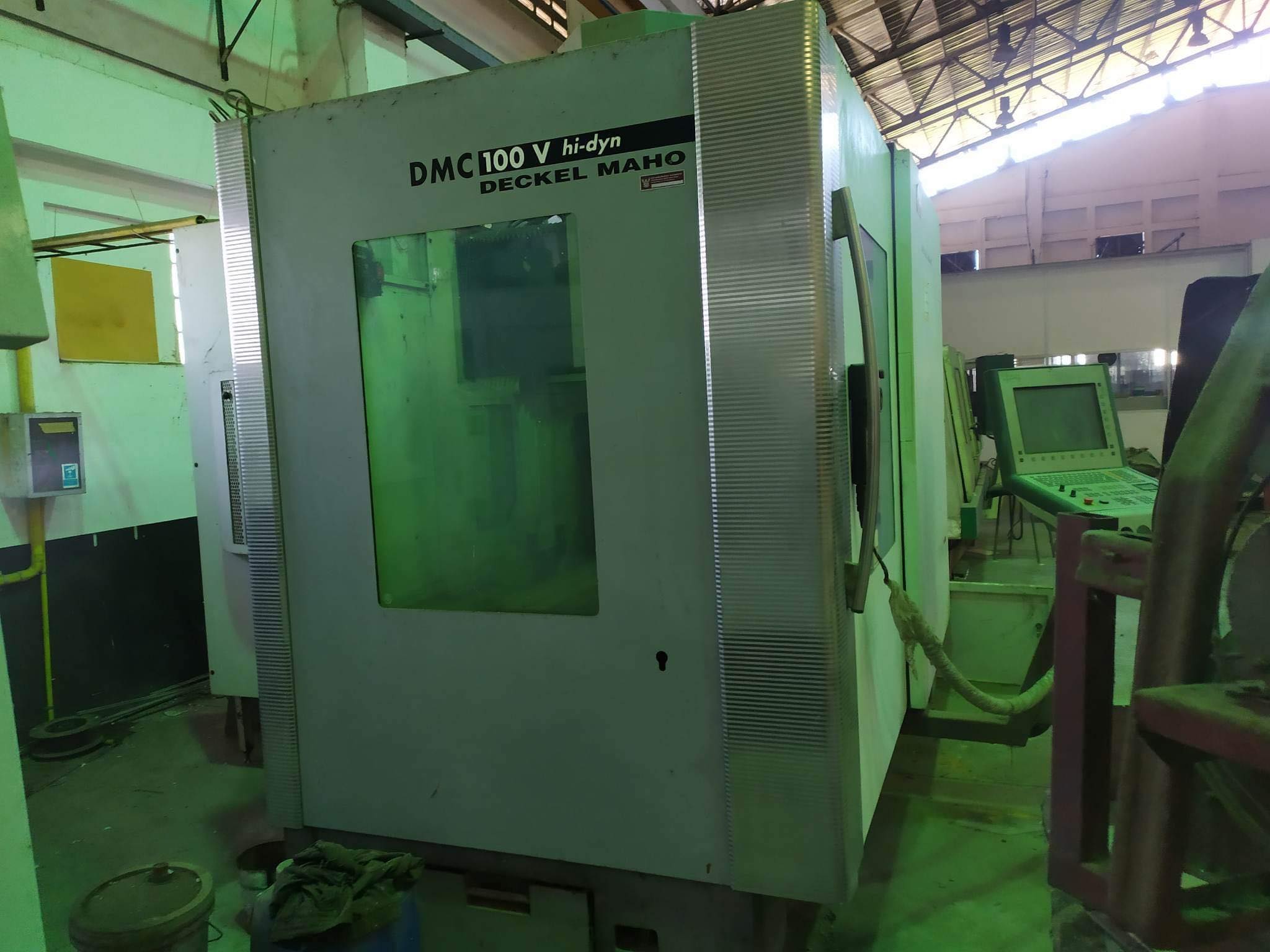

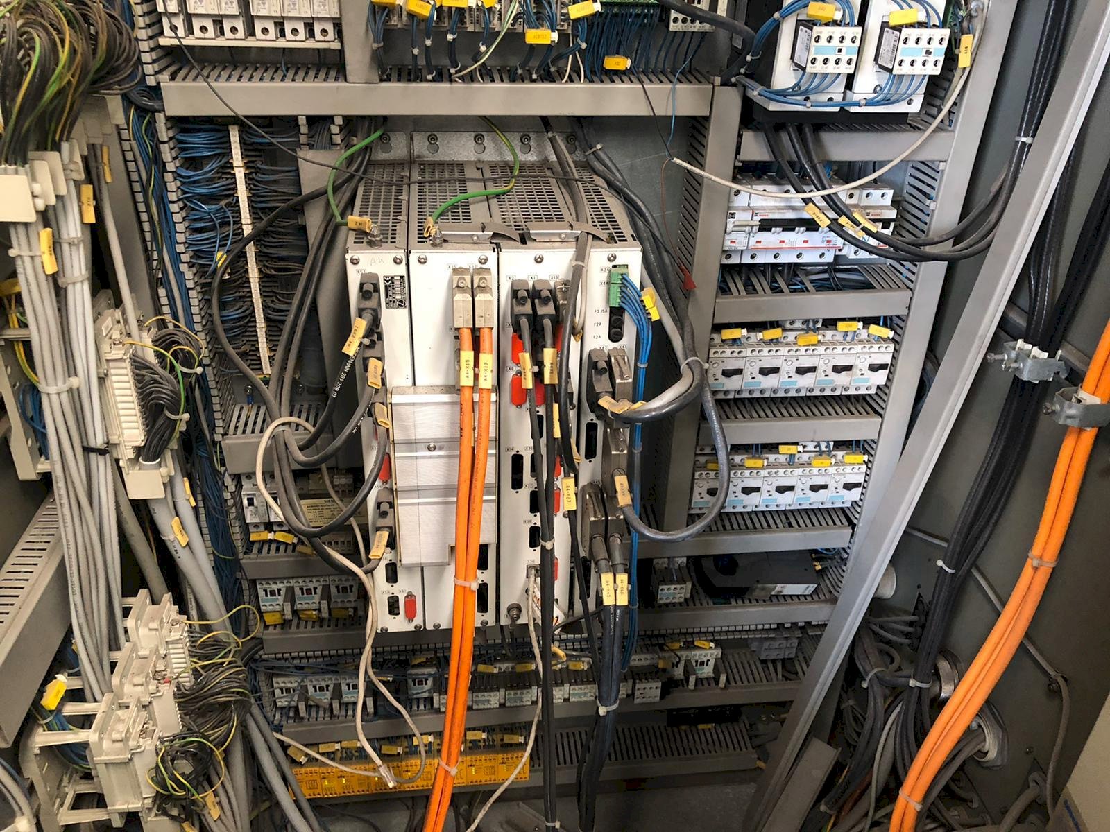

I'm planning a retrofit. It has the original controller iTNC 530 with SIMODRIVE611.
iTNC 530 it sends 3PWM to SIMODRIVE611 at X111 and X112
I checked the document and it looked like 2 things. Wring diagram
I am interested in using
1.SoftDMC What Mesa cards does this support? I have a 7i95t, 7i96s, 7i92. If it works where can I find the firmware?
2.3ppwmgen Will this work with 7i96S?
Which of the two is possible or is there a way to do it? (I understand that you need to use a feedback encoder.)

06 Nov 2023 15:23 #284709 by andypugh
Replied by andypugh on topic Decke Maho DMC100V Possibility of retrofitting
Why SoftDMC? It's not really supported by LinuxCNC (in fact I think it takes the place of LinuxCNC).
I would suggest discussing with Mesa whether LinuxCNC or softDMC better fit your needs.
I think that it is probably possible to run tppwmgen on a 7i96s by re-purposing step and did outputs as PWM channels.
But: the 7i96 only has 10 high-speed step/dir output lines, which might not be enough if the drives need all six channels to be driven.

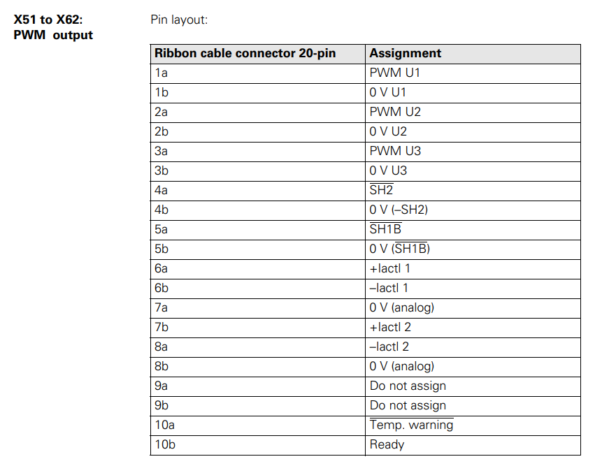

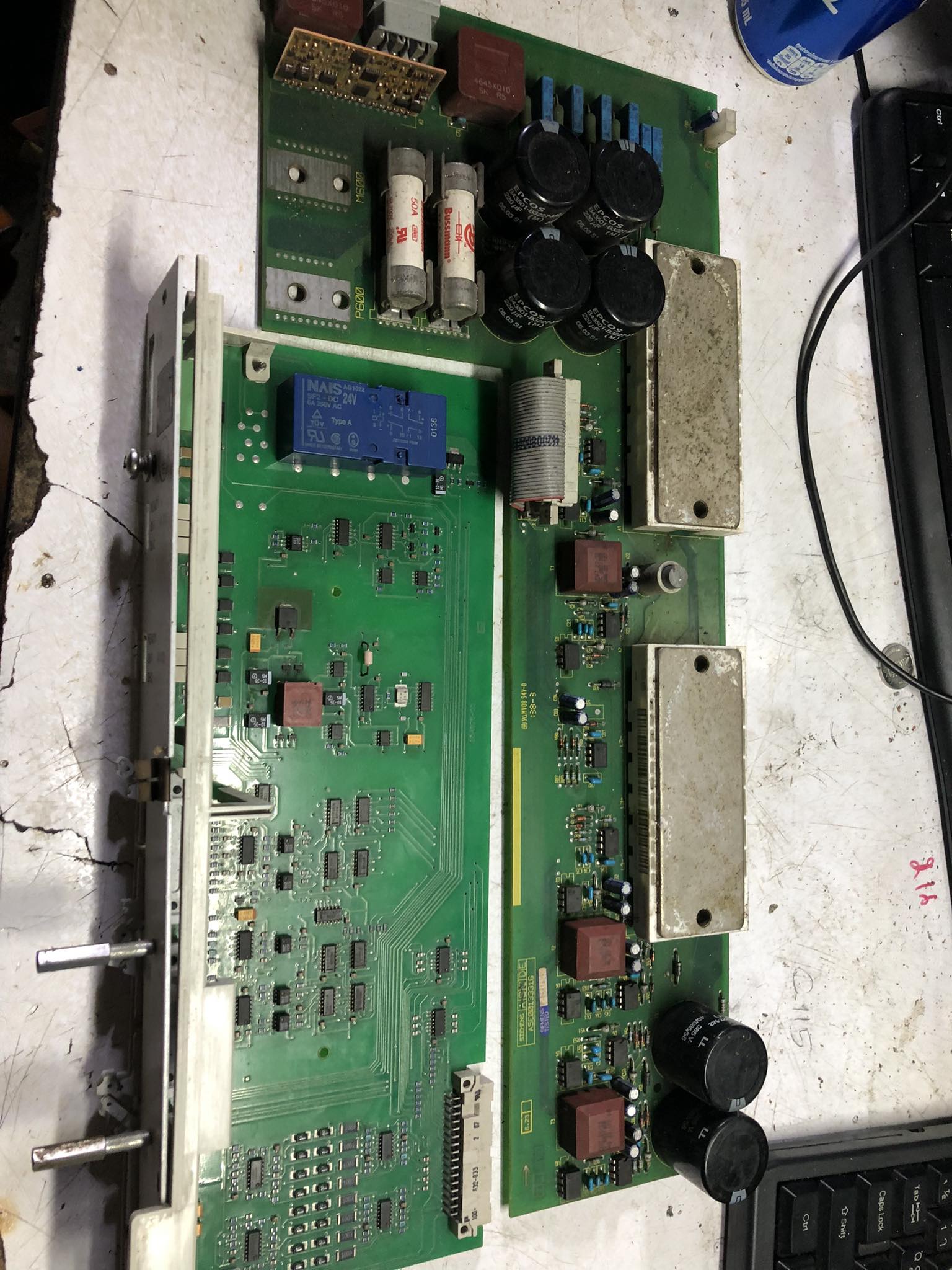

06 Nov 2023 18:06 #284724 by PCW
I suspect the issue to getting those drives to work is that the controller was probably
providing the torque ( current ) control loop. That is, there appears to be analog current
feedback from the drive. This is similar to Fanuc drives of the same vintage. At one time I had
started the design of a interface board for the Fanuc drive but never finished it.
It had the drivers for the differential  PWM the Fanuc uses and the 2 channels of A-D
for the current feedback.
I suspect its easier to just replace the drives/motors, unless you want to deep-dive
in to a fairly complex project.

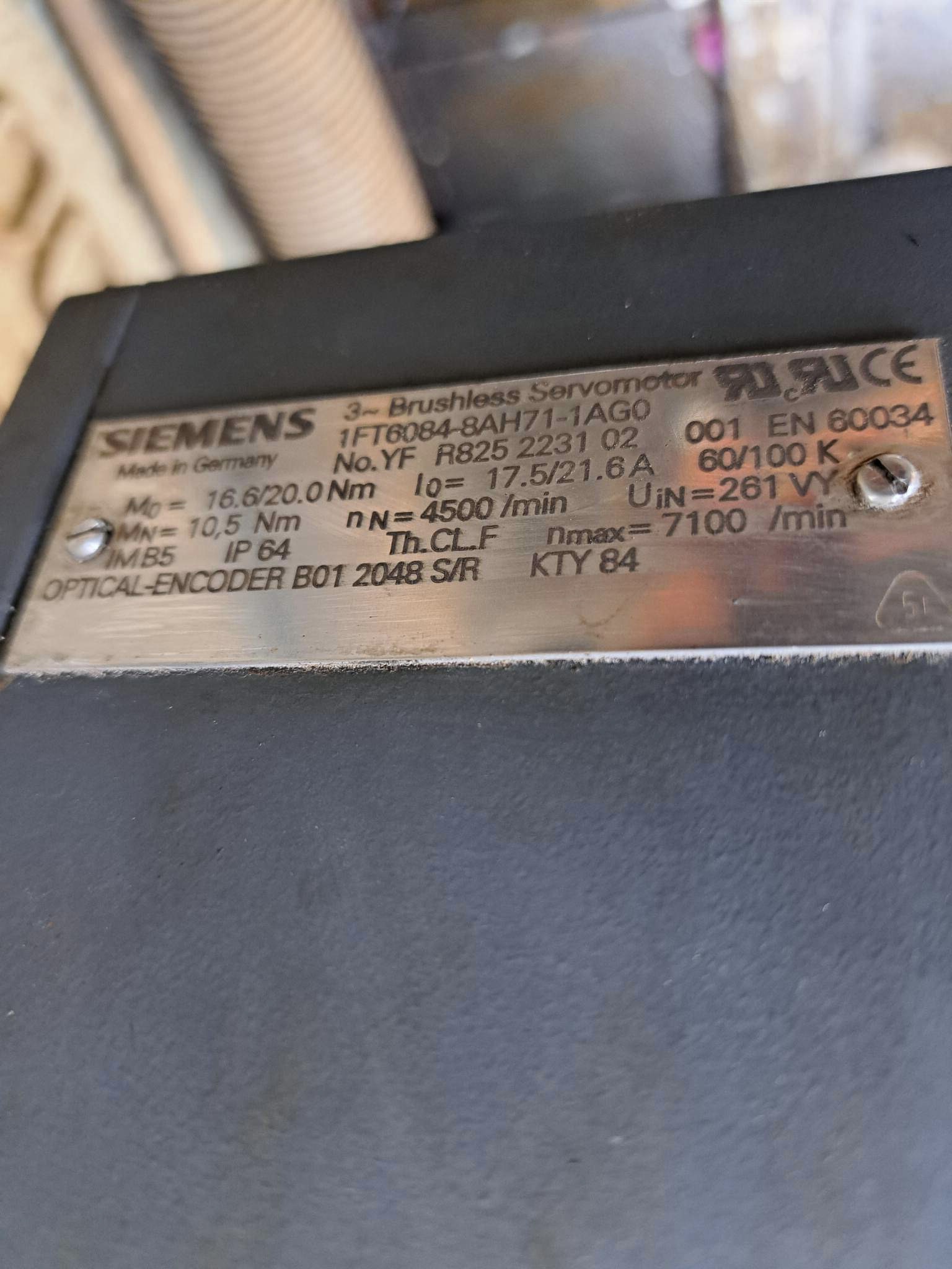

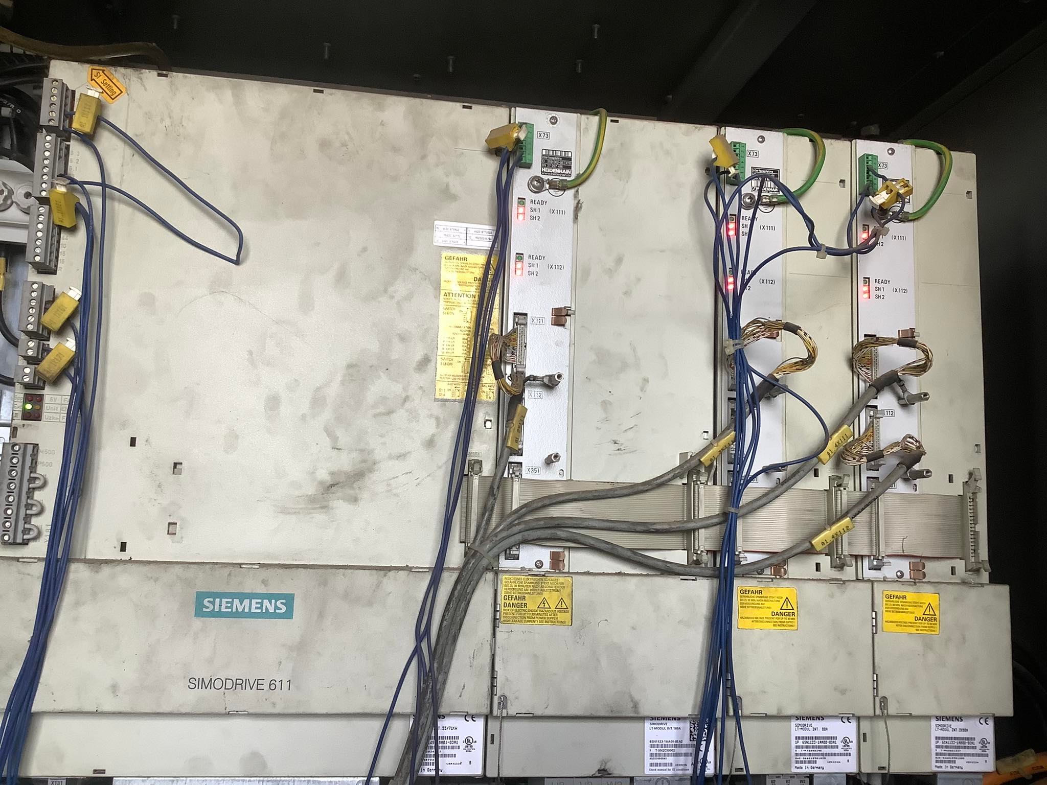

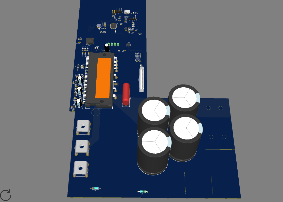

Replacing the motor may be a last resort as it is large and very expensive.

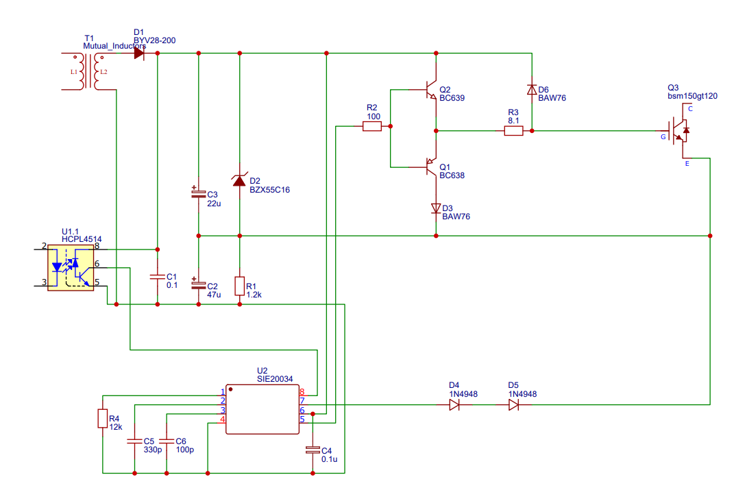

I took out the SIMODRIVE611 piece. Found the IGBT part. It doesn't look very complicated. So the idea was to test it out before replacing it.
I used to do STMBL. and it may be adapted for use. But there is a problem with IPM 1200v
So I want to experiment with 3ppwmgen. Hope you support the 7i95t firmware again like you did in the past. 7i95t_5abobd

07 Nov 2023 21:33 #284825 by PCW
I can make tpwmgen firmware for the 7I95T when I get a chance
Note that without an A-D and current control Operation would not be ideal
A better solution would be something like STMBL but just the control part
The following user(s) said Thank You: SOLD
10 Nov 2023 10:32 #285018 by SOLD
I've been doing STMBL for a while now.
I searched for an IPM 600V using the FNA25012A, but I was sent non-ordered products twice by Chinese sellers, so I thought this product was no longer available. So I haven't continued with it yet.
Anyway, I still want to test it. 3PWM Run in V/F mode for the spindle. Because I can't find a large IPM.
