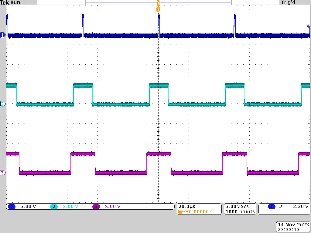

I configured it to be a spindle so I don't want to use Encoder feedback in testing Because the machine is not ready to turn on yet.
I want to view the signal from TB1-20,21 TB1-22,23 TB2-2,3 through measurement with an external oscilloscope. It's not successful yet.
Is there something wrong with Hal that I should fix?
Last edit: 13 Nov 2023 16:03 by SOLD.

I customized Hal. to the spindle No motor feedback
loadrt bldc cfg=n,6
# ---PWM Generator signals/setup---
#setp [HMOT](CARD0).pwmgen.00.output-type 1
#setp [HMOT](CARD0).pwmgen.00.scale [SPINDLE_0]OUTPUT_SCALE
#net spindle-vel-cmd-rpm => [HMOT](CARD0).pwmgen.00.value
#net spindle-enable => [HMOT](CARD0).pwmgen.00.enable
# ---TPPWM Generator signals/setup---
setp [HMOT](CARD0).3pwmgen.00.enable true
setp [HMOT](CARD0).3pwmgen.00.scale 50
setp [HMOT](CARD0).3pwmgen.00.deadtime 1000
setp [HMOT](CARD0).3pwmgen.00.fault-invert 1
net pwm.00-a bldc.0.A-value => [HMOT](CARD0).3pwmgen.00.A-value
net pwm.00-b bldc.0.B-value => [HMOT](CARD0).3pwmgen.00.B-value
net pwm.00-c bldc.0.C-value => [HMOT](CARD0).3pwmgen.00.C-value
setp bldc.0.value 0.5
#setp bldc.0.init true
#setp bldc.0.encoder-offset 0
#setp bldc.0.initvalue 5
setp bldc.0.rev 1
#setp bldc.0.lead-angle 0
#setp bldc.0.poles 4
#setp bldc.0.scale 10000
It has a signal. But like an abnormality 3pwmgen.00.A-value (TB1-20,21) It does not respond to speed adjustment like B and C.
Is this correct?
How to test with No motor feedback. Is it possible?
How can I check the correct settings?

Replied by PCW on topic Decke Maho DMC100V Possibility of retrofitting
setp [HMOT](CARD0).3pwmgen.00.scale 0
This should be 300 if that's full scale.

For testing without feedback = pure voltage mode, I would set a very
small PWM value maybe 5 out of 300 because otherwise you will get an
almost instant overload.
Also since the PWMs are just one signal per phase (not top/bottom side drive)
I would set the deadzone to 0 (since this must be handled in the drive)
If you manage to get any motor current the motor should align to the
current BLDC angle.
This all assumes that all phases being 50% means 0 voltage (which is a reasonable
guess but not guaranteed)
current BLDC angle.

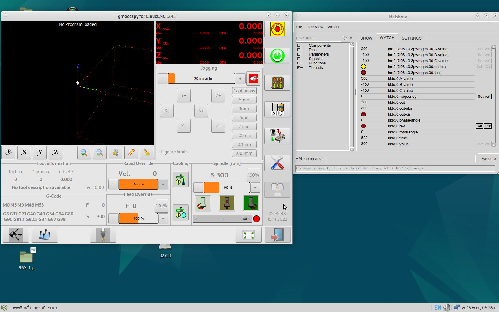

Thank you for following.
Yesterday I experimented with an old device, it worked as per the clip, set it up like this, the motor can rotate.

I think this is incorrect.
net spindle-vel-cmd-rpm => bldc.0.value
It should be
net spindle-vel-cmd-rpm => bldc.0.frequency
Or maybe something else to control the speed.
