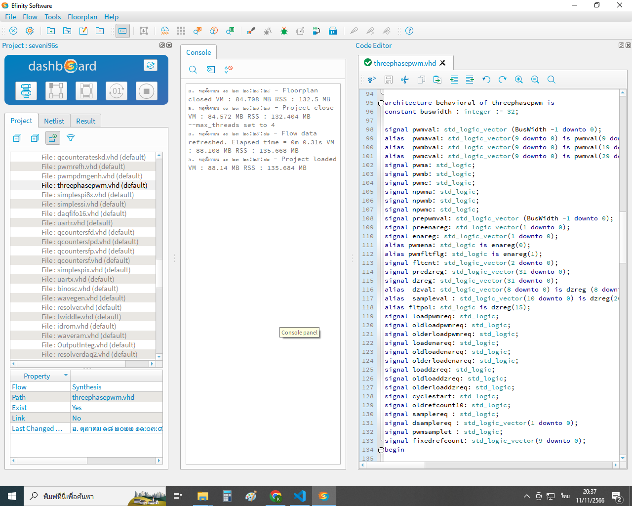

I just checked that the 7i95T in my stock has been sold. There is only 7i96s 5 pieces remaining I will order 7i95t again. When 7i77 is ready for sale
Now I'm trying to learn efinity software to use 7i95t_tpwmd as an example to modify it for use with 7I96S for testing only 1 motor While waiting to make the next order.
But it seemed like a difficult start to me. If you are free from work And without disturbing your time too much, I ask that you
Help create tpwm For 1 motor on 7i96S again
Thank.
11 Nov 2023 15:50 #285109 by PCW
I'm better setup to do this from work so I can do that Monday.

12 Nov 2023 22:40 #285215 by PCW
7I96S firmware with one three phase PWMGen
(fault input on isolated input 10)
