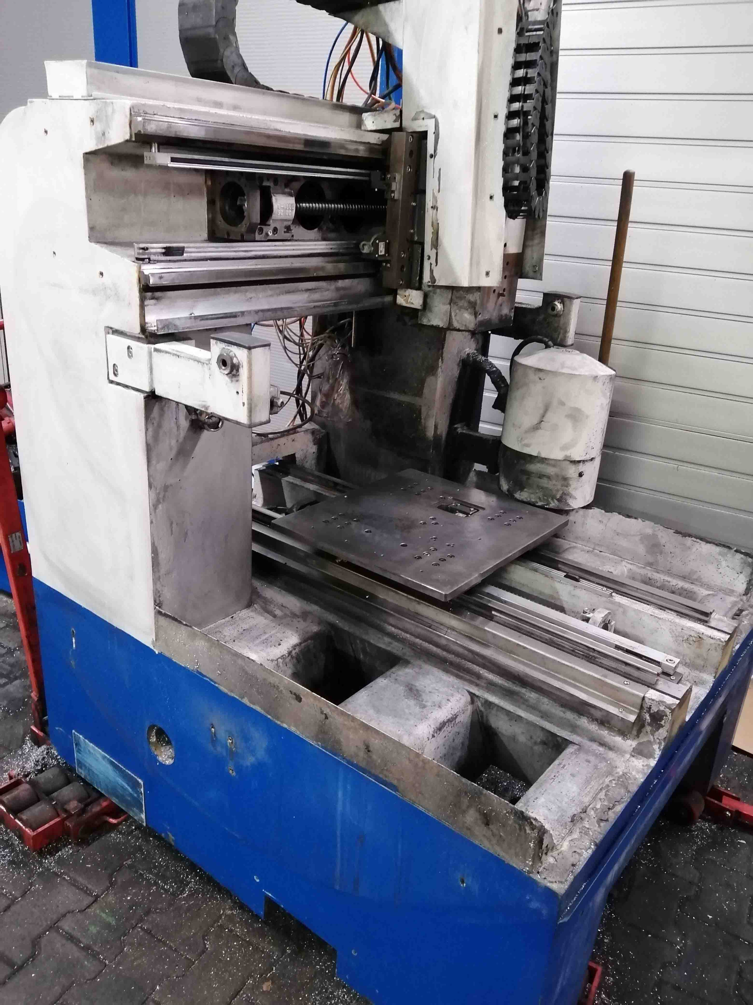

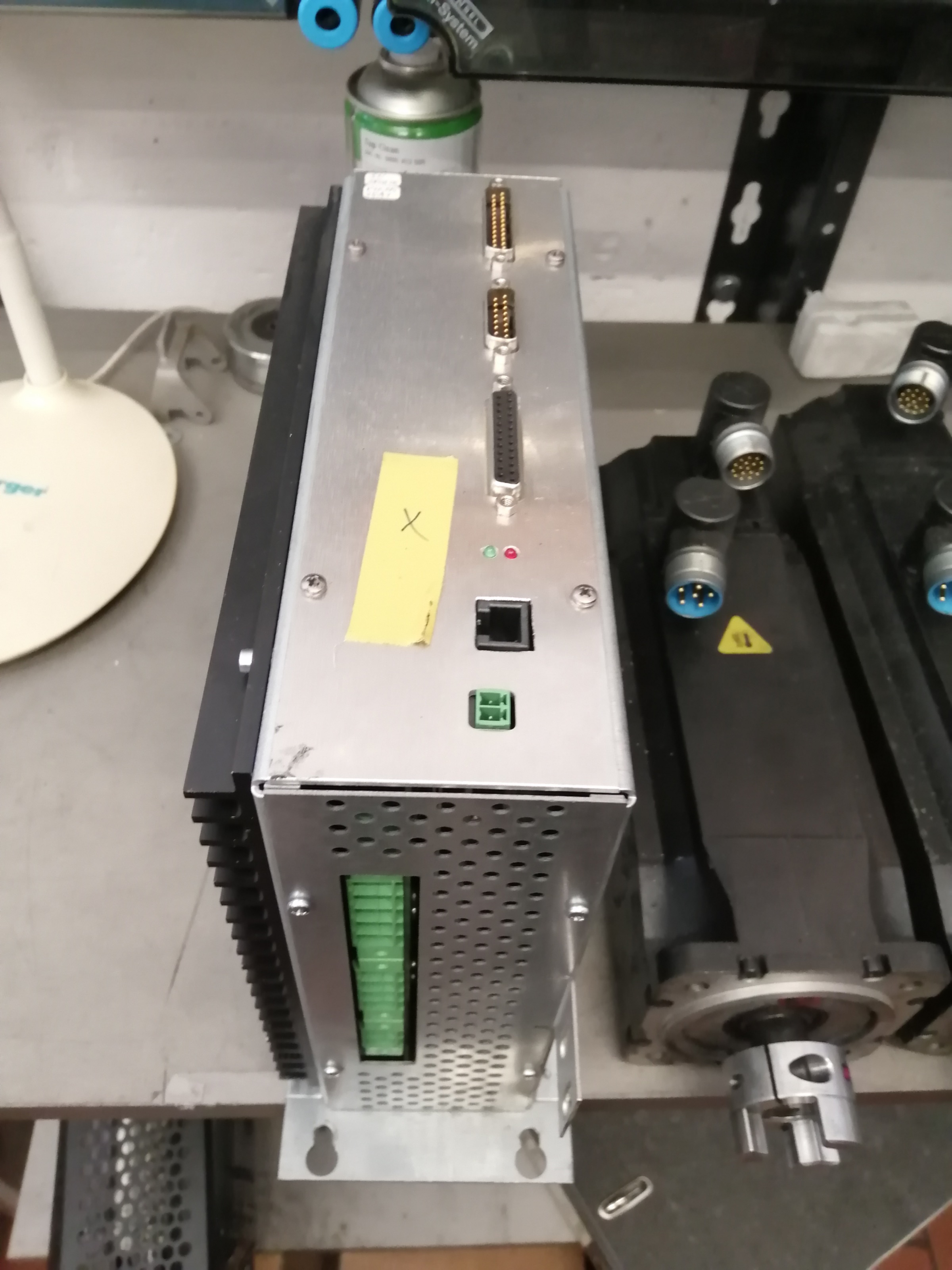

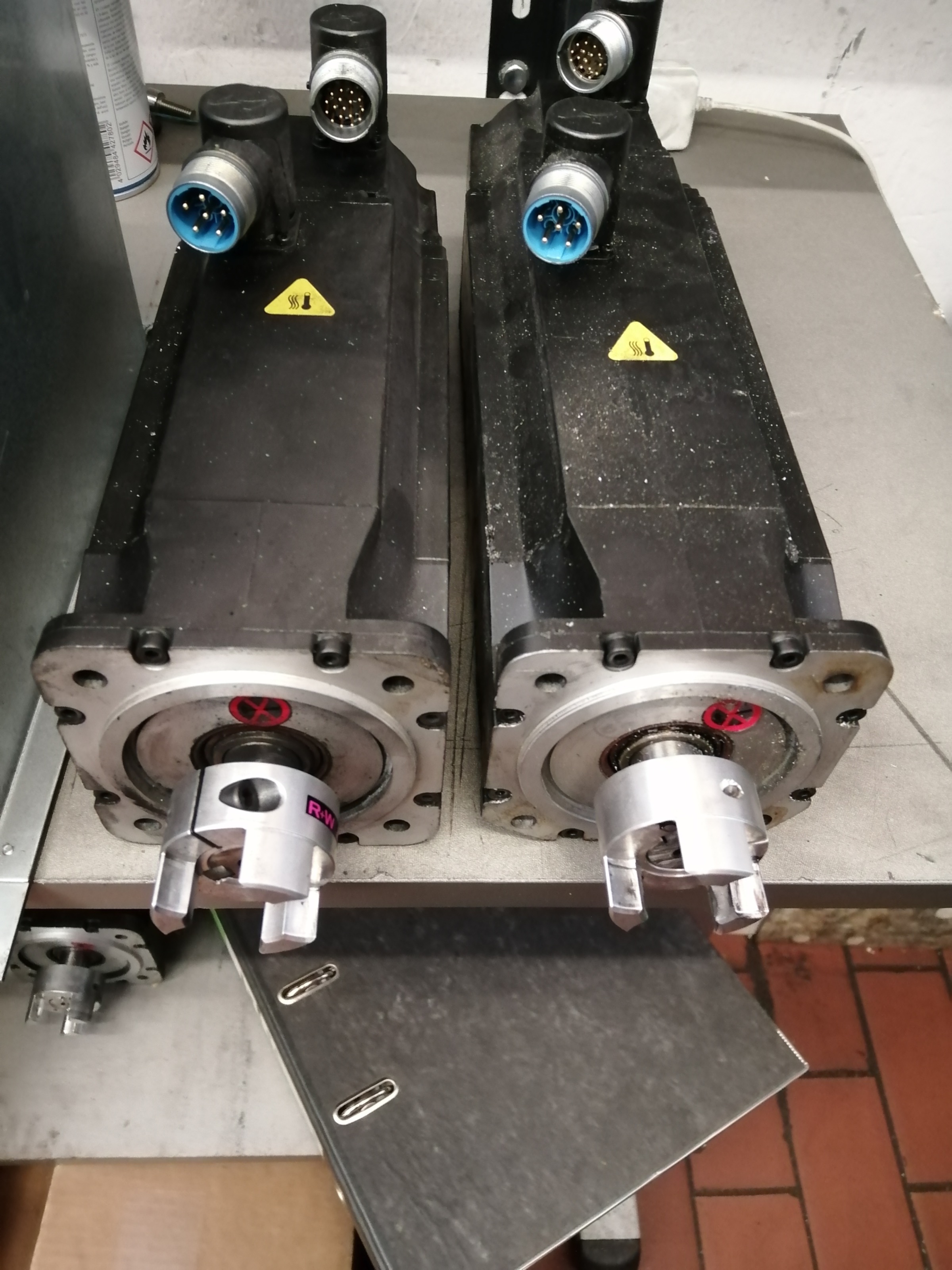

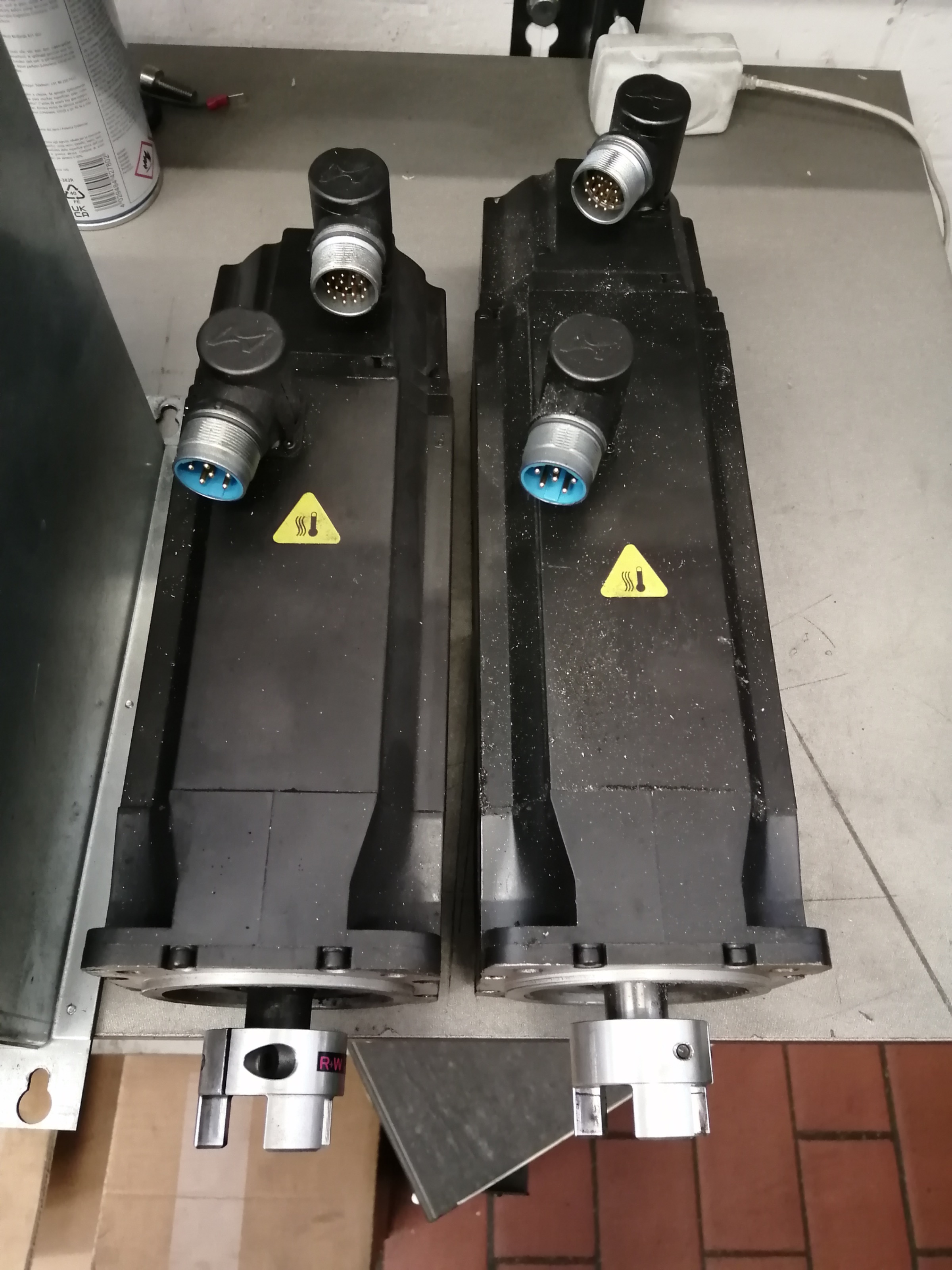

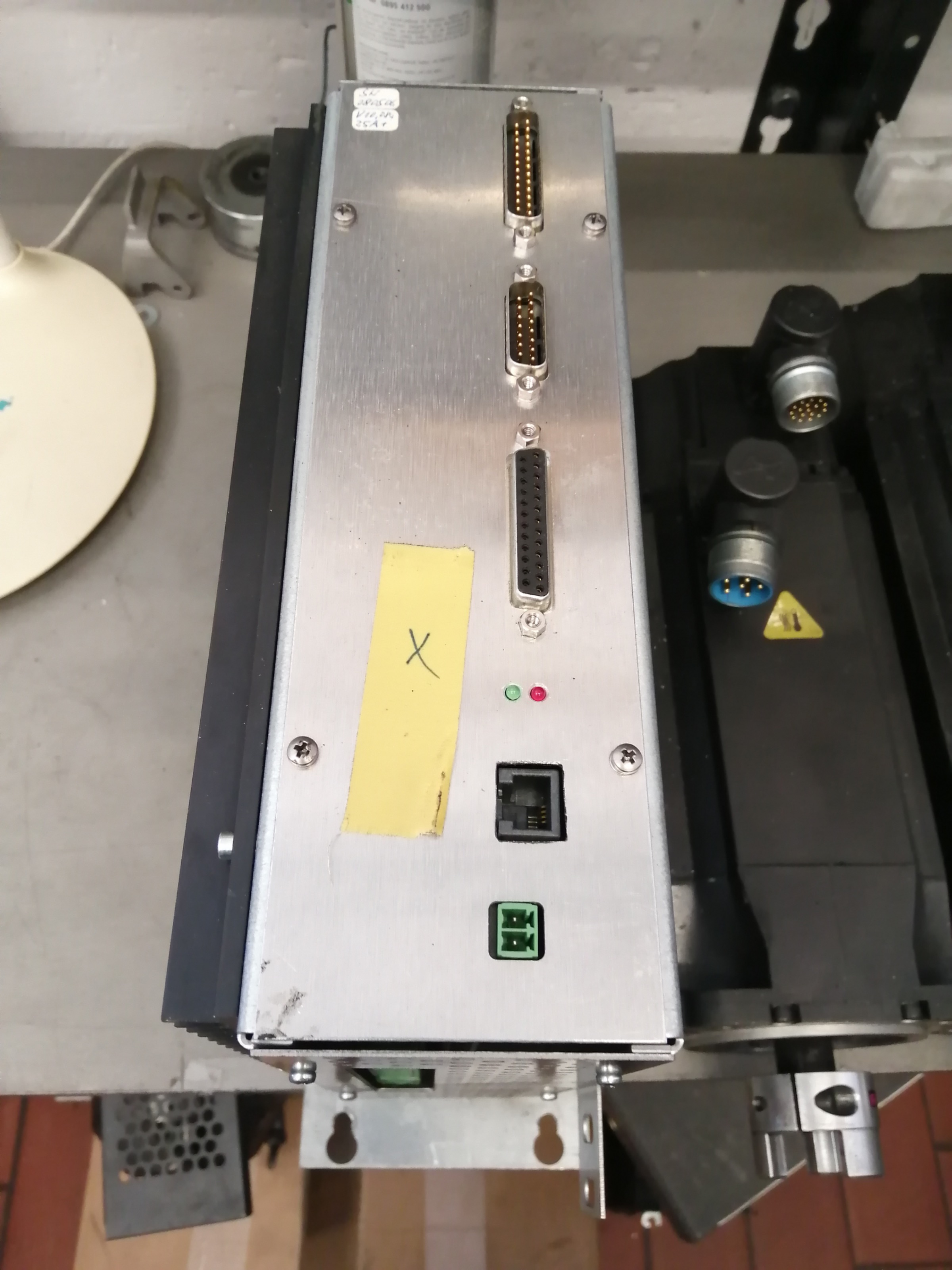

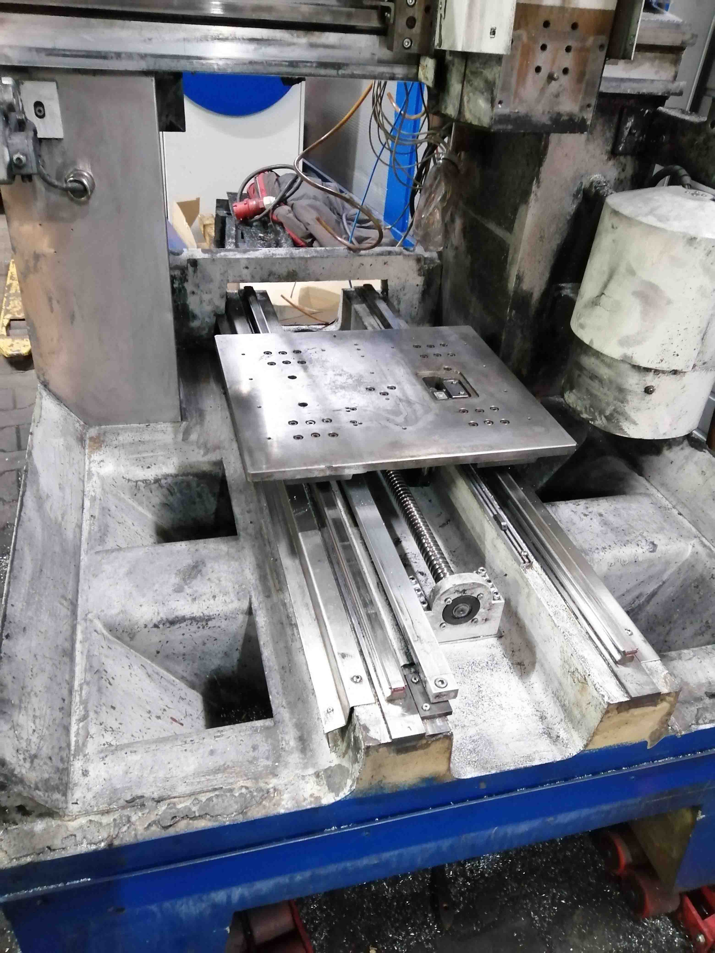

Today i took some pictures of the machine . This is a small machine with a footprint of 120cm x140cm x 170cm but weighs a whooping 4000Kg. Its made from epoxy granit of some sort. The last picture is how the machine used to look ,it´s the only picture i found online.
