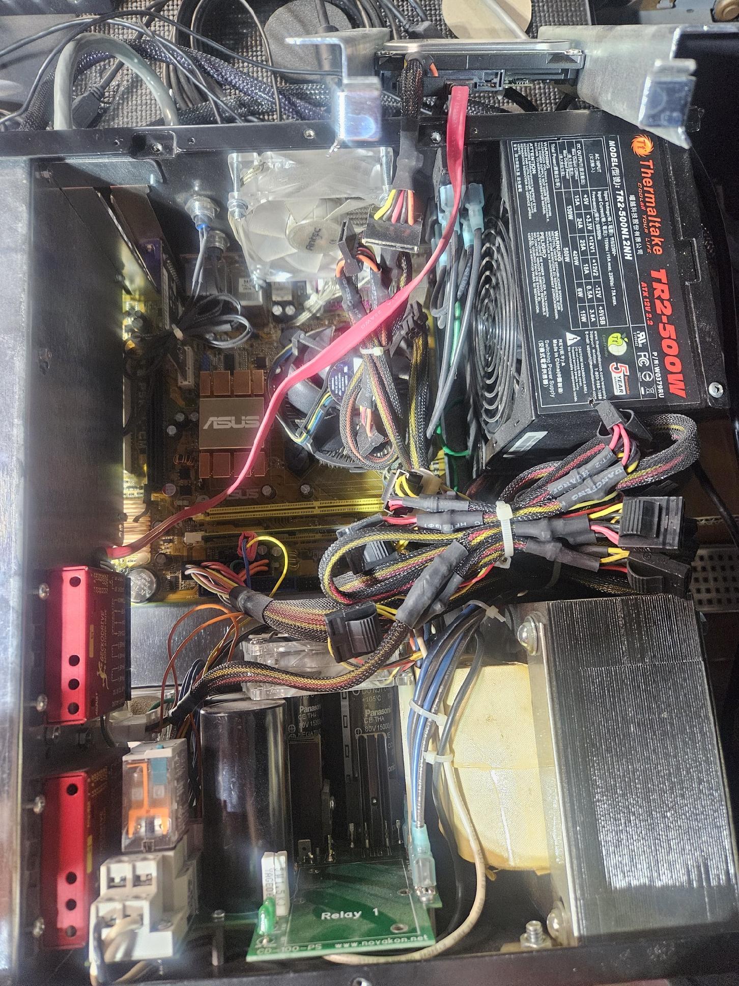

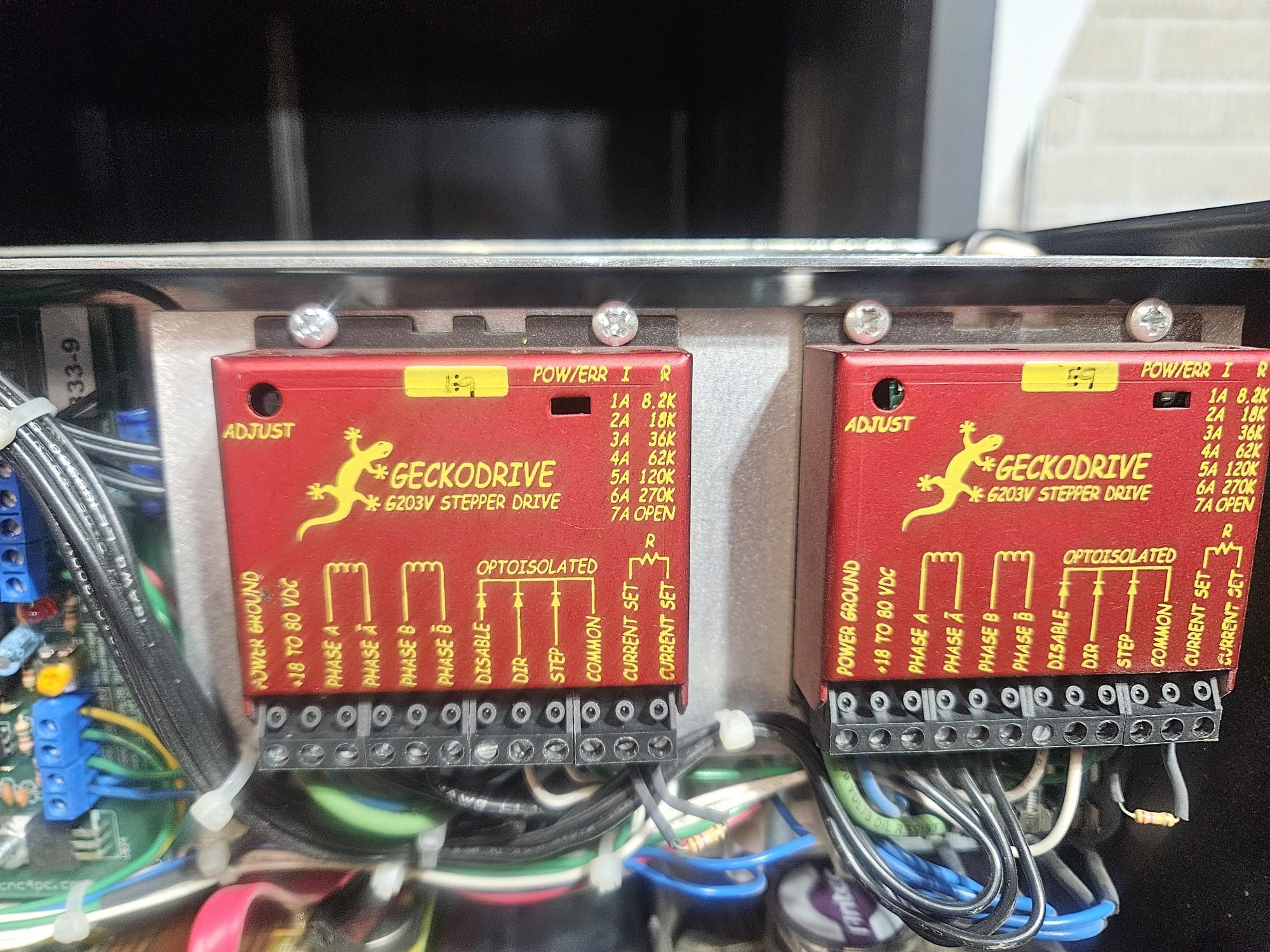

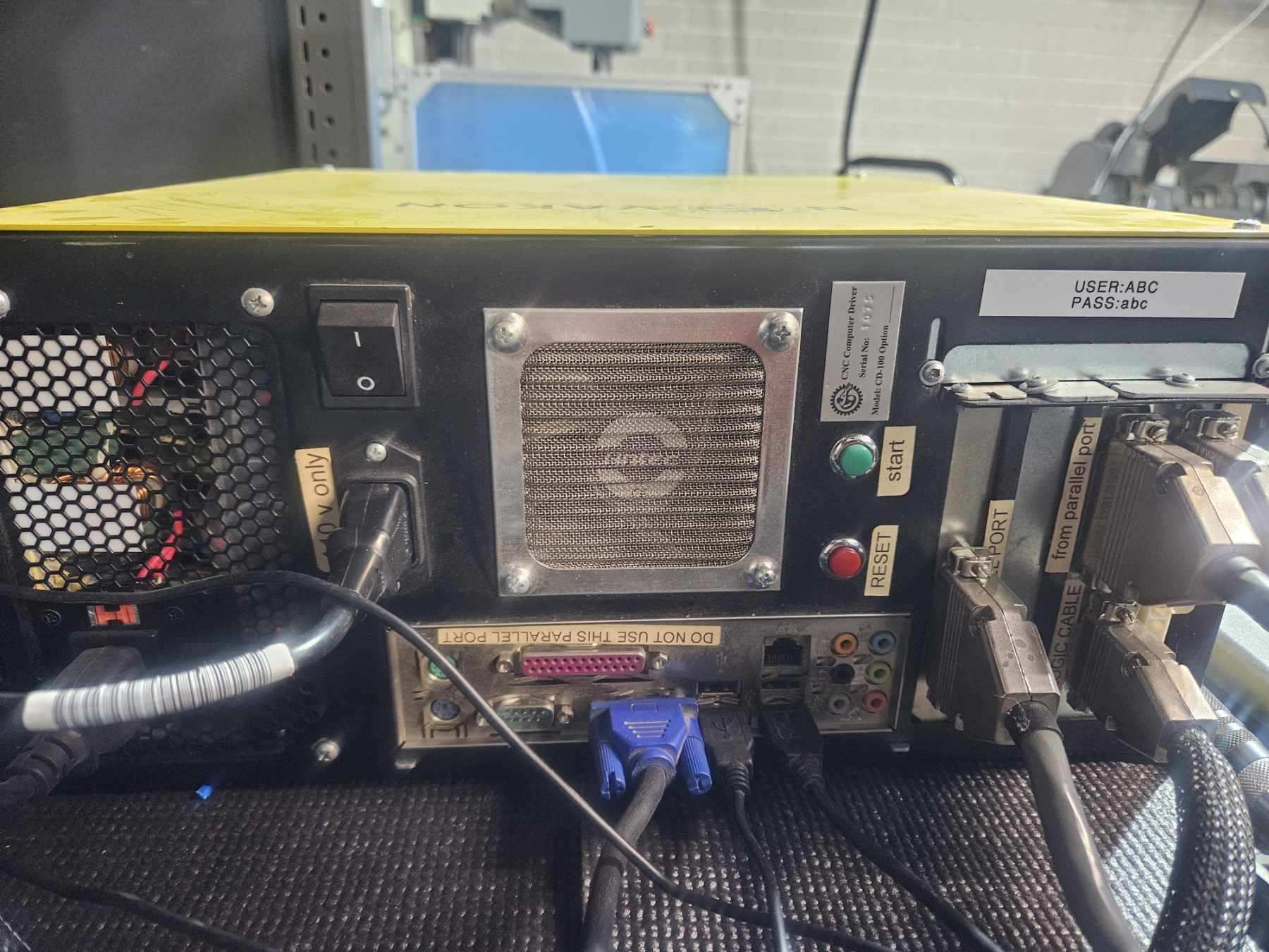

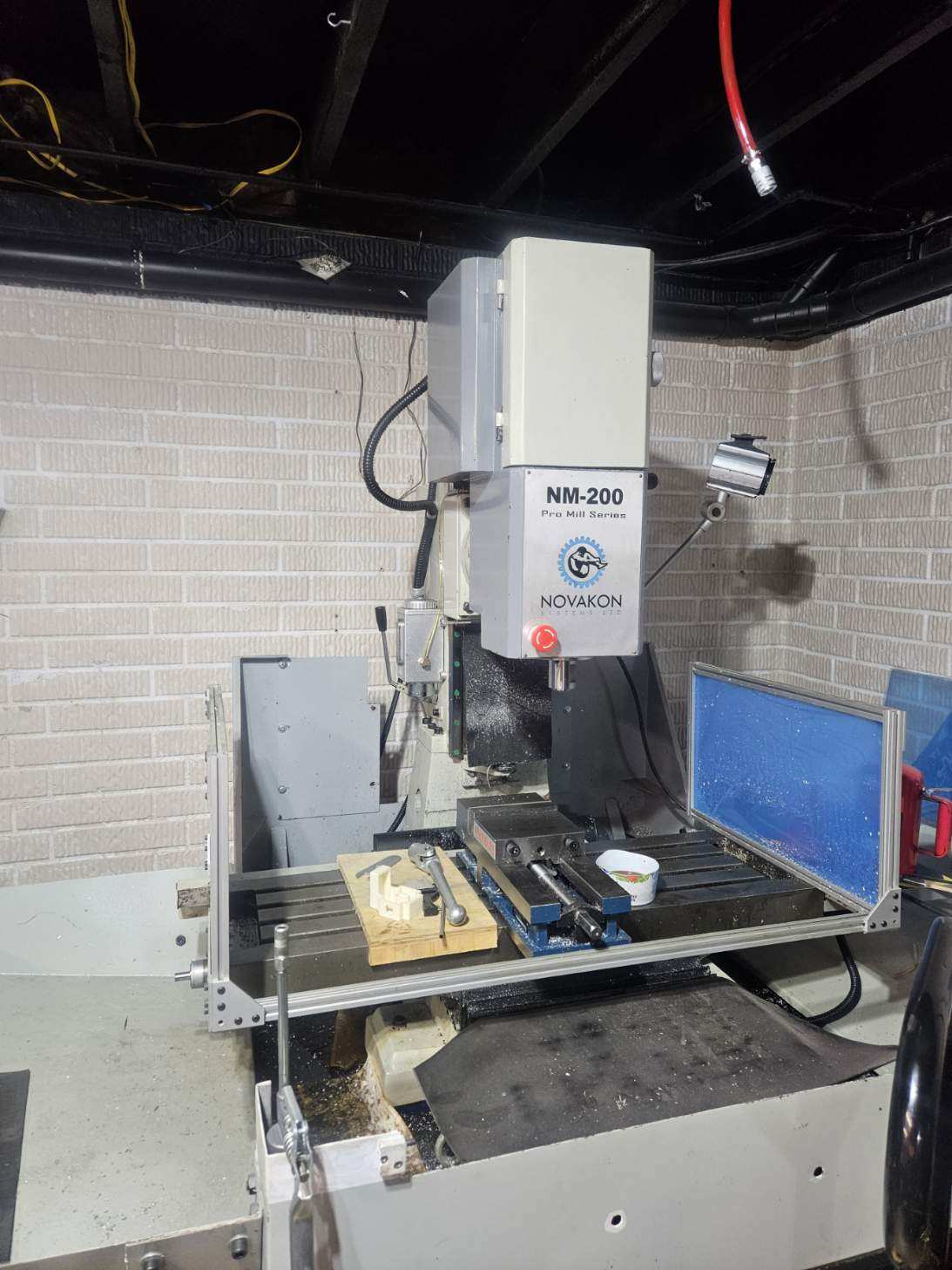

I have a Novakon CNC mill (similar to early Tormach machines). It is from 2009-ish, I bought it used for a great price in 2012 but have not put much time on it. It runs Mach3 and was always glitchy. Shortly after I purchased it, I got the idea I would do a Linux CNC conversion based on some others I saw doing it on CNCZone back in the day using the Tormach GUI (pathpilot), but I never actually got around to doing it. Also – I have little to no experience with Linux anything.

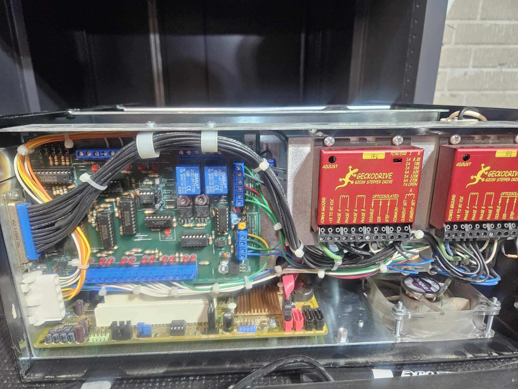

The current CNC Mill
Novakon NM-200 series CNC Mill, circa 2009
-Still functional, but still glitchy with Mach software
-3 Axis
-4th axis capable with rotary table, which I also have.
-Runs Mach 3
-Has C11 G rev 8.2 breakout board
-G203V Gecko Stepper Drivers

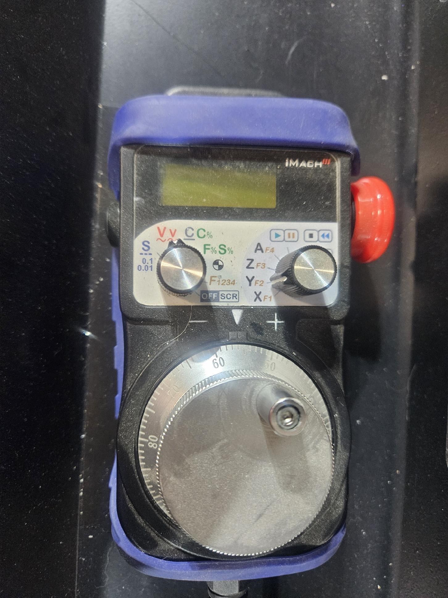

-iMach P2S Pendant (I added this)
Conversion Targets
-Keep costs minimal until concept is proven.
-New (to Novakon Machine) computer to run Linux CNC
-Want to keep original computer unmodified and functional
-The C11 breakout board and gecko drivers are still in the original
computer case and the ideal plan would be to jumper from them to the
new computer/Mesa card
-Run Linux CNC with Mesa card
-Currently have new, never used 6i25 Mesa planning to use
-After reading about others who did conversion Tormach GUI
(pathpilot) with mesa cards I bought one, then didn’t dive into the
project, so it’s a little older
-Is there a better/simpler solution that would be smarter to invest in now?
I want to keep costs down, but if there is another simpler solution to still hit
my targets and potentially save A LOT of time then I am willing to consider
the investment.
-Maintain functionality with iMach P2S Pendant
-Assuming this will be a relatively simply config option.
-Bonus – 4th axis capability

Your iMach pendant can be firmware-flashed to LCNC, so you won't need a bunch of IO for those functions. Keep in mind that the iMach is still USB with LCNC, so the pendant latency glitches you may experience now with Mach3 will still be present in LCNC if you use the iMach. They aren't broken... they just aren't 'real-time' even when working as designed. Mine is sitting in a box somewhere for just that reason.

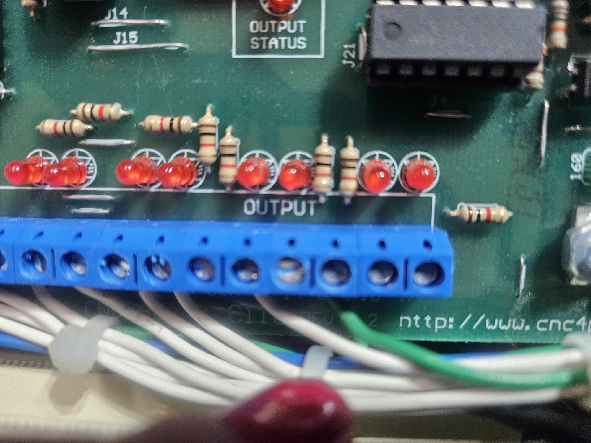

-With the 6i25 I have is it worth trying to connect to my existing c11 bob that is in the current setup machine. It appears it's from cnc4pc. Can I avoid buying the additional card or cards from mesa.

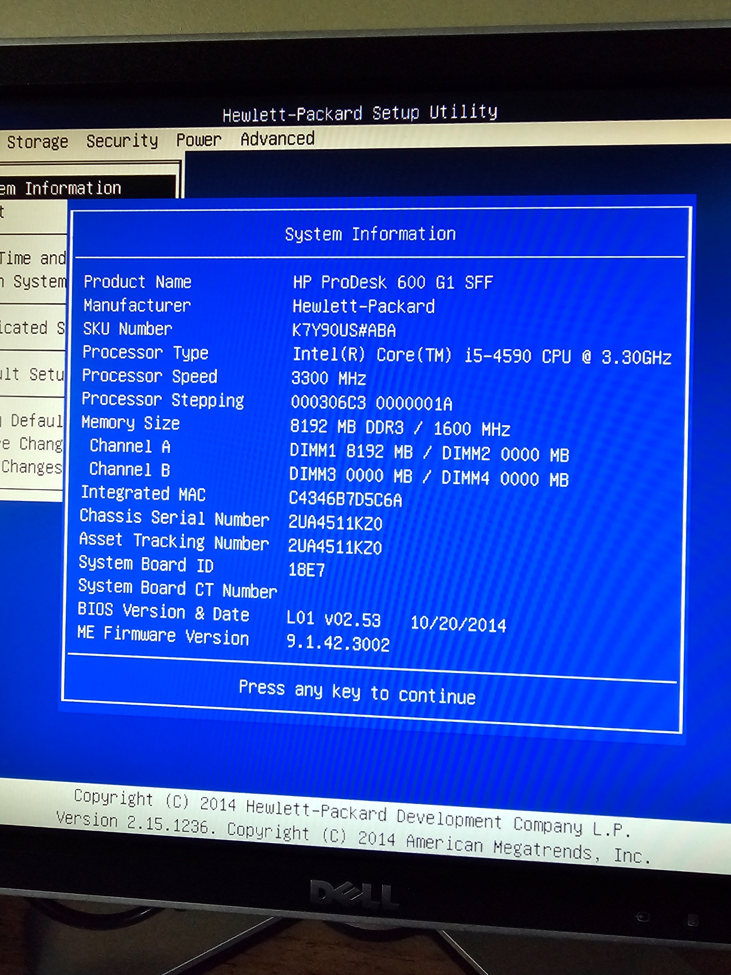

- I snagged a deal on a hp pro desk 600 is this OK? Specs in attached photos.
- Lastly I'd prefer to not gut my old setup that runs mach3 if possible cause it's still functional and I can fall back on it if I can't figure out this linx stuff. I was hoping to just link into that c11 board and geckos as it is currently configured. If not I would prefer to buy modest setup and setup another controller box. For this I am guessing I would need 7i96s, new drivers for each axis and new powersupply(s). At that point should I just upgrade to hybrid steppers?

My guess is the the HP will be just fine for LCNC.
While the 6i25 and C11 both have DB25 connectors, I don't know what the C11 DB25 pins are.
The C11g user manual isn't clear which DB25 pin is connected to which terminal. I _think_ it's duplicating a standard parallel port, but I'm not sure... nor am I sure if you'd need to cobble up a custom DB25 cable that makes the desired 6i25=>C11 connections.
If you really want to plug the C11 in to the 6i25, you might get a better response if you start a new thread under 'Driver Boards' with that specific question. That would certainly make it easy to revert back if such is the case.
If not, you're back to the decision of using the 6i25 with a daughterboard(s), or buying an ethernet Mesa card and maybe a second board for more IO.

Another thing I missed in your last post: you don't need new drivers. The 6i25 w/daughter board or 7i96s will connect to the Geckos and control them just fine.
How many IO points do you need, and what type? Make a shopping list and we'll see if a 7i96S can handle everything by itself.

There is firmware for a 5i25/6i25 and the C11 (and C11G)
so its a direct connection.

22 Feb 2024 13:48 #294013
by spumco
Thanks PCW. Is that for 6i25's P2 or P3?
Replied by spumco on topic Novakon Mill Conversion - Getting Started
- Posts: 18120
- Thank you received: 5337
22 Feb 2024 14:53 #294016
Replied by PCW on topic Novakon Mill Conversion - Getting Started
First C11 on P3 (DB25) second C11 (if used) on P2 (HDR26)
