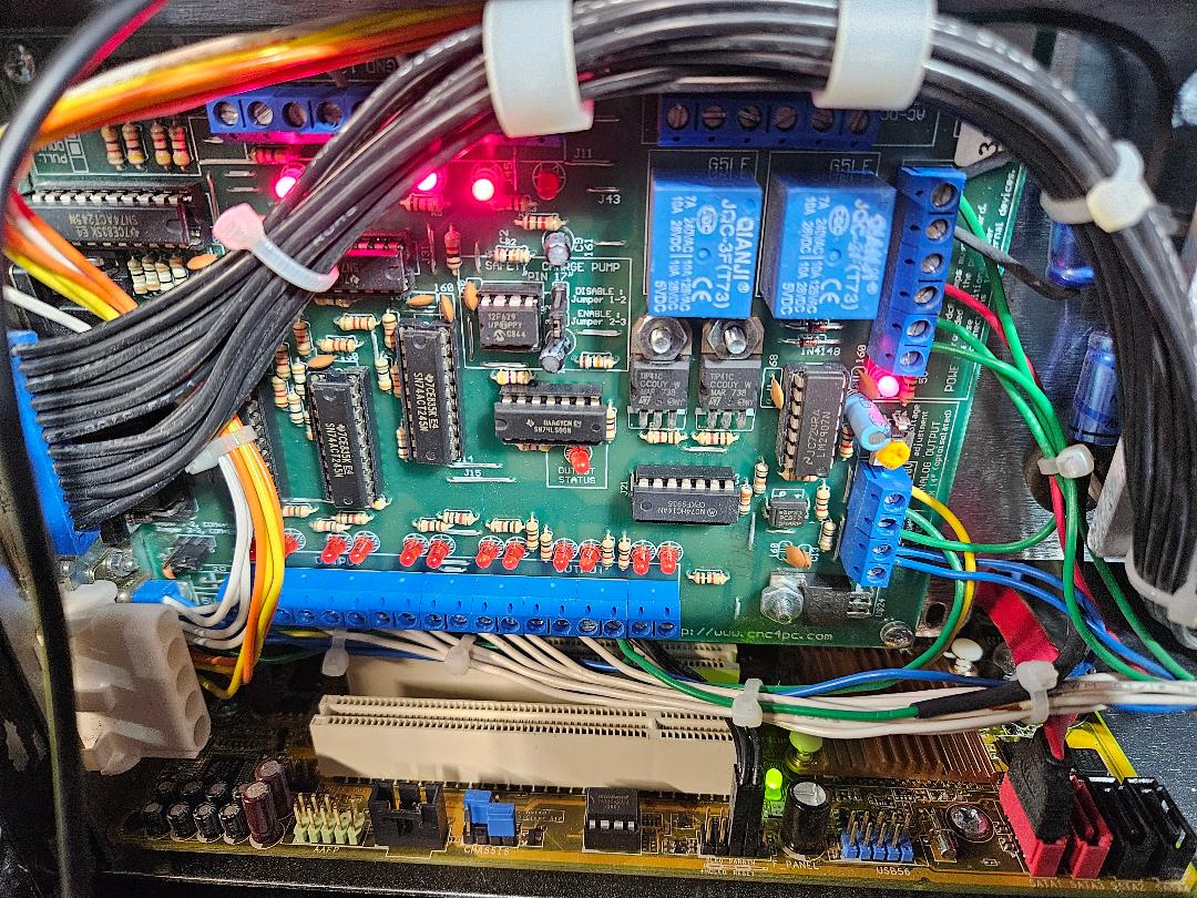

So, I got distracted with some other projects and am now coming back to this.
I finally bit the bullet and plugged the computer into the existing C11G board and tried to move the machine, and I got nothing, I had lights on the C11G board (no idea what they mean), and everything was clearly powered, but zero communication between Linux CNC and the actual machine.......The screen indicated something should have been moving but nothing physically moved.
So does this mean I need to create a custom hal/ini file since clearly something doesn't align with the existing pinout file? Or is there perhaps something else going on?
Lights on C11G board:

17 Apr 2024 19:21 #298515
Replied by tommylight on topic Novakon Mill Conversion - Getting Started
At this stage, check the bottom row of LED's on the C11 if they light up when you jog the machine, some should just light very dimly, some should be full on when jogging in one direction and full off when jogging on the other direction.

There were no lights whatsoever on the bottom row, so no actual communication/connection to the C11G board?
- Posts: 22037
- Thank you received: 7505
19 Apr 2024 09:50 #298621
After another look at the picture, it is there, staring at us, yet i failed to see it, it has a charge pump on pin17!
So edit the existing config using StepConf wizard or make a new one (you can have as many configs as you like/need) and add a charge pump on pin 17, that should kick things ...
