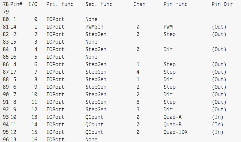

So now that I have LCNC opening, I want to confirm the pin call outs are correct for my board before I connect the computer to the machine and potentially burn something out.
The only location I can see all the pins definitively listed is the 5i25_c11gx2 file, which matches the pins I have confirmed for the motors and spindle. What is not clear to me is the pin for the charge pump (pin17) should that be a step?
And then there are several pins in the file that don't appear to be assigned, however my current board uses them for EStop, ZHome, Probe and a worklight.
In PNCConfig I could assign pins 13, 14, 15 & 16. 14 I didn't touch because it is listed correctly in the pin file. 13 I assigned to Z home, 15 I assigned to the probe and 16 I left alone but it should be for a worklight.
I should note that pin 10 for me is currently E Stop, Pin 11 is X home and Pin 12 is Y home.
My question becomes - does PNCConfig override pin settings from the firmware file? Is there somewhere I can see the pin settings for a specific LCNC configuration, I looked through the hal and ini files and nothing was obvious to me. When I viewed the hal config through LCNC and selected pins, explicit pin #s were not listed.

05 Mar 2024 06:16 #295220
Replied by andypugh on topic Novakon Mill Conversion - Getting Started
Pins not associated with a function (PWM, stepgen etc) are available for GPIO, soo are appropriate for probe etc.
Stepgen 4 on pin 17 has only a step and no dir pin, so that does seem like a reasonable thing to use for a charge pump.

05 Mar 2024 13:48 #295252
Replied by PCW on topic Novakon Mill Conversion - Getting Started
Yes, typically stepgens are used for charge pump drivers

06 Mar 2024 15:30 #295351
The available input pins on the C11 bob are:
DB25 GPIO
10 13
11 14
12 15
13 16

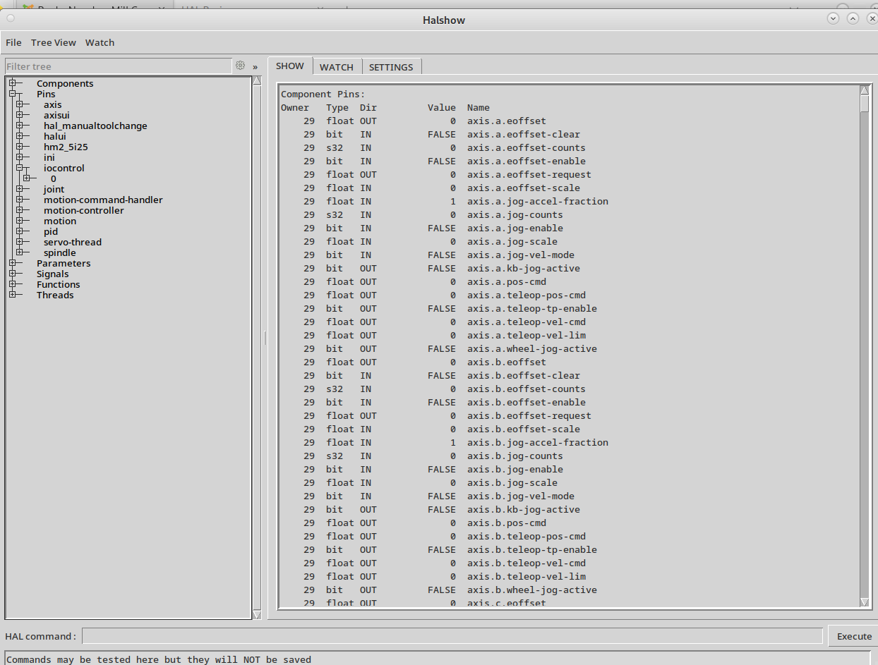

11 Mar 2024 17:31 #295695
by Whizbang
Replied by Whizbang on topic Novakon Mill Conversion - Getting Started
I went to "show hal config" under machine in LCNC but there are no pins listed for anything (see below). Based on what I found on the LCNC website for HAL basics, I expect to see pin assignments listed like the online examples, but that is not the case. What am I missing or misunderstanding? How can I see the pin configuration in LCNC?

11 Mar 2024 17:44 #295698
GPIO input hal pins would be named:
DB25 GPIO HAL NAME (True) HAL NAME (inverted)
10 13 hm2_5i25.0.gpio.013.in or hm2_5i25.0.gpio.013.in_not
11 14 hm2_5i25.0.gpio.014.in or hm2_5i25.0.gpio.014.in_not
12 15 hm2_5i25.0.gpio.015.in or hm2_5i25.0.gpio.015.in_not
13 16 hm2_5i25.0.gpio.016.in or hm2_5i25.0.gpio.016.in_not
15 03 hm2_5i25.0.gpio.003.in or hm2_5i25.0.gpio.003.in_not

- Whizbang
- Posts: 19
14 Mar 2024 16:00 #295919
by Whizbang
So I was able to read the hal show under hm2_5i25 saw my pin assignments for 13 (Z home) and 15 (probe) but beyond that it looks like there is no assignment to pin 14 which should have been assigned by the c11gx2 firmware, right?
I guess I still don't understand how to read the hal file to confirm motor set-up (the step-gens), E stop and X & Y home (QCounts?)
