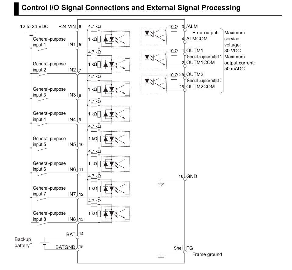

Trading for some ethercat servos this week so I'm going to make a whole separate new control for testing.
Drives are omron RD88 400w and 200w models. 20 bit incremental encoders.
They do seem to have at least a couple IO on each one, but I think I definitely need more IO. I did have an EK1100 somewhere, but I cant find it and it would cost a few hundred to get the IO modules, especially spindle analogue.
Does anyone have a link to a low cost IO module that works well with linuxcnc? I've seen a few floating around, but I have no idea if any of them "just work".

So as it turned out we have lots of IO on the drives. 24 in and 6 out. So really It will be down to figuring out the spindle. RS485 is an option on the drive, but I know virtually nothing about how that works. Anyone got a link to some "for dummies" instructions? and whether it will work alongside ethercat?

I then looked at your diagram about io. Just check the docs to see what it says for internal homing and limits as if used, it will consume some pins.
I'm keen to get internal homing working so I can do torque homing to avoid adding limit and homing switches

Homing I am just gonna do the normal switch plus index for now. So 3 inputs out of my 24.
Other inputs I need are:
- Probe
- Laser tool setter
- Spindle clamp sensor
- Hard limits are either 3 or 6 switches but I will leave those off for now.
Not sure how you handle an MPG with this.
For outputs I have:
- solenoid for tool release
- solenoid for M7 mql
I will be using probe basic I think for this, i will need to figure out the rs485 for the spindle. It looks like I can read back the torque, and alarms, which is nice. My biggest issue on the old setup is the control is blind to errors and when the spindle or an axis stalls it just keeps on keeping on. Gotta get that all tied up.

Your drives should have a fault/error output ( you would configure an output for this in the xml file) and connect it to jount.n.fault-in
That way Linuxcnc will konw when a fault occurs.
