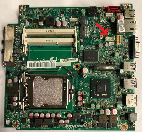

You might be able to get a uart to rs485 adapter and make your own cable to pick up the expansion port. Just check the voltage the PC uses. If you need 5 volts, you could steal it from a USB port.
core-electronics.com.au/ttl-uart-to-rs48...D1tkF_xoCPwkQAvD_BwE
Other than that, the USB version (which I use) is OK. Once, it changed to a different USB port then it has not changed again! I just needed to edit the config file to use the different port.

Others will know more than me but that looks like a JST connector. Something like this
www.ebay.com.au/itm/154065078026?chn=ps&...9UbkzuugEo8uJPwuwmfk
They come in different pitches eg 1, 1.5 , 2.0mm etc so measure the distance between pins
