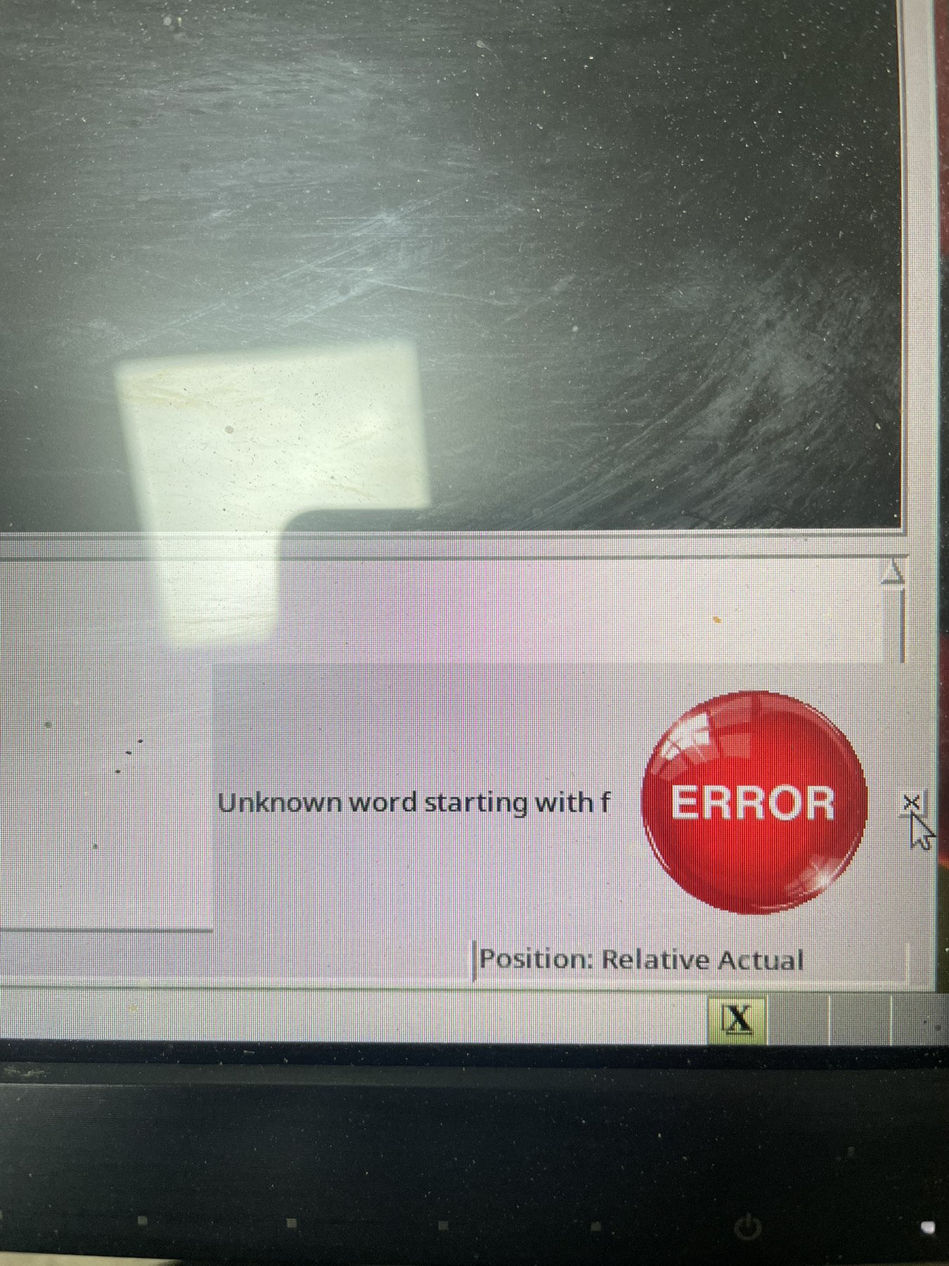

Replied by Masiwood123 on topic beta bulleri for retrofit?
I installed the homing, the remap for racktoolchange based on the example does not work for me, it throws out some errors, if there is someone more expert, I will send the files and errors so that he can establish it, the change system is very simple, I have 6 pockets, two outputs that I connected to the hal and which work in mdi, one for tightening and releasing the tool, the other for locking... I have on each pocket an input for the inductive sensor that the tool is in the pocket, I have positions where x0 and six of the y position of the tool and the change is works on z-120mm from G53. thanks in advance
(this is when i try in mdi o<rack_change> call ....i changed pins in ini lock=1 flush i changed to clamp=0 all the same

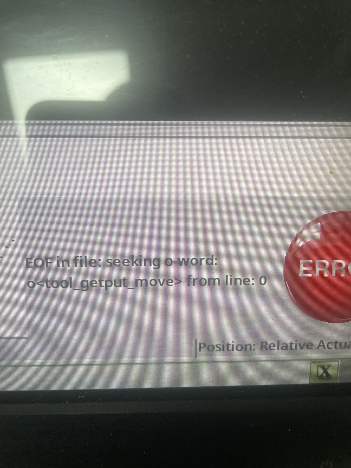

I tried it first, it doesn't show an error but nothing happens, and linuxcnc seems to freeze slightly, release the play button and nothing... I'll see now, maybe it's something to do with the python script or subroutine path,when i try in mdi o<rack_change> call or o<tool_getput_move> call i have this error.. I have no idea

now I deleted everything related to python, in the ini I only added remap=m6 modalgroup6 ngc=toolchange
subroutine path to the folder where my toolchange.ngc is, if I type in mdi T1 m6 or o<toolchange> call I get an error like in the picture-

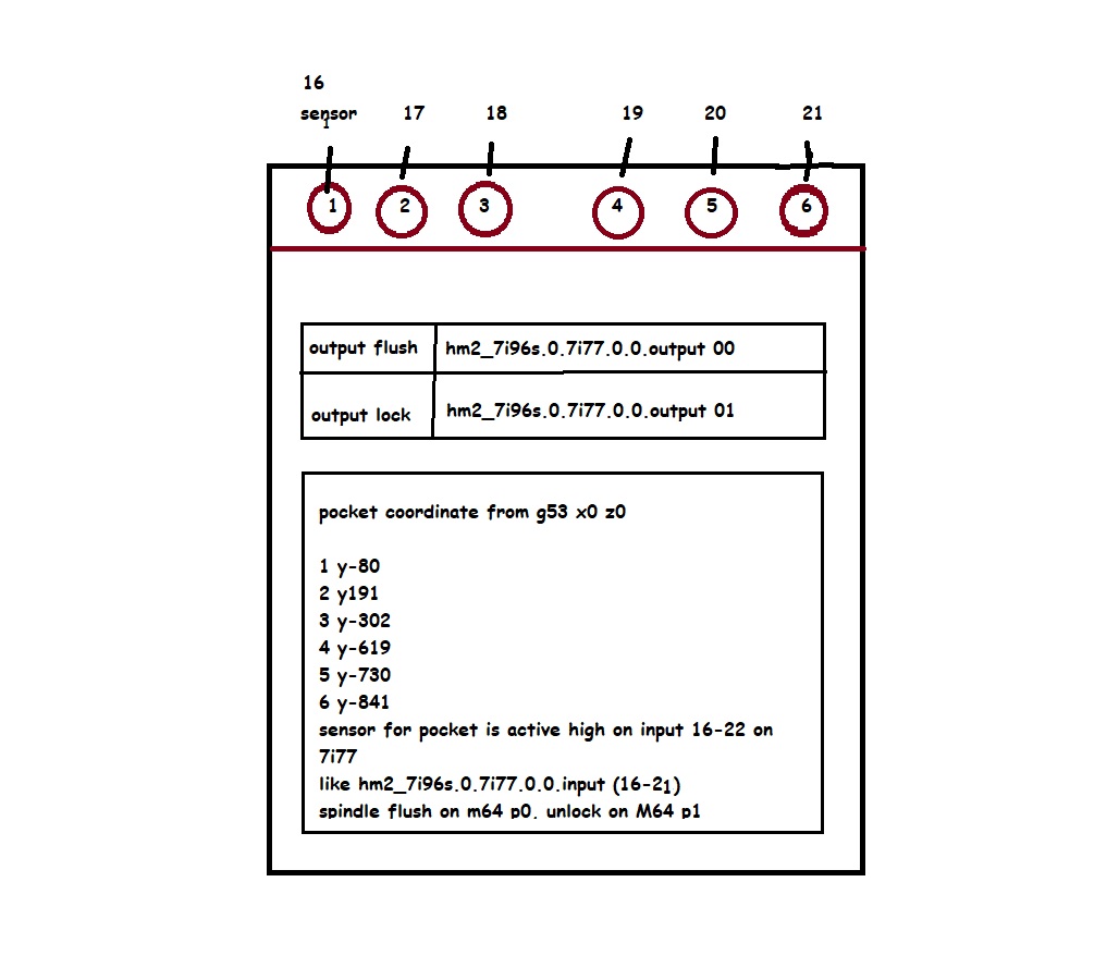

Can someone help me create ``rack_change.ngc`` based on my configuration and pocket coordinates, I tried without python because I don't know where to put path and toplevel because those files don't exist in my configuration, just simple ngc, the example from github doesn't work. The last one I sent only works on the m6 command from mdi so it starts lowering z, it doesn't wait to check if the tool is in the pocket because for each tool I have an inductive sensor that is active high, when there is no tool it becomes active low...rack is very simple, only the y coordinates in the game are from g53 and the change should happen at z-170mm, the M6 t1 command for example just plays play without any movement, and m6 goes to the first pocket because I defined the y offset y-80 in the tooltable.Thanks

this won't work either in sim mode or in reality, I tried something via chatgpt but I know that it doesn't work, it can't create a routine. here is my configuration if anyone is free to look at where the error is and what needs to be added in Hal eventually. Tx m6 works but will not return the tool to its pocket when you give it another tool, it also reports in the bottom line that there is no tool even though in reality it took it. each pocket has its own active high sensor on inputs 16-21 and the spindle has a sensor for ``flush'' input 10 the tool is in the spindle, input 12 reports that there is no tool in the spindle. Thanks
