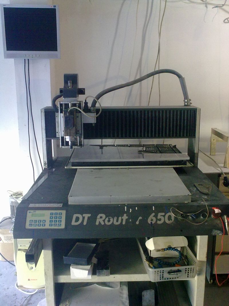

Help needed! SEI DT router 650.

On the second look, it seems this router use stepper motor.

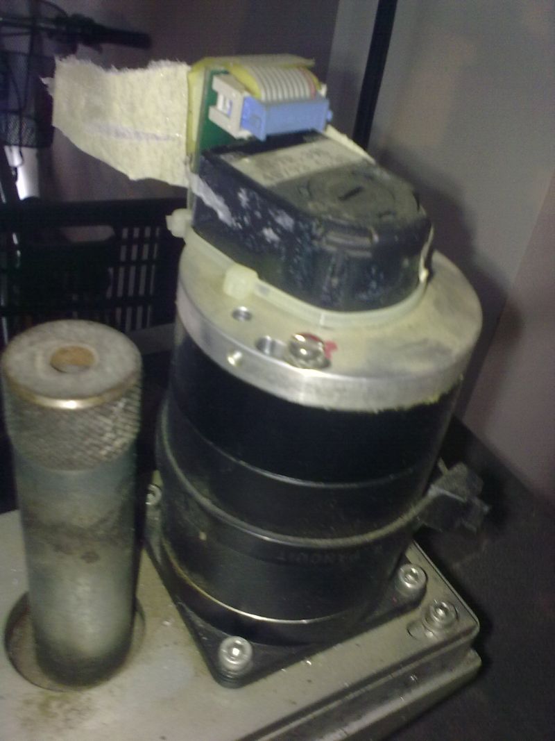

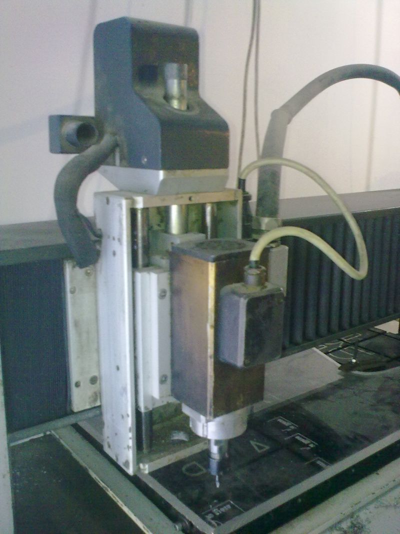

Pop the cover off the Z and take a close up photo. There are some steppers with encoder feedback but not usually. If the axis feels like it has cogs when you turn it by hand it might be a stepper, if it feels smooth when you turn it by hand then it is a servo. If it is a servo and has brushes (plastic screw caps around one end) it is a DC servo AFAIK.

24 Feb 2011 11:33 #7426

- Borideleon

It does look like a servo from the picture.

They feel like servos,the movement is fluid.X and Y axis are belt driven by a servos. The real question is, can it be operated with EMC ? What hardware is needed? I am sorry guys,but this kind of machinery is new to me as i used to work with SolidCam and this is the first time i buy my own machine. The fact that i got it working so far is no more than a miraculous event for me. If i only i could make it work with preferably linux system ,i would be a very happy man.
Maybe serial to parallel converter can be used?
