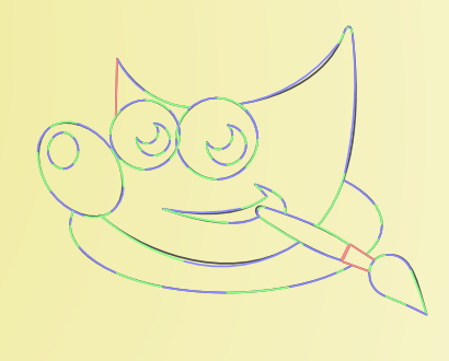

I've remade Inkscape plug-in and want to share it :).
New features in Gcodetools v1.6
  • Lathe machining
  • Engraving
  • Tools library
  • Multi-tools machining
  • Orientation system
  • Post-processing
  • other small improvements
New features in Gcodetools v 1.4:
1. Interpolate beiser curves using biarcs, not straight lines.
2. Export a number of curves.
3. Draw resulting curves.
4. Personal header / footer
5. Different scaling
6. Multy-pass cutting
7. Area cutting
The plug-in is available for downloading here:
www.cnc-club.ru/forum/viewtopic.php?f=15&t=35&start=0
There are English and Russian support forums.
English:
Russian:
www.cnc-club.ru/forum/viewtopic.php?f=15&t=34&start=0
I wonder could it be added to wiki?
Here is an example: (Blue and green curves - parts of biarc, red - straight lines, black - original path)
Last edit: 23 Aug 2010 08:38 by Nick.
