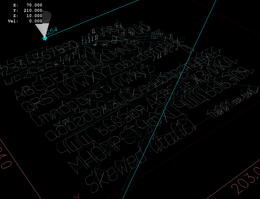

Hi!
Nick, thank you so much for your tools, it's very useful!
I suddenly develop true vector font for engraving. ASCII, Cyrillic (and some EU chars/signs) present. Can anybody please try to use it (with Inkscape + Gcodetools) and post here photo of result?
Please also read here bugs.launchpad.net/inkscape/+bug/716676/ .
Thank you! =)

17 Jul 2012 15:08 #22088
by Nick
Replied by Nick on topic Re:Gcodetools - Inkscape's CAM extension
