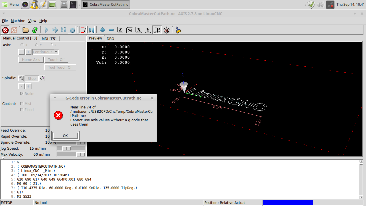

I have edited the post (the G64P0.001 is saved along with G20 G17 G90 G40 G49 G80 G94) with some success, linuxcnc will get hung up (see screen shot, & ref gcode in attachments)
I just am not shore what I am looking for, with a error like that. naturally the machine will not move, so an't tell if the G64 is working. When I edited the post, I did not use find and replace this time. The 1st time used find and replaced and there was some g code copied more than one time. Any advise is welcomed. I trust the "max_acceleration=10.0, " is in the ok range.

That alarm is because on the 73rd line of the file you have:With no motion command (G0,G1,G2...)
G0,G1,G2... are all modal commands so they don't have to be put on every line, but the G80 command cancels them, so a new one must be commanded before a new axis command is given.
So to fix your problem either add a G0 after every G80 or remove the unnecessary G80s.
The preamble codes are only really needed at the very start of the file, so inserting them all at every tool change is a little excessive. I also usually put a motion command on every line that makes a movement rather than trying to rely on their modal state.
X2.2879 Y-.4525G0,G1,G2... are all modal commands so they don't have to be put on every line, but the G80 command cancels them, so a new one must be commanded before a new axis command is given.

Many, many thanks Todd, I only edited the post, the rest of the code was generated from within the software. From reading your comment, it would appear that the G80 needs to go. My hope is that the post will automate this part. I will study the file more.
many thanks!
