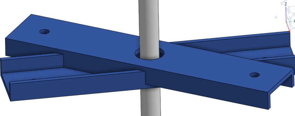

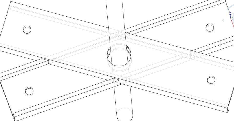

I can try to get a hobby license for Fusion 360 as you suggest, but is that because the CAM in F360 is so good that it's worth the hassle? Or is there other CAM software out there that would also be good for me to try. As stated I already use OnShape which lets me design my parts and export them in a wide array of formats. So if F360 is best for what I'm trying to do then yes I'll try to get it. I just wanted to clarify in case you were thinking I needed CAD as well as CAM.
Regarding parts, I will be modifying these parts as I prototype and test things so I hate to do it manually if I'm changing. Again the circles are easy, those are child's play to adjust as needed, even manually. But even from the 2 pics I attached, you can see the slots are different in both of those cases, and they could change quite a number of times before I finish.
So these darn slots are really the part I'm concerned about.

Hi Andy it's funny I was thinking about this just last night and considering hand coding again but with that exact question (issue) you were trying to explain: How does one use a coordinate system to pinpoint where exactly I need to cut through that sidewall and at the specific angle I need. If I can figure those things out I could do MDI.
To answer your question the angles come from the number of blade-pairs in my turbine assembly. If I have 3 blade pairs they need to be 60 degrees apart. If I have 4 they need to be 45 degrees apart. I have 5 blade pairs so they need to be 36 degrees apart. Basically 180 / # of blade pairs.
But even if I can come up with how to do the angle in a coordinate system. I still need to hit the spot exactly on the sidewall so that when these 2 parts are nested together their center holes line up exactly in the Z-Axis.
It was for this reason that I felt a proper CAM solution directly from the CAD part would be best. Because one little change to my angle and poof my whole MDI needs to be thrown out the window due to how these slots would change.
The pics below are of 2 nested U-Channel pieces 36 degrees apart. But you can imagine these slots would change drastically if my angle changes to say 45 degrees apart or 30 degrees apart (implying 4 blade pairs or 6 blade pairs).
For a better overall understanding of my invention you view my youtube playlist of my Harmony VAWT project.

A friend of mine uses Onshape and exports the files to something F360 can open to use its CAM function. Give it a go.

That's exactly what I did. STEP file export. But now I'm trying to learn some F360 basics to flip and twist my model so that it's oriented properly in F360. It's standing on end in there now. LOL
