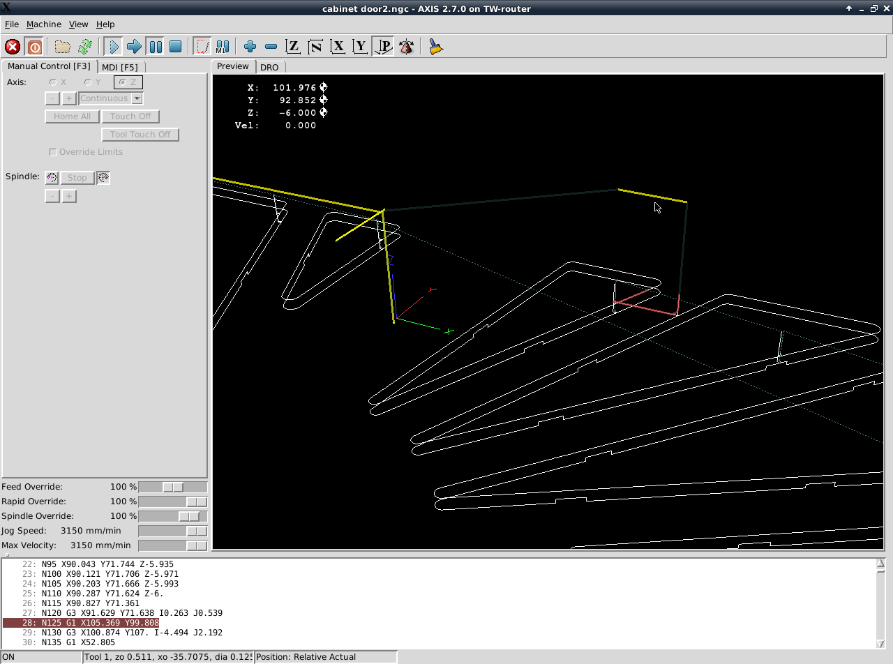

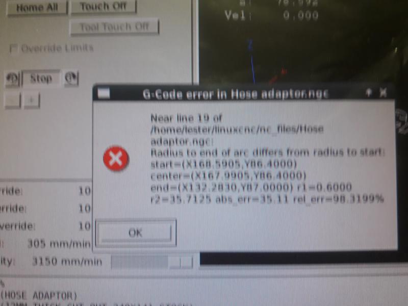

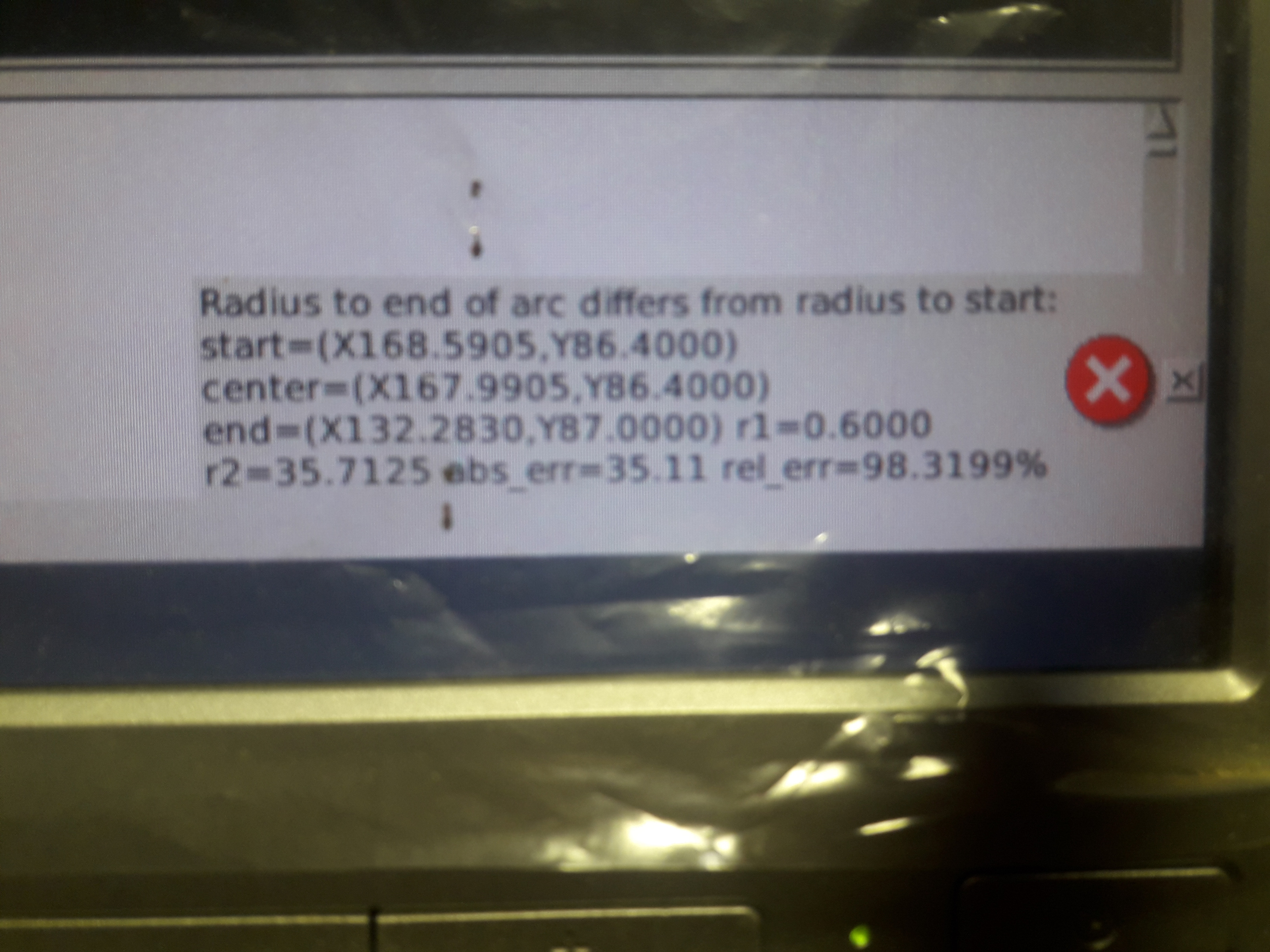

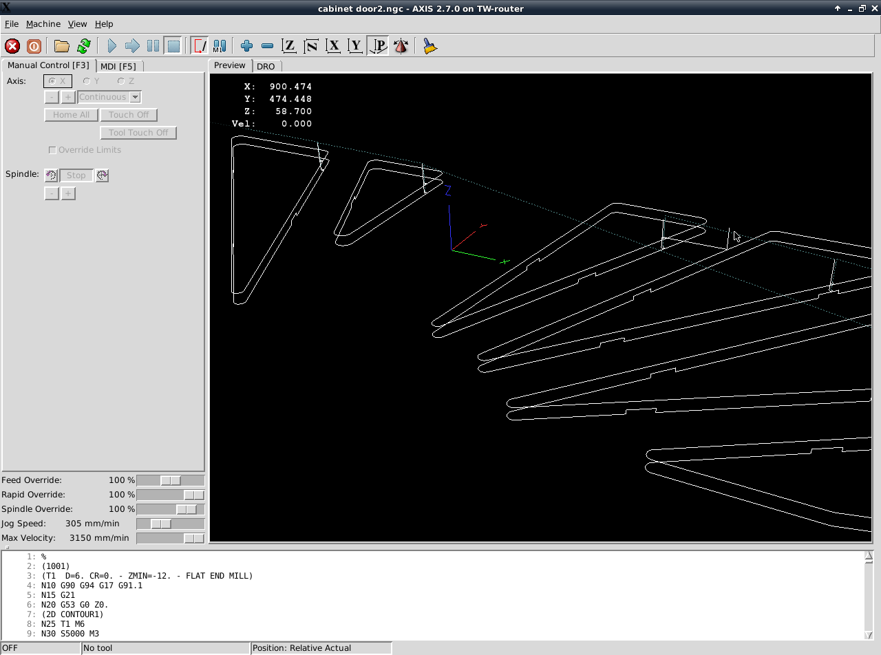

Hello,
I have problem with X axis origin seeming to more after touching it off as zero.
I have a 3 axis router and am using Fusion360 (personal edition) for drawing models and creating G code. I have not used it a lot, but recently this problem has started.
Sometimes I will get an error message …. Radius to end arc differs from radius to start…. Message may show when opening the file. If I click Ok and continue the same error may appear again when starting to run machine. If I clear error with crtl & space bar the machining will start about 35 mm to the left of where I wanted it.
If I open the same G code file again I may get no error and machining goes correctly.
But today the first file I opened didn’t show any errors, but still it machined it to the left by maybe more than 35mm.
I will attempt to attach 2 screen shots and the 2 G code files.
I have been using the Fusion web base processor and am not sure now if I have changed between the EMC to EMC2 selection without realizing it.
Which one should I be using??
What is the difference??
I have now downloaded the Fusion EMC2 processor onto my PC. But I still have had the error and wrong machining using that.
Is anyone able to enlighten me as to where my problem maybe?
Thank you
Trevor

Check if you have any offsets active.
Radius error is due to tool being to big for the radius being cut or when starting from an arc.

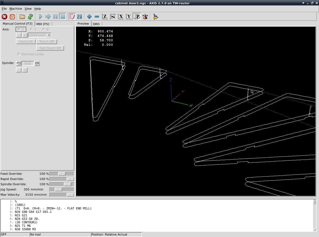

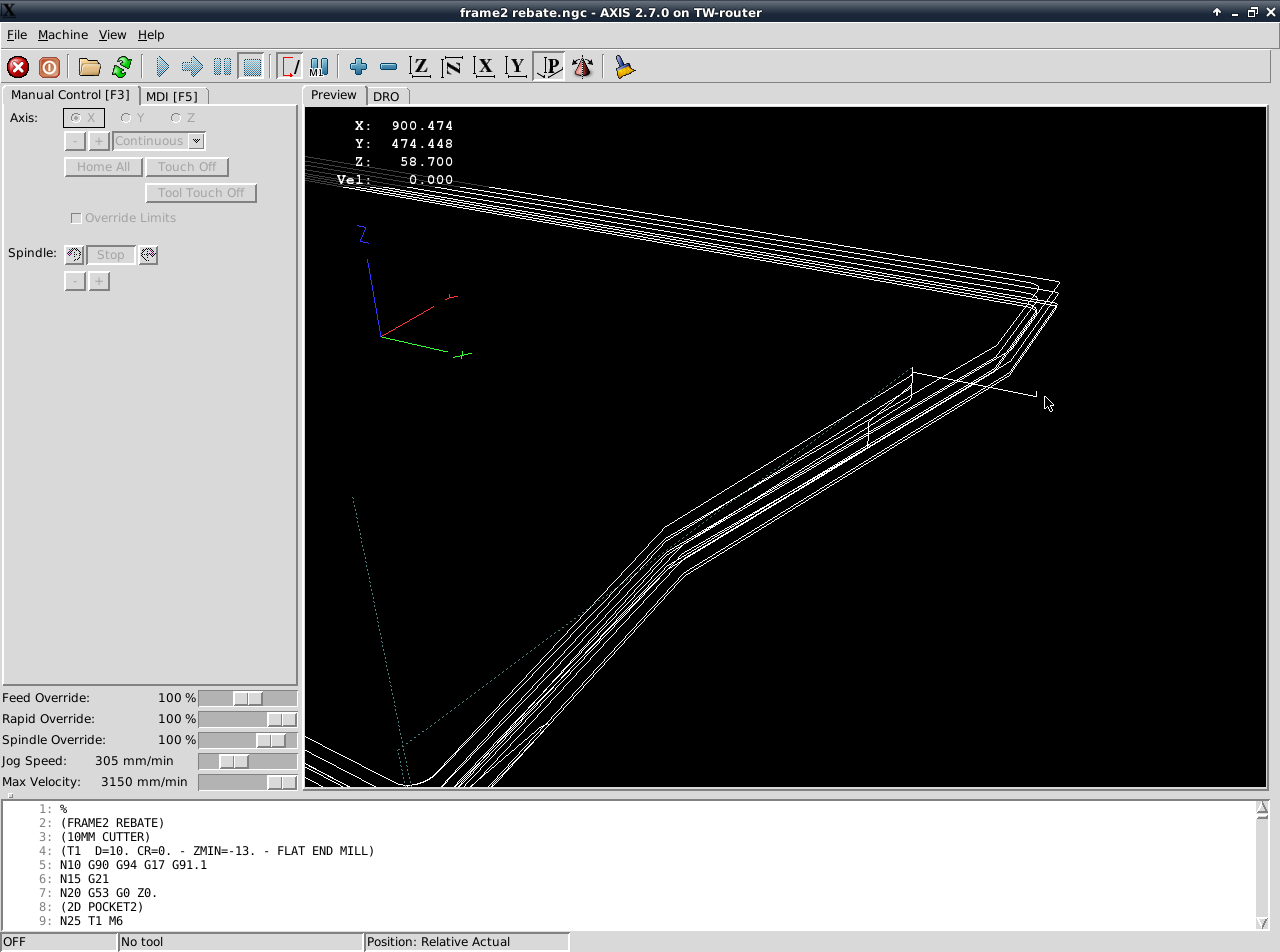

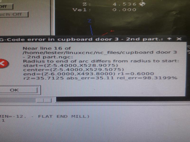

09 Jun 2020 07:49 #170781
by twatchorn
Replied by twatchorn on topic X origin error when machining
I have done some experimenting today and have noted the following
After starting the Router program, the first time the file is opened you can see an approach tool path starting from the right of the correct start point. (see curser on screenshot1).
If I open the file again it only shows the correct start point (see curser on screenshot2). This is the same if I open the file again.
I only get what you see in screenshot1 if this file is the first file I open after starting the router program.
Screenshot3 shows what happens I start machining process of screenshot1. The tool travels toward the correct start point then the display quickly moves to wrong start point at the right, but the machine does NOT travel for the portion shown in yellow (at curser). This is where the 35mm X axis off set is coming in as the machine travels back to what is meant to be the correct start point (in this case milling an unwanted groove as it goes!)
Screenshot4 shows the same error showing on a different file. Again if I open the file a second time it opens with only the correct start point.
The files that have shown the radius error respond like the above. If the file is opened the second time the error does not show.
Aciera question
“If you do an MDI command G54 G0 X0 Y0 does the machine move to the right position (in your case the center of the part on the machine table)?”
It is the center of the part when before I start machining.
Once I start machining and I see it is not in the right place and stop the program, if I do G54 G0 X0 Y0 it goes to the center of part on Y and 35mm to the left of center on X.
Aciera question
“Where IS absolute zero (G53) on your machine? Is it in the lower left corner?”
G53 g0 x0 y0 takes head to right hand top corner. But I home to the left hand bottom corner with X home position = -1550 and Y home = -850
Tommylight advice
“Check if you have any offsets active.
Radius error is due to tool being to big for the radius being cut or when starting from an arc.”
The only off sets I can see are to do with height clearance etc
I did try removing the G53 lines on the door file and it made no difference.
Regards
Trevor

Ok so you get an offset of 35mm in X when you do a G54 G0 X0 Y0. This looks very much like an active offset: linuxcnc.org/docs/html/gcode/g-code.html#gcode:g92
When you get the 35mm offset in X after G54 G0 X0 Y0 does the DRO show X 0 or X 35?
Try this: MDI command G54 G0 X0 Y0. If it does not move to the center (ie you get your 35mm offset) do MDI command G92.1 (this removes all G92 Offsets) and try G54 G0 X0 Y0 again.
Note what is happening in the DRO for the X axis does it read 0 or not.
