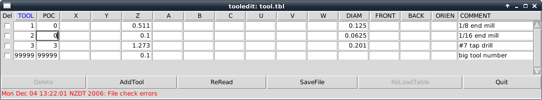

Hi Guys,
We have success. Tool table had 35.707 in column X on tool 1.
When you say ***If you don't use the tool table in your CAM and always use tool1 then the values for tool1 in the tool table inside linuxCNC should be 0.** Which column where you meaning that I would enter 0? I tried 0 in POC for tool 1 and got no errors. If I try changing tool 2 and 3 POC to 0 it shows the error in the attached screenshot.
Have you any idea how I may have got this off set value in the table? It is only in the last few months I have been having the errors.
Hopefully the radius error is fixed now too.

POC is the pocket number of the tool changer and probably has to be a unique number.
What I meant was all the values for XYZABCUWV and Diam should be 0 or blank. That way there is no danger of unwittingly activating an offset by calling a tool. "Comment" is just that, a description of the tool, you can delete that as well.
"FRONT", "BACK" and "ORIENT" are used on lathes so leave those blank as well.
Your english is fine, its also not my native language. Some know some things and others know other things. Glad you got it working.

if tool table and or VAR files are messed just dlete VAR var.bak tbl file they are regenerated at the machine Load
