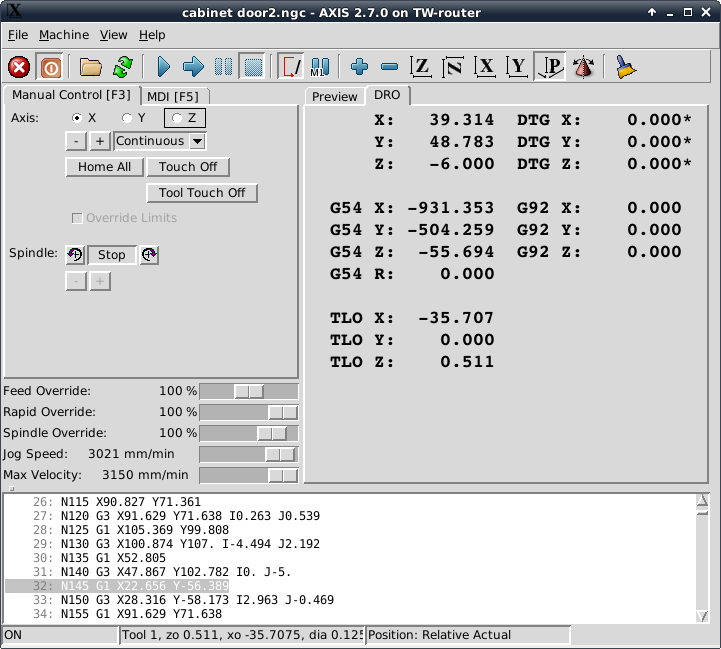

Attached are a few more screenshots. The following is the order of actions before taking each screenshot.
Started Axis program
homed all axis
G54 G0 X0 Y0 to get back to where we had been experimenting
Touched off each axis X Y Z just to be sure.

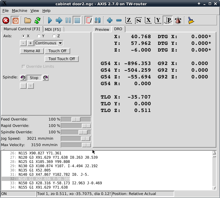

Screenshot F
Started file executing. Machine moved to the wrong start point
Stopped execution after 2nd corner
Screenshot G NOTE the TLO X: -35.707. This is the same value that shows in the bottom of the radius error messages I have been getting.

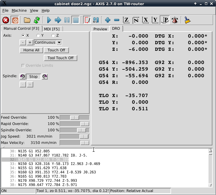

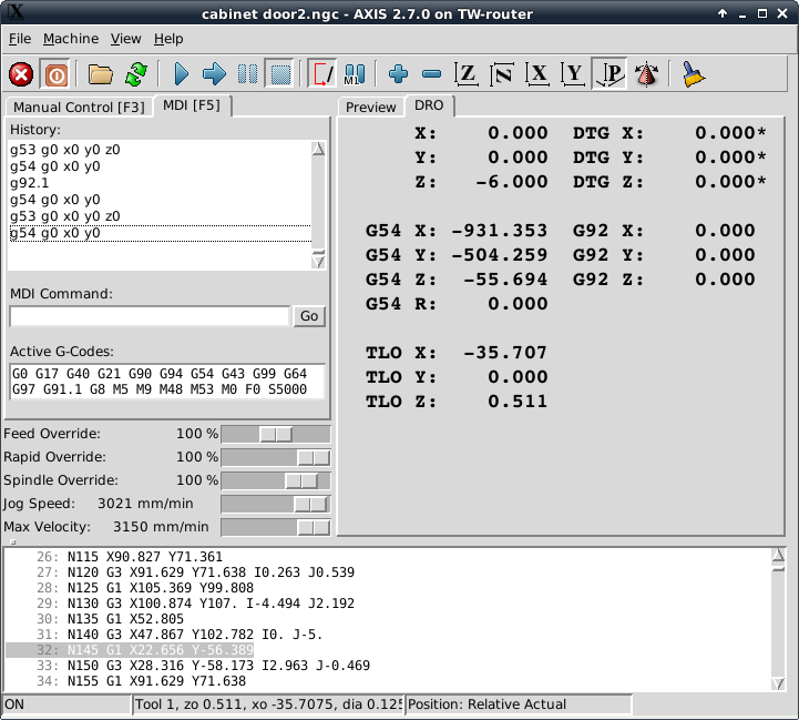

G54 G0 X0 Y0
Screenshot H

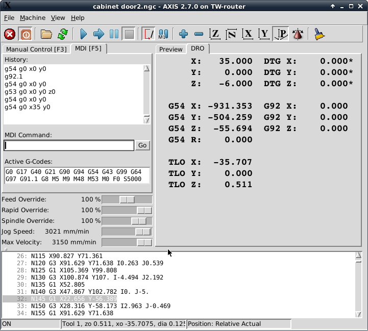

G54 G0 X35 Y0
Screenshot I

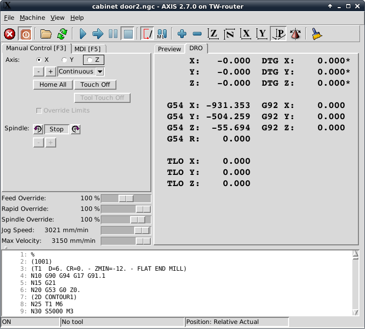

Touch off X
Screenshot J
Opened file again – Display stayed the same as J
Started file executing. Machine moved to the correct start point
Screenshot K (DRO values for all the G54 lines and TLO lines stayed the same)

I dont use the AXIS GUI but the user writes that he has a problem with an offset of 35mm in X that should not be there and, well, i see that tool1 is loaded hith a TLO X of -35.707 in the screenshot.
So I would assume that there is an x-offset in the tool table for that tool and maybe that offset should not be there.
[edit]
Also I see that this tool has a z-offset of 0.511 and a diameter of 0.125 which I think is why he is getting the arc error.
So IMHO the values in the tool table might be the problem.
