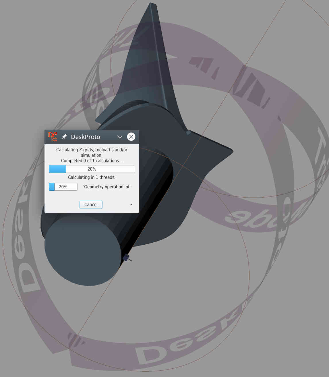

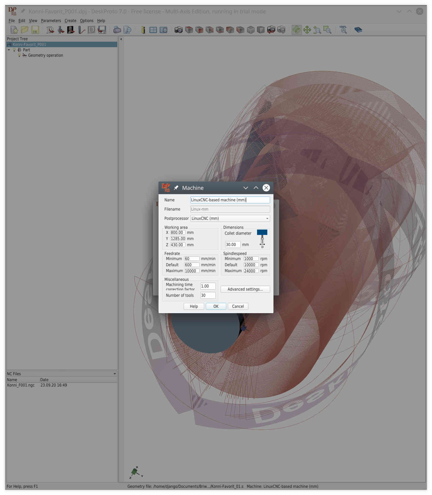

But I could give some feedback. Don't know, which window-toolkit you're using, but some dialogs don't calculate fontmetrics according to used font and fontsize.
I use kde as desktop, where you can change font and fontsize for applications (in system settings) and its possible to scale the desktop.
Here a few screenshots:
This dialog says, that DP uses one thread for calculation of workpaths. Don't know, whether that function can use multiple threads. If so, I did not find the option, where to enable multithreading.

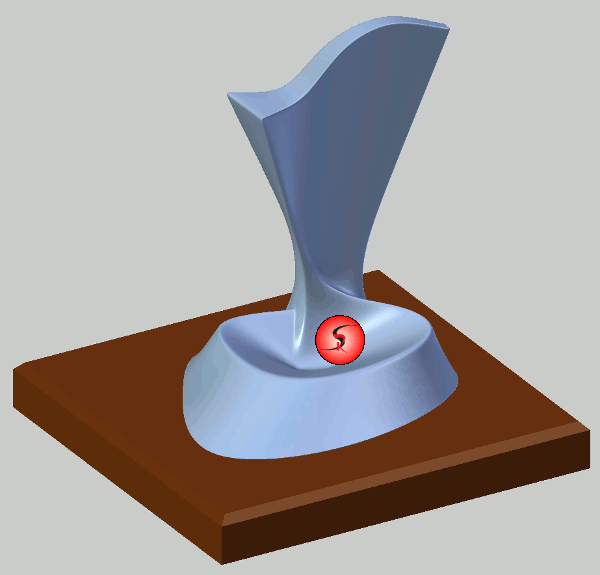

I have a model like this

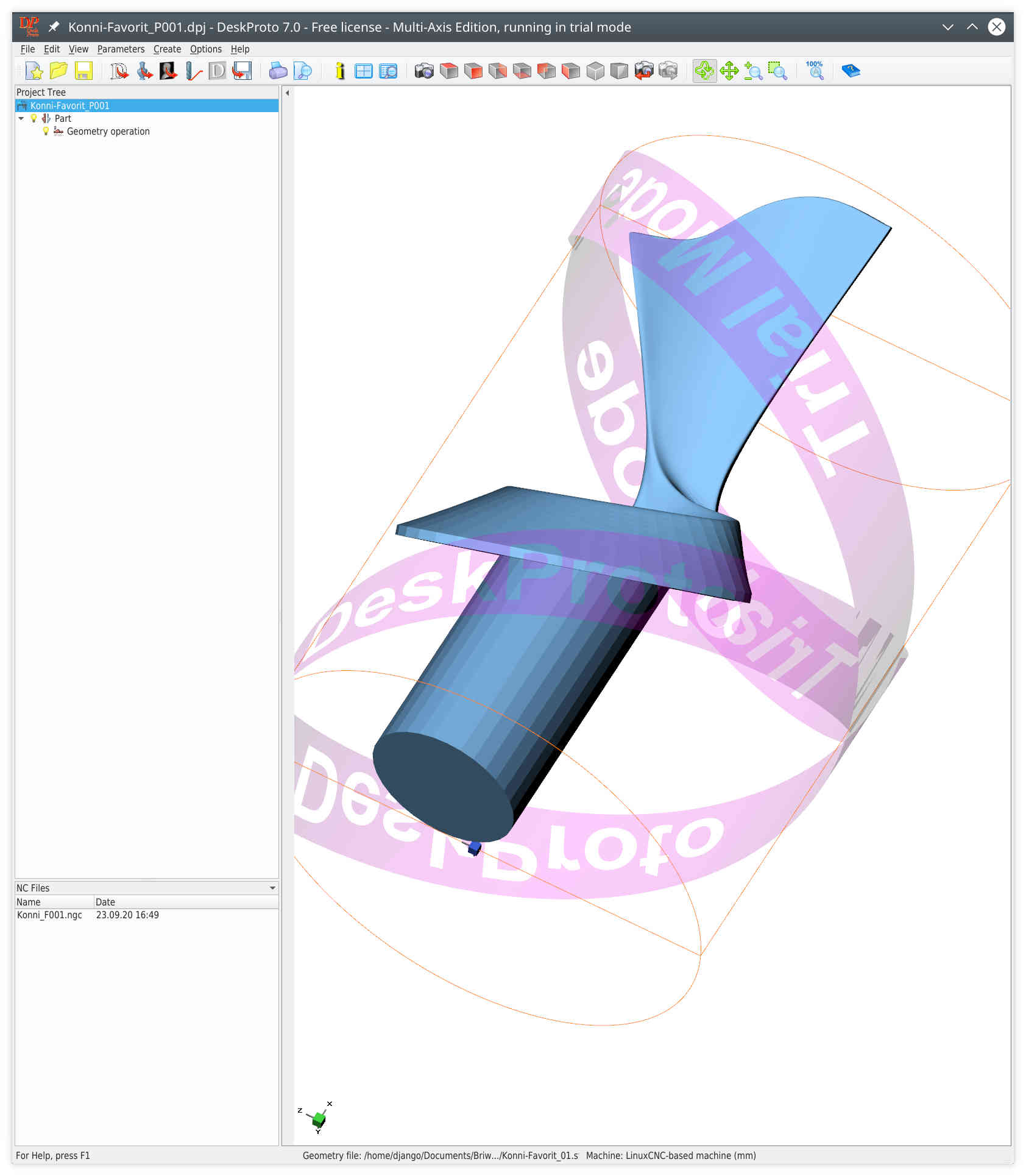

and I added a cylinder for mounting it on a rotary axis like this:
Would be nice, if the cylinder could be selected and taken as rotary axis and workpiece zero. Current options don't allow this - except custom zero point, but that is nothing exact - just a guess.

Except the font size in the user interface: the screenshots show that some dialogs have become quite difficult to understand... We have similar problems on other platforms when a large font is set on a high-res screen. The toolkit that we use is called QT, and the version that we use has a few issues in that area. We plan to use a newer version of QT for the upcoming DeskProto V7.1, and I hope that these problems then will have been solved.
About the multi-threading: DeskProto uses one thread per operation. So when you calculate more operations at the same time it will do so multi-threaded.

For rotary machining DeskProto uses the origin axis as defined in CAD (so the line Y=0 and Z=0). That gives you the option to exactly set the rotation axis (to do so do not use he option "Center geometry"). For more information see the Tips page www.deskproto.com/support-tips-tricks/dp...tion-positioning.php

The model that you show provides a real challenge, when you will indeed machine it I am curious to see the result !

Hm, the best way is change the origin in cad indeed (I use blender for that).

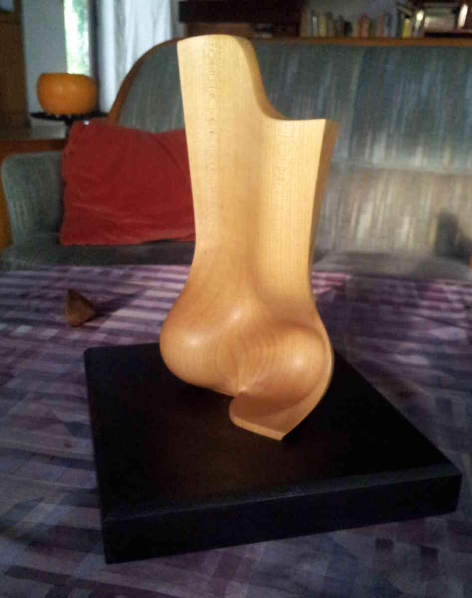

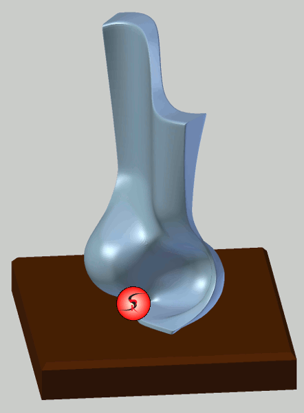

My first model was milled using DP as CAM about 5 years ago. A friend of mine has a mill and he did me a favor :)
The challenge was - stl size of 22Mb - DP stumbled from crash to crash. We had to tweak model to get it worked out. That time, support for rotary axis was only indexed axis (if I remember well).
This is the result:

That's a fine looking piece.

That is a great result !
Would it be OK to post these images on our social media pages ? And if yes, what should I mention as source ?

I model lot of curved surfaces and it was the challenge to create such surfaces in blender. Quite a lot of work, but finally I got it.
So idea and model (both models in this thread) are mine.
Milling happened on a diy-mill build of wood.
... and worth to mention: model came out of milling as is. No grinding.
Just finishing with oil.
