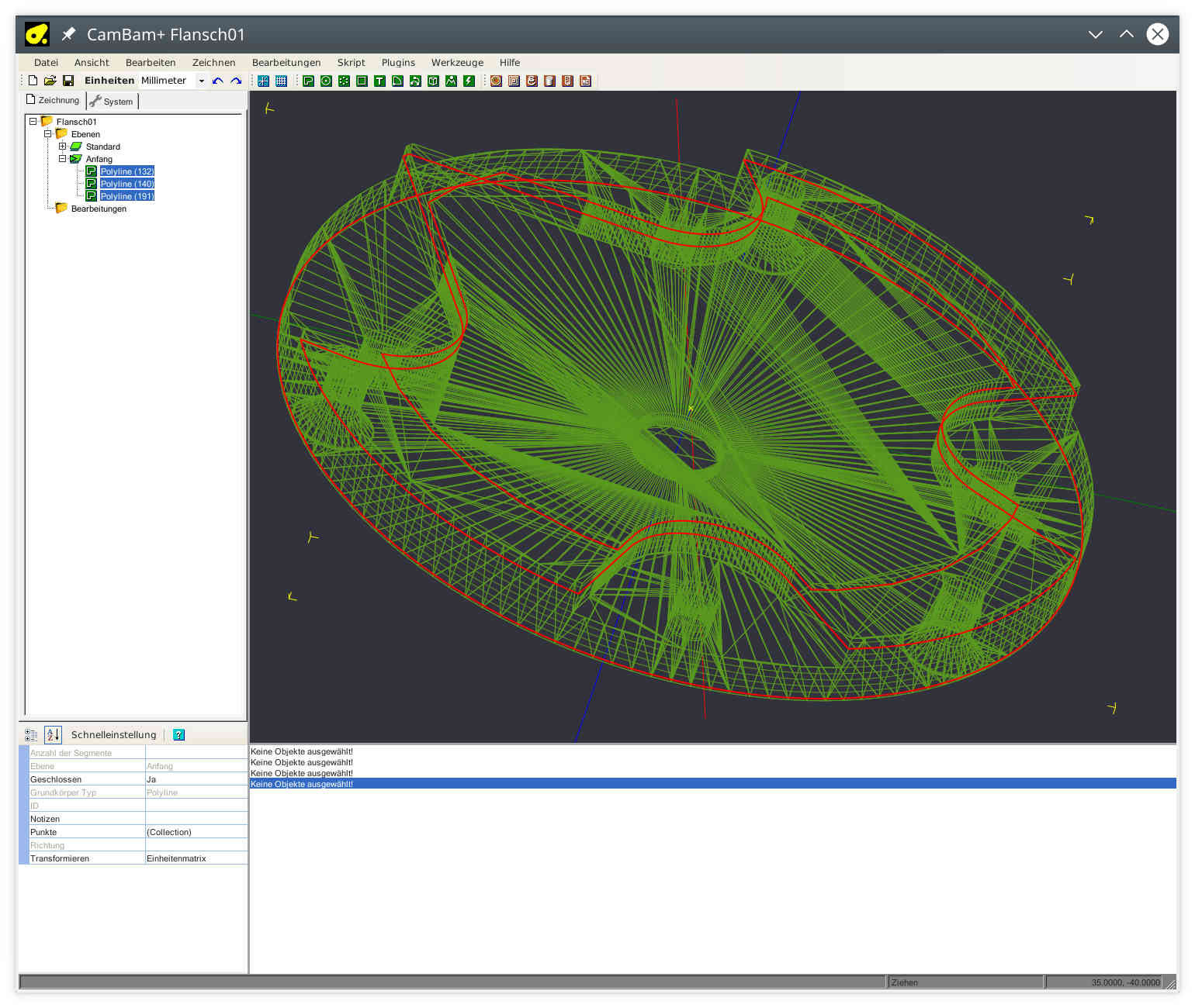

Is that a good STL? It looks strange. I wonder if it has internal surfaces that are confusing the CAM?
Replied by andypugh on topic DeskProto releases free CAM software for Linux.

30 Sep 2020 15:34 #184390
by Reinhard
Its a dualside part, which means, it has to be milled from upside and downside. Blender states some minor errors with 3D-printer check, but prusa slicer processes the file without errors.
If you're interested, I could send you blender file and/or stl.
Cambam gets not confused from the stl.
Replied by Reinhard on topic DeskProto releases free CAM software for Linux.
Hm, should be ok.I wonder if it has internal surfaces that are confusing the CAM?
