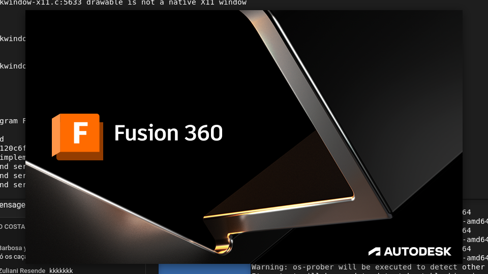

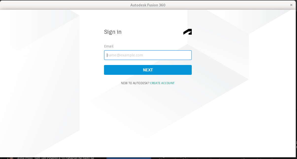

Try Fusion 360 on debian..
snapcraft.io/install/fusion360/debian#install
sudo apt update
sudo apt install snapd
sudo snap install core
[code]sudo snap install fusion360 --beta --devmode
Takes a long time to installAttachments:
