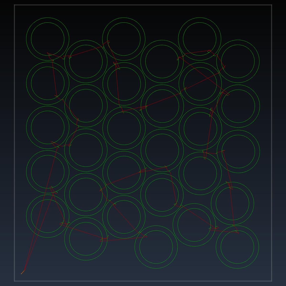

12 May 2021 22:50 #208671
by Joco
Replied by Joco on topic dxf2gcode - plasma enhancements
Proofed my workflow through to CAMotics. Base part done in libreCAD (a super simple part), the dxf pushed through DeepNest to get 30 parts on a sheet. Back into libreCAD to push the parts into a layer named PLASMA. Then into my version of dxf2gcode to create the kerf offset paths with lead-ins and export the gcode. Gcode run through CAMotics to proof behaviour.
Pretty happy so far. The attached image shows the end of the CAMotics simulation with all parts traced. You can just see the small lead-ins to the circles. Yo might need to make it reasonably large.

Sheetcam is free for a few lines of code so it is possible to spit the cuts up into sections then glue it together to make the gcode
Replied by Clive S on topic dxf2gcode - plasma enhancements

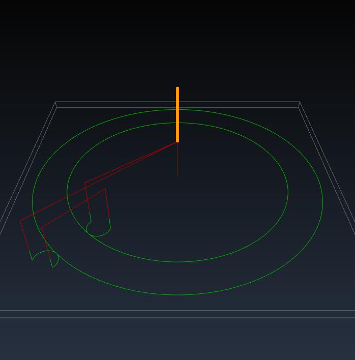

13 May 2021 02:27 #208685
by Joco
I think I might have a basic working model for lead-outs. Attached pic shows post simulation state of a shape with lead-in/outs on an outside and inside cut. All very simple at the moment. Next need to try and take some of the magic out of what is happening as well as allow independent suppression of lead-ins and lead-outs. I might do this via a layer naming setting.
Cheers - J.
Cheers - J.

13 May 2021 10:05 #208719
Replied by tommylight on topic dxf2gcode - plasma enhancements
Nice work, thank you.
Personally, i would skip everything regarding lead outs, it is pretty much useless for plasma cutting and causes a lot of issues when cutting small parts.
