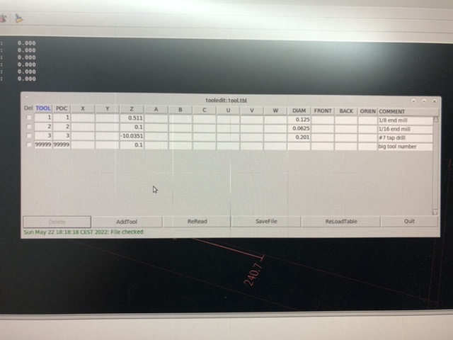

I just did that… and didn’t work.
What did work is when I clicked ‘Tool touch off’
Last edit: 22 May 2022 08:58 by remon_v.

I’m sorry I does work…
I only changed the Z-limit max of the joint and not the axis.
Now I changed both and it works!
Thanks for the help!
Last edit: 22 May 2022 09:19 by remon_v.

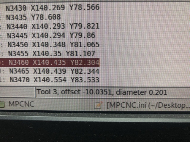

I thought that I answered this.
Fusion has an option to use tool diameter compensation in the CAM or in the controller.
But the tool length is just assumed to be correct, ie Fusion assumes that after a G43 the tool point is at the controlled point.
The tool length data in Fusion is only for the graphics. The tool length data in LinuxCNC is the important one. (and should be set by touch-off or tool-probe, not from measuring the tool)
