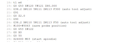

Hello friends ,
I am the user of linux , I alway use it with my cnc machine , before there is not too much problem with 4 axis machine , but now on I start to use it with 5 axis machine , however when the machine process in probe , there is always come out the following words :
emc/task/emctask.cc 321: interp_error: Queue is not empty after probing Queue is not empty after probing
I just wondering is there any friends of linux users can help me ????????? SOS !!!!!!!!!!!!!!!
Thanks a lot !
OJ

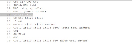

22 Oct 2011 15:30 #14104 by andypugh
Replied by andypugh on topic Re:Problem in probe
What is the actual G-code line that causes the problem?
What are your 5 axes? (XYZAB or something else?)
Can you attach your iNI file (I am wondering if your INI is slightly inconsistent)
I have had a bit of a look at the source code, but I don't really understand C++

24 Oct 2011 14:43 #14171 by ojmcl18
Replied by ojmcl18 on topic Re:Problem in probe
Hello Andypugh,
Here is our G code information and the iNI file , please check the problem for me , thanks !
OJ

24 Oct 2011 19:28 #14185 by andypugh
This doesn't help with the problem (which I can't reproduce) but you might find that the following sequence works better
G0 Z 250 ; retract to safe Z. (Look at G28 and G30 as alternatives)
M6 T1 G43 ; load tool, apply offset.
g53 X100 Y100 ; move in machine coordinates to touch-off plate
G38.2 Z-100 F300 ; rapid probe to (sprung) touch-off plate
G38.4 Z100 F10 ; slow probe off of plate
G10 L10 P1 Z0 ; set the tool table so that the tip of tool 1 is now at Z = 0 in the current system
G43; Apply the new tool length offset.
