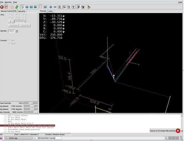

Replied by andypugh on topic Re:Problem in probe
Without your classic ladder and your extra 2 HAL files, it all seems to work OK here. I am certainly not seeing the error message you describe.
You don't seem to have an HALCMD set up, so that isn't pushing things into the motion queue.
How big is the home/emc2/configs/TankOne (or whatever you called it) folder, if you zip it up into one file?

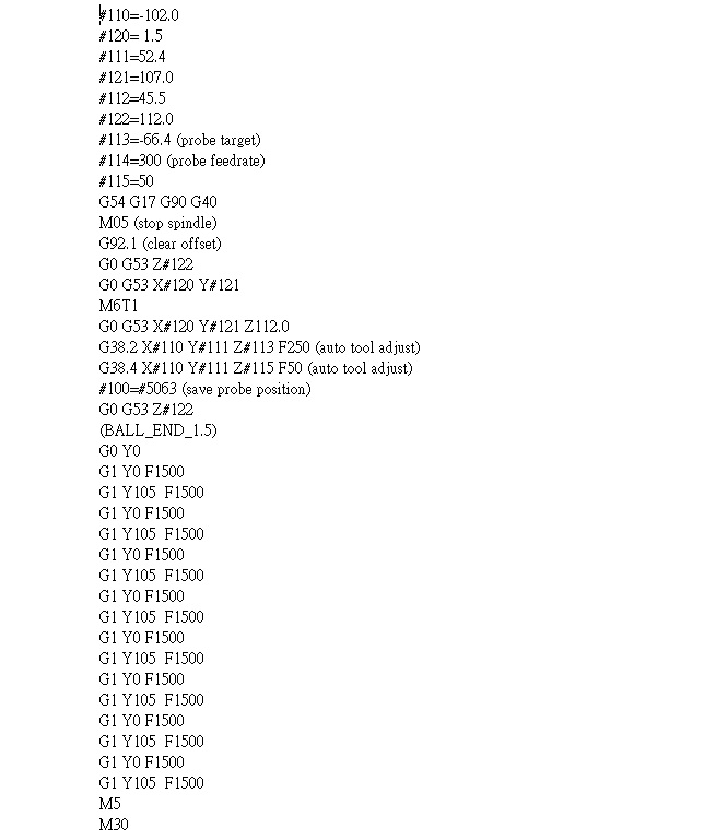

Hello Andy,
After alot of testing and testing , we've got this result , " Queue is not empty after probing "these words will show out quiet often . may be 4 times testing will show out once time . please have a look of the attachments.
OJ
OJ

Please zip the entire config directory up and attach it to your next message using the second button. ("select file to attach" _not_ "select image file to attach")
I am happy to help, but you are not giving us the information we need.
