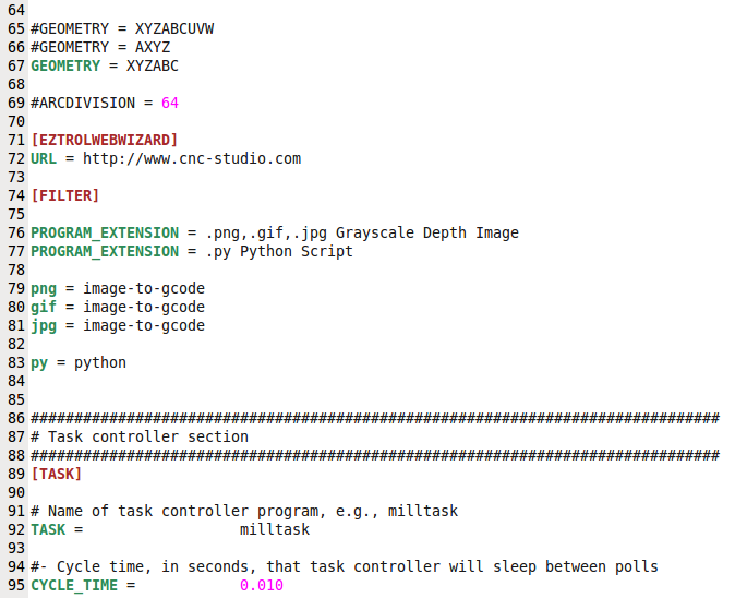

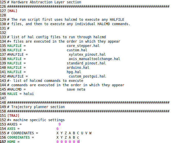

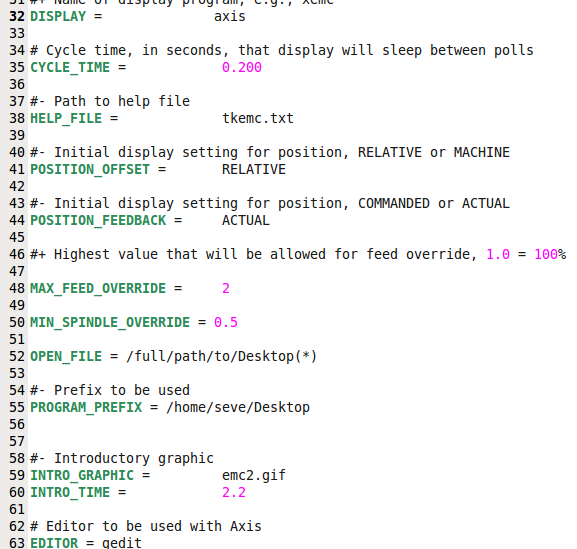

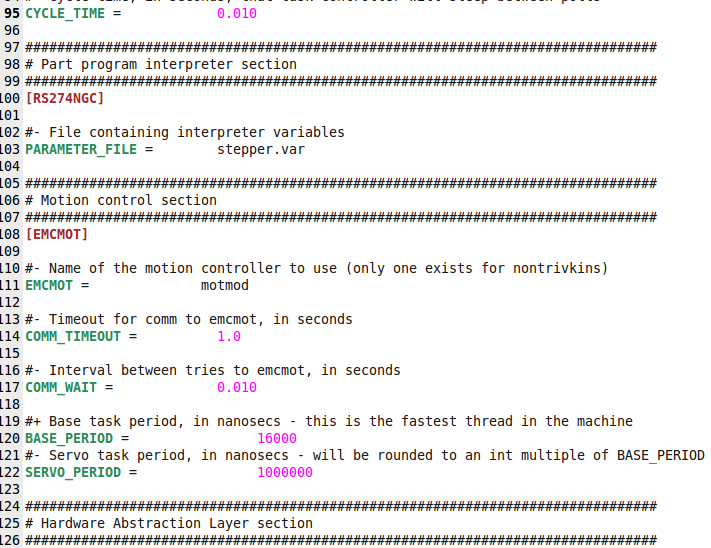

Hi Andy ,
We have sent out 8 pages to you but I've checked for it , only 1 page can sent out to you successfully , why? would you please tell me how to linux sent out the information to you?

An image file of part of the INI file is not a lot of help.
Can't you attach the actual file, from, the home/emc2/configs directory?

Just use the browse button next to [file] and attach the whole file instead of a dozen screen shots...
