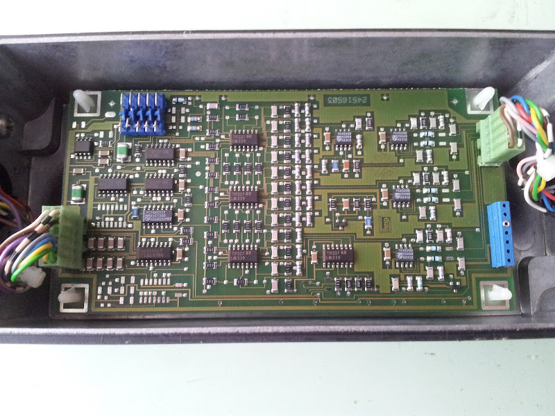

EXE 602E is not a resolver. it is an Interpolation/shaping electronics for the scales, but maybe thats what you meant.
When I read 'resolver' I think of a feedback device sometimes found on ac servo motors.
So I am assuming that the original system used servo drives that used tach feedback and then used the scales as the positional feedback?
Or are you piecing this together your self?

It seems the exe 602E is either none or 5 fold interpolation. easy to check when you have it all hooked up.
I remember when i got the manual for it - there was no mention of how to change it which to me meant you couldn't even though the docs seem to say you can.
You can buy other versions of the EXE that do other interpolation (ebay is your friend)
Andy the EXE converts the scales 11um sine waves to TTL signals so the scales are easy to connect to the 7i29.
Yes, I'll cross that bridge when I get there. However the documentation I have is pretty clear that the interpolation is adjustable. There are jumper blocks in the device. Sadly, thats all I've got.

06 May 2012 08:31 #19871 by cmorley
Replied by cmorley on topic Re:Encoders vs. Tachometers ???
from memory:
look inside the housing you find a flat magnet that can be moved along the length of the scale.
it strengthens the index signal somehow.
if you figure out how to adjust the 602 please let me know - I had the manual for it and it didn't say how.
