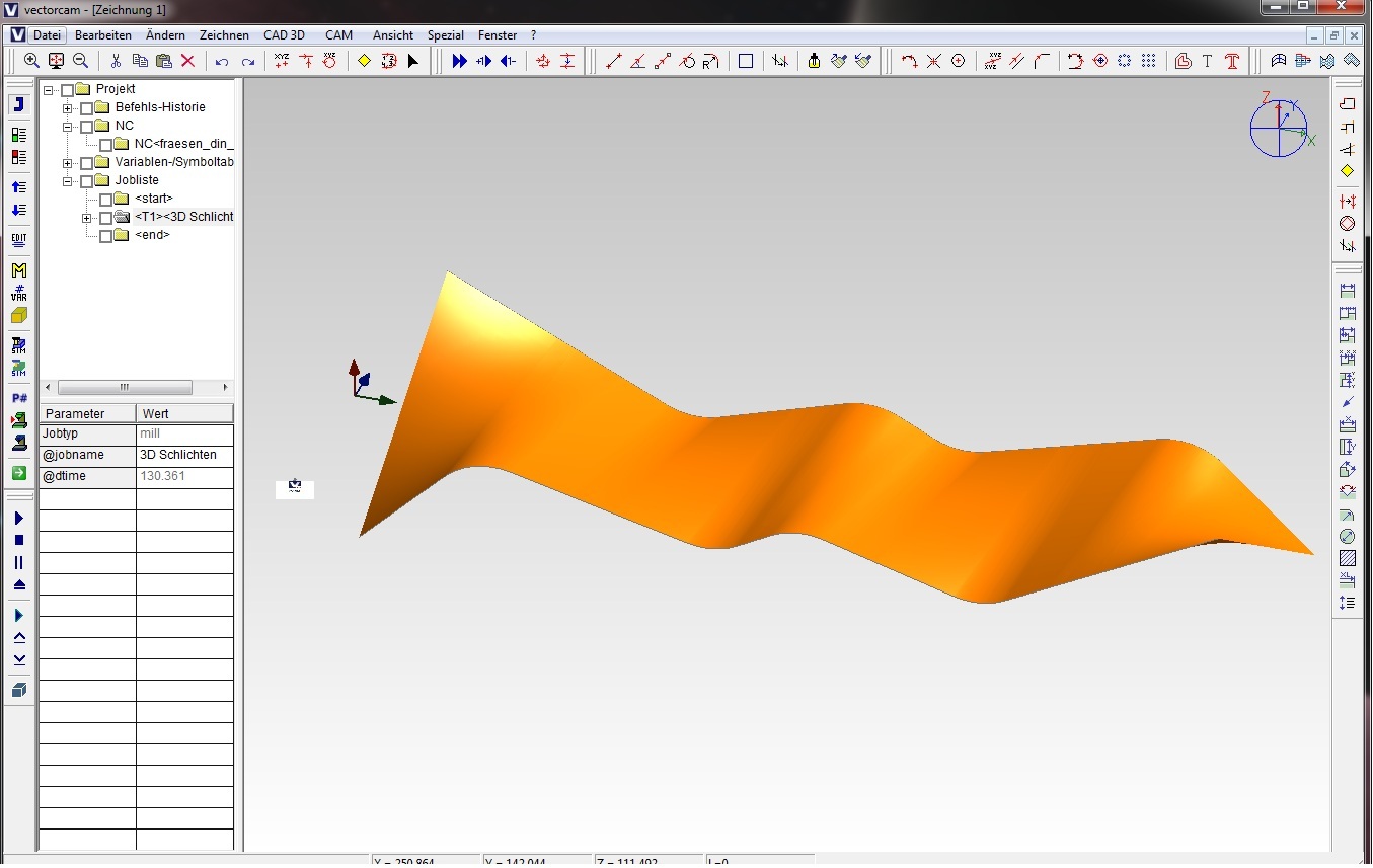

The "Standard G-Code Postprocessor" outputs G-Code ...
I checked the G-Code interpreter of Linux CNC, and it looks very good at all. There are just some little changes to be done to make it compatible to compete with the Big ones like Fanuc, Siemens, Heidenhain...
The Problem is just that nearly any CAM-Software has a little "difference" in its output.
It starts from Circle-Center Coordinates (some choose Relative , some Absolute) continues with Different behavior for Toolchanges etc. and doesnt Stop with things like different Program Head and ending- Sections...
Actually that is no Problem at all... you cam ask the CAM-Software Builders to modify your Postprocessor. But nothing works without Money, and some Times you can Pay several Thousand Euros, just for an optimized Postprocessor for your machine.
I will attach some Sample Data of an unchanged Postprocessor... its just the finishing Step of a fantasy Surface.

Linuxcnc is based on Fanuc , so has no problem with cam systems . I use it with the likes of Solidcam / Camworks Hsmworks , and of course theirs many more
theirs no actual standard for NC controls hence why theirs so much out there , every vendor adds his own methods
