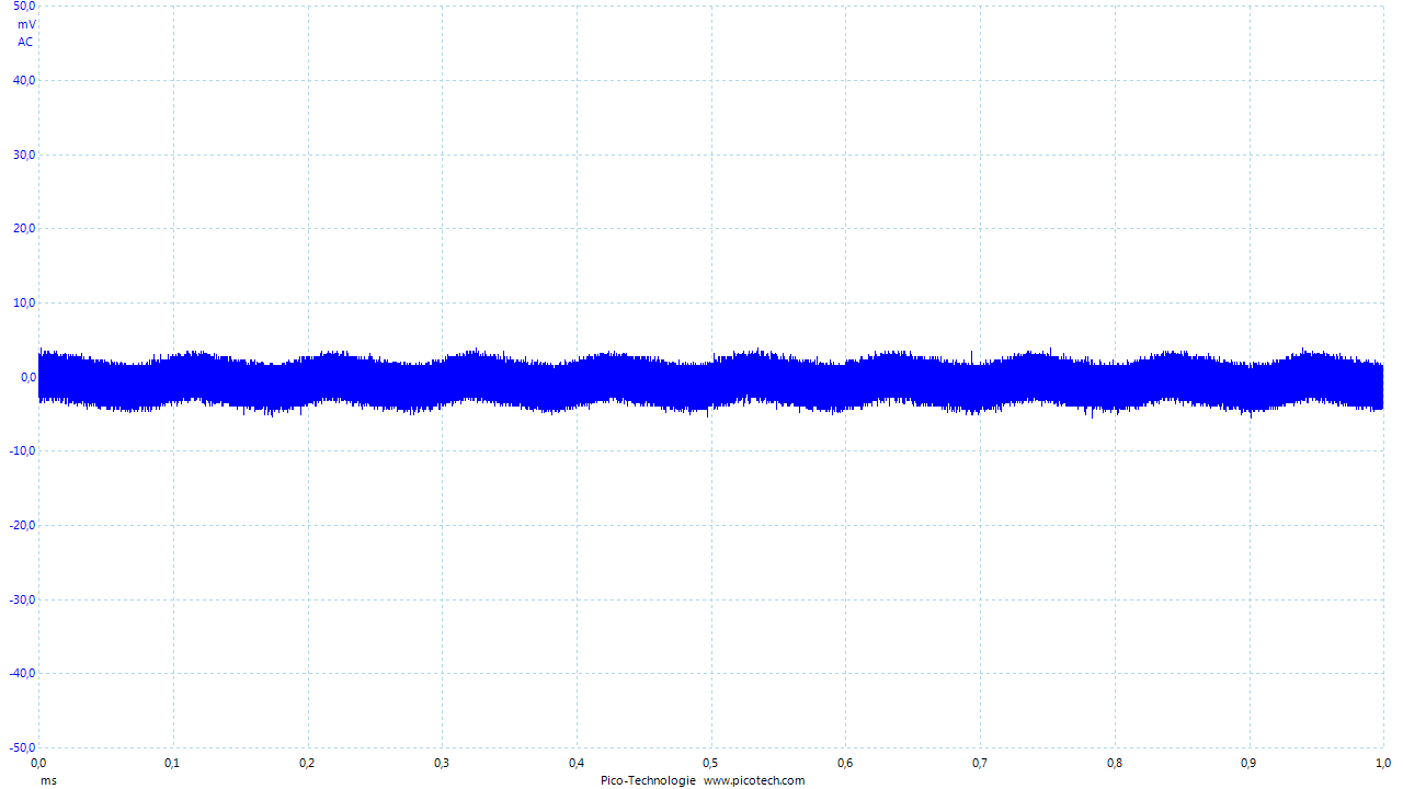

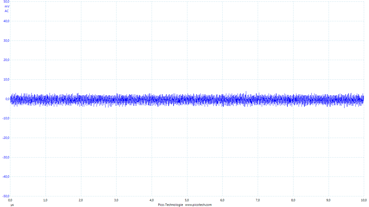

29 Aug 2013 21:15 - 29 Aug 2013 21:17 #38223
by simon n.
Replied by simon n. on topic CNC Machine with Resolver (7i49)
Last edit: 29 Aug 2013 21:17 by simon n..
- Posts: 19089
- Thank you received: 5267
29 Aug 2013 21:36 #38224
Replied by PCW on topic CNC Machine with Resolver (7i49)
The outputs will be close to 0 at null positions so you need to rotate the
shaft while watching the 'scope to see if the outputs make sense
In any case the outputs have much too low an amplitude to be useful as is.
(is the resolver error pin set?)
It might be fixable by using a gain of ~100 preamp (or hacking the 7I49 to change its input amp gains), but this is just guessing...
- Posts: 23475
- Thank you received: 4994
30 Aug 2013 05:01 #38231
You might need to be a bit careful with the Picoscope, as it shares a ground with the PC. (though I don't know if that affects output voltage measurement).
Replied by andypugh on topic CNC Machine with Resolver (7i49)
