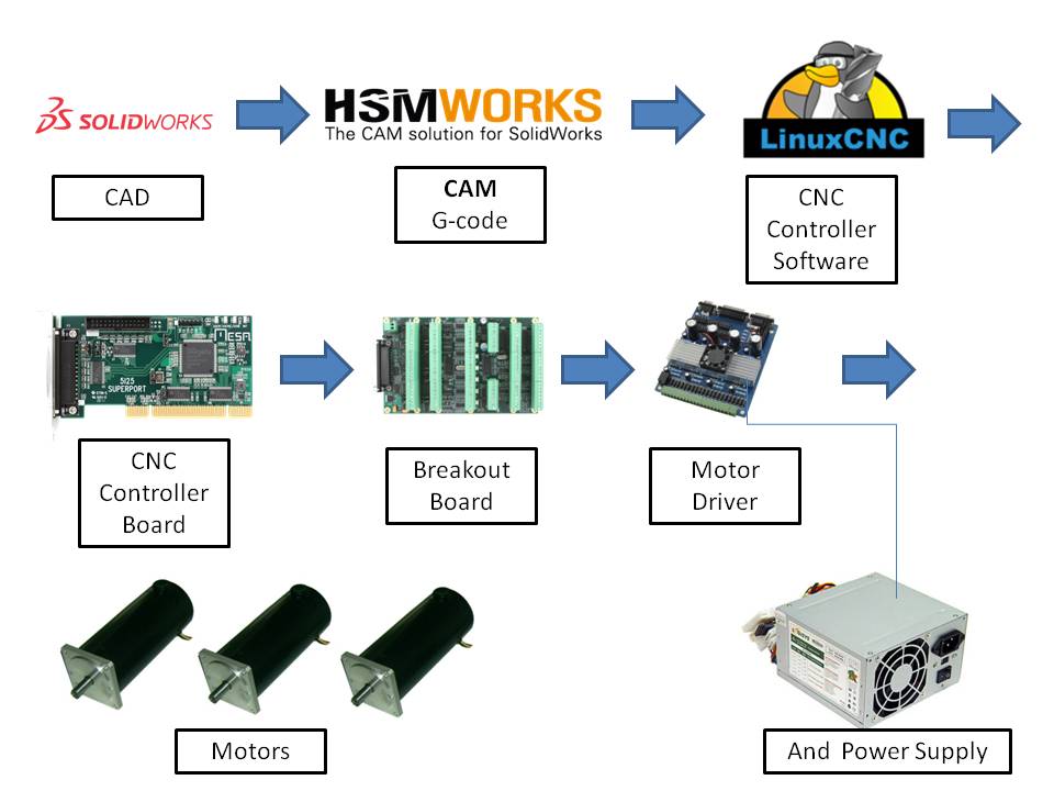

07 Nov 2013 14:48 - 07 Nov 2013 14:49 #40621
by willysnowman
Replied by willysnowman on topic Time to jump in the water.....
Last edit: 07 Nov 2013 14:49 by willysnowman. Reason: added pic

yes you have that correct Bill ,
but just to clarify a few points , the breakout board for steppers is a 7I76 and for servos is a 7I77
if i may suggest go for Leadshine stepperdrivers or geko's ) rather than the all in one chinese drives , far more reliable
and of course you dont have the problem if one drive packs up they all do ! .
it actually makes it easier to setup and control .
if you use these across the board it will make it easier to swap out in times ( hopefully not ) of any problems
also go for the drives and power supplys capable of 48v - 60v rather than the 12 - 24v range
and where needed a 12 - 24v supply for contactors or low volts relay switching
p.s glad your using solidworks ! , i have hsmworks also
although i tend to use camworks more often
Dave
