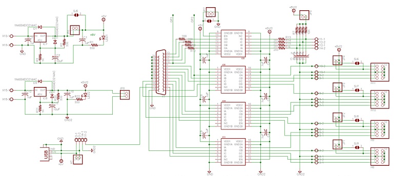

This document says 'The ProboStep is negative logic. The STEP lines should be inverted in your
software.'
It also says:
'Minimum pulse width for the step pulse is 5 uS'.
Make sure you set that too (5us = 5000ns)
Also, do you need/have a 'logic supply regulator' on those drives? I don;t think so, but I am not familiar with the Probotix products.

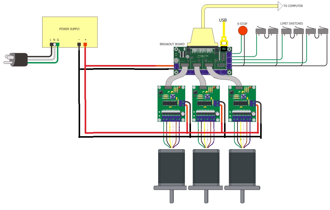

31 Jan 2014 05:20 #43351 by lledee
Replied by lledee on topic Dell Optiplex 745, test axis fails!
How did you reply like that? breaking down my response into sections...
From what I've read and if you look at the schematics you can apply power to the individual drivers from the breakout.
I've wired everything as shown in the picture attached. the only difference is i don't have any of the interrupts hooked up and i don't have the ground block.
From what I can tell there is two supplys powering the breakout, the pc side and the driver side. The driver side has a regulator that shares power via a jumper for each axis through the jumper cables to each axis. This is what I've done and the lights come on for each Axis. I think you hit the spot with the inverted signals...
FYI on the each driver board there is a spot that a regulator can provide logic power but there is no regulator soldered onto them, and i don't think it's so necessary also.
So for future reference, will the limit switches and the e-stop button work with the SPP Settings?

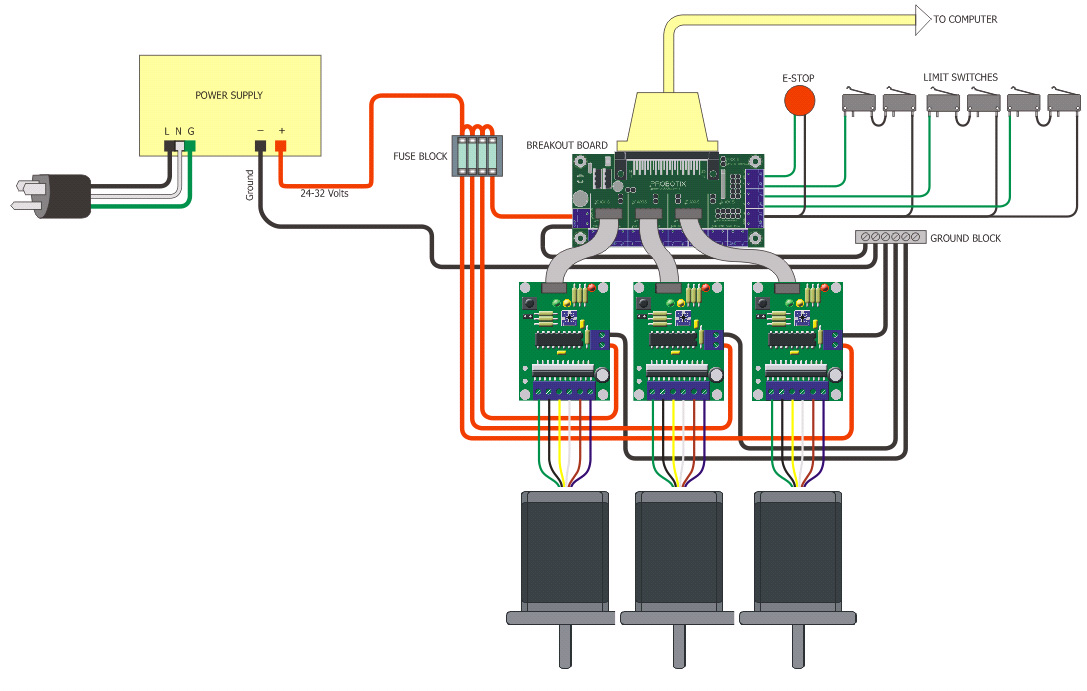

31 Jan 2014 06:17 #43354 by DaBit
Replied by DaBit on topic Dell Optiplex 745, test axis fails!
Using multiple [ quote ] and [ /quote ] sections in the reply.
I suppose you did connect all the GND wires in a star?
(since you seem to be able to read schematics, I think you did)

If you are a little confident with electronics: what happens if you pulse the steppers manually by touching a jumper wire between the appropriate step-pin on the LPT and the +5V or GND coming from the USB?
31 Jan 2014 07:53 #43359 by lledee
I just paralleled everything coming from the supply!
I am not sure. Normally the motors should also move with the step inverted.
Everything is working now!

31 Jan 2014 15:42 - 31 Jan 2014 15:43 #43361 by DaBit
As long as 'parallelled' means that you run separate wires to the power supply (for both power and ground) instead of a daisy-chain, its OK. Don't do the power supply -> drive #1 - drive #2 -> drive #3 routing of the cabling.
Whether you set the port in the BIOS to SPP, EPP or ECP should not matter. EPP/ECP has extra capabilities, but it is still backwards compatible. If the software doesn't use the extra functionality (data transport basically, getting blocks of bytes from A to B) it should not make a difference.

31 Jan 2014 23:46 #43375 by lledee
WRONG, the drawing is all wrong! what i said in the post was right, what i drew in the picture was wrong!!!!!!!!!!!!!!!! :silly: :silly: :silly:
