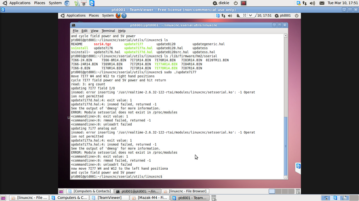

Replied by PCW on topic 2.7
I found a mistake in the ssinstall script ("bin" instead on "lib" in the path)
can you download sserial.zip, unzip it and retry installing the firmware
with sudo ./ssinstall
then re-try the update script

10 Mar 2015 22:31 #56629
by Diederik
Replied by Diederik on topic 2.7
I managed the following:
ptd001@ptd001:~/linuxcnc/sserial/utils/linuxcnc$ sudo ./ssinstall
installing ss firmware files:

ptd001@ptd001:~/linuxcnc/sserial/utils/linuxcnc$ sudo ./update7i77
[sudo] password for ptd001:
move 7I77 W4 and W12 to right hand positions
cycle 7I77 field power and 5V power and hit return
read: 3: arg count
updating 7I77 field I/O
insmod: error inserting '/usr/realtime-2.6.32-122-rtai/modules/linuxcnc/setsserial.ko': -1 Operation not permitted
update7i77d.hal:4: exit value: 1
update7i77d.hal:4: insmod failed, returned -1
See the output of 'dmesg' for more information.
ERROR: Module setsserial does not exist in /proc/modules

10 Mar 2015 22:43 - 10 Mar 2015 22:45 #56633
The .BIN files are firmware files for remote I/o devices, it makes no sense to execute them
first check if the .BIN files were installed with
ls /lib/firmware/hm2/sserial
then rerun the update7i77 script
also the tail end of the kernel log may give more useful error messages
dmesg prints the kernel log

- Diederik
- Posts: 213
10 Mar 2015 22:49 - 10 Mar 2015 22:52 #56634
by Diederik
Last edit: 10 Mar 2015 22:52 by Diederik.

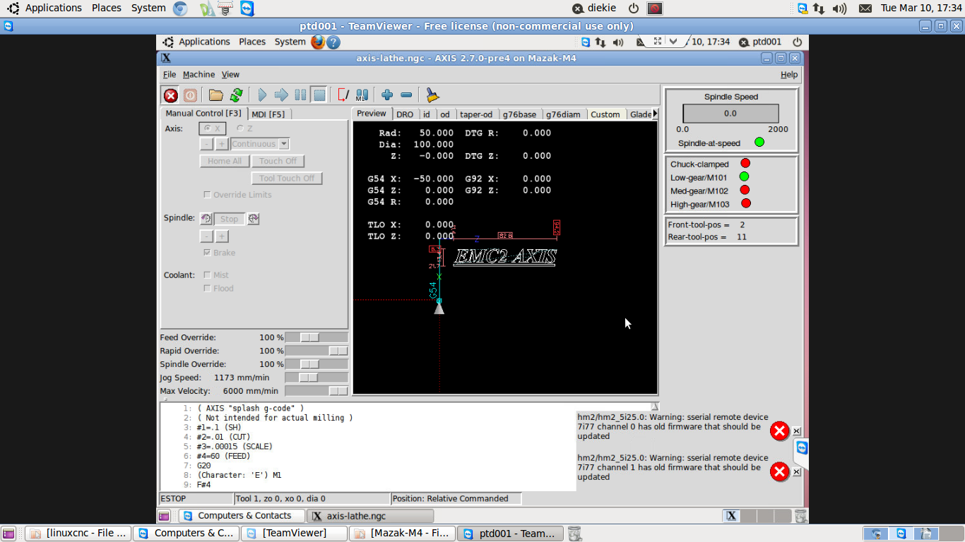

- Posts: 18829
- Thank you received: 5200
10 Mar 2015 22:57 - 10 Mar 2015 23:05 #56635
Can you post the end of the kernel log here?
Also are you trying to run the script with linuxcnc already running?
I just tested with 2.7 here and it worked without complaint
Last edit: 10 Mar 2015 23:05 by PCW.

- Posts: 213
10 Mar 2015 23:09 - 10 Mar 2015 23:16 #56636
by Diederik
I can't view this, not sure if this is the log you want:
Mar 10 17:33:55 ptd001 kernel: [ 42.820192] hm2/hm2_5i25.0: registered
Mar 10 17:33:55 ptd001 kernel: [ 42.820198] hm2_5i25.0: initialized AnyIO board at 0000:02:0d.0
Mar 10 17:33:55 ptd001 kernel: [ 42.860658] hm2/hm2_5i25.0: The hm2 pet_watchdog function is no longer needed.

Mar 10 17:41:39 ptd001 kernel: [ 507.063998] flash command
Mar 10 17:41:39 ptd001 kernel: [ 507.064007] SSLBP Version must be at least v34. This firmware has v33
Mar 10 17:41:39 ptd001 kernel: [ 507.064012] Firmware Flash Failed

Mar 10 17:41:41 ptd001 kernel: [ 508.231862] hm2/hm2_5i25.0: IO Pin 004 (P3-03): Smart Serial Interface #0, pin RxData1 (Input)
Mar 10 17:41:41 ptd001 kernel: [ 508.231870] hm2/hm2_5i25.0: IO Pin 005 (P3-16): Smart Serial Interface #0, pin TxData0 (Output)
Mar 10 17:41:41 ptd001 kernel: [ 508.231878] hm2/hm2_5i25.0: IO Pin 006 (P3-04): Smart Serial Interface #0, pin RxData0 (Input)
Mar 10 17:41:41 ptd001 kernel: [ 508.231886] hm2/hm2_5i25.0: IO Pin 007 (P3-17): Muxed Encoder Select #0, pin Mux Select 0 (Output)
Mar 10 17:41:41 ptd001 kernel: [ 508.231894] hm2/hm2_5i25.0: IO Pin 008 (P3-05): Muxed Encoder #0, pin Muxed A (Input)
Mar 10 17:41:41 ptd001 kernel: [ 508.231901] hm2/hm2_5i25.0: IO Pin 009 (P3-06): Muxed Encoder #0, pin Muxed B (Input)
Mar 10 17:41:41 ptd001 kernel: [ 508.231909] hm2/hm2_5i25.0: IO Pin 010 (P3-07): Muxed Encoder #0, pin Muxed Index (Input)
Mar 10 17:41:41 ptd001 kernel: [ 508.231916] hm2/hm2_5i25.0: IO Pin 011 (P3-08): Muxed Encoder #1, pin Muxed A (Input)
Mar 10 17:41:41 ptd001 kernel: [ 508.231924] hm2/hm2_5i25.0: IO Pin 012 (P3-09): Muxed Encoder #1, pin Muxed B (Input)
Mar 10 17:41:41 ptd001 kernel: [ 508.231931] hm2/hm2_5i25.0: IO Pin 013 (P3-10): Muxed Encoder #1, pin Muxed Index (Input)
Mar 10 17:41:41 ptd001 kernel: [ 508.231938] hm2/hm2_5i25.0: IO Pin 014 (P3-11): Muxed Encoder #2, pin Muxed A (Input)
Mar 10 17:41:41 ptd001 kernel: [ 508.231946] hm2/hm2_5i25.0: IO Pin 015 (P3-12): Muxed Encoder #2, pin Muxed B (Input)
Mar 10 17:41:41 ptd001 kernel: [ 508.231953] hm2/hm2_5i25.0: IO Pin 016 (P3-13): Muxed Encoder #2, pin Muxed Index (Input)
Mar 10 17:41:41 ptd001 kernel: [ 508.231960] hm2/hm2_5i25.0: IO Pin 017 (P2-01): Smart Serial Interface #0, pin TxEn5 (Output)
Mar 10 17:41:41 ptd001 kernel: [ 508.231968] hm2/hm2_5i25.0: IO Pin 018 (P2-14): Smart Serial Interface #0, pin TxData5 (Output)
Mar 10 17:41:41 ptd001 kernel: [ 508.231976] hm2/hm2_5i25.0: IO Pin 019 (P2-02): Smart Serial Interface #0, pin RxData5 (Input)
Mar 10 17:41:41 ptd001 kernel: [ 508.231983] hm2/hm2_5i25.0: IO Pin 020 (P2-15): Smart Serial Interface #0, pin TxData4 (Output)
Mar 10 17:41:41 ptd001 kernel: [ 508.231991] hm2/hm2_5i25.0: IO Pin 021 (P2-03): Smart Serial Interface #0, pin RxData4 (Input)
Mar 10 17:41:41 ptd001 kernel: [ 508.231999] hm2/hm2_5i25.0: IO Pin 022 (P2-16): Smart Serial Interface #0, pin TxData3 (Output)
Mar 10 17:41:41 ptd001 kernel: [ 508.232006] hm2/hm2_5i25.0: IO Pin 023 (P2-04): Smart Serial Interface #0, pin RxData3 (Input)
Mar 10 17:41:41 ptd001 kernel: [ 508.232014] hm2/hm2_5i25.0: IO Pin 024 (P2-17): Muxed Encoder Select #3, pin Mux Select 0 (Output)
Mar 10 17:41:41 ptd001 kernel: [ 508.232022] hm2/hm2_5i25.0: IO Pin 025 (P2-05): Muxed Encoder #3, pin Muxed A (Input)
Mar 10 17:41:41 ptd001 kernel: [ 508.232029] hm2/hm2_5i25.0: IO Pin 026 (P2-06): Muxed Encoder #3, pin Muxed B (Input)
Mar 10 17:41:41 ptd001 kernel: [ 508.232036] hm2/hm2_5i25.0: IO Pin 027 (P2-07): Muxed Encoder #3, pin Muxed Index (Input)
Mar 10 17:41:41 ptd001 kernel: [ 508.232044] hm2/hm2_5i25.0: IO Pin 028 (P2-08): Muxed Encoder #4, pin Muxed A (Input)
Mar 10 17:41:41 ptd001 kernel: [ 508.232051] hm2/hm2_5i25.0: IO Pin 029 (P2-09): Muxed Encoder #4, pin Muxed B (Input)
Mar 10 17:41:41 ptd001 kernel: [ 508.232058] hm2/hm2_5i25.0: IO Pin 030 (P2-10): Muxed Encoder #4, pin Muxed Index (Input)
Mar 10 17:41:41 ptd001 kernel: [ 508.232066] hm2/hm2_5i25.0: IO Pin 031 (P2-11): Muxed Encoder #5, pin Muxed A (Input)
Mar 10 17:41:41 ptd001 kernel: [ 508.232073] hm2/hm2_5i25.0: IO Pin 032 (P2-12): Muxed Encoder #5, pin Muxed B (Input)
Mar 10 17:41:41 ptd001 kernel: [ 508.232080] hm2/hm2_5i25.0: IO Pin 033 (P2-13): Muxed Encoder #5, pin Muxed Index (Input)
Mar 10 17:41:41 ptd001 kernel: [ 508.232406] hm2/hm2_5i25.0: registered
Mar 10 17:41:41 ptd001 kernel: [ 508.232412] hm2_5i25.0: initialized AnyIO board at 0000:02:0d.0
Mar 10 17:41:41 ptd001 kernel: [ 508.244695] flash command
Mar 10 17:41:41 ptd001 kernel: [ 508.244705] SSLBP Version must be at least v34. This firmware has v33
Mar 10 17:41:41 ptd001 kernel: [ 508.244710] Firmware Flash Failed
Mar 10 17:41:41 ptd001 kernel: [ 508.297358] hm2_5i25.0: dropping AnyIO board at 0000:02:0d.0
Mar 10 17:41:41 ptd001 kernel: [ 508.297371] hm2/hm2_5i25.0: unregistered
Mar 10 17:41:41 ptd001 kernel: [ 508.297408] pci 0000:00:1e.0: can't derive routing for PCI INT A
Mar 10 17:41:41 ptd001 kernel: [ 508.297459] hm2_pci: driver unloaded
Mar 10 17:41:41 ptd001 kernel: [ 508.303441] hm2: unloading
Mar 10 17:41:41 ptd001 kernel: [ 508.571173] RTAI[math]: unloaded.
Mar 10 17:41:41 ptd001 kernel: [ 508.637049] SCHED releases registered named ALIEN RTGLBH
Mar 10 17:41:41 ptd001 kernel: [ 508.670380] RTAI[malloc]: unloaded.
Mar 10 17:41:41 ptd001 kernel: [ 508.769769] RTAI[sched]: unloaded (forced hard/soft/hard transitions: traps 0, syscalls 0).
Mar 10 17:41:41 ptd001 kernel: [ 508.774088] I-pipe: Domain RTAI unregistered.
Mar 10 17:41:41 ptd001 kernel: [ 508.774168] RTAI[hal]: unmounted.

Mar 10 17:47:46 ptd001 kernel: [ 873.614836] hm2/hm2_5i25.0: Smart Serial Firmware Version 33
Mar 10 17:47:46 ptd001 kernel: [ 873.614847] hm2/hm2_5i25.0: Setting baudrate is not supported in the current firmware version
Mar 10 17:47:46 ptd001 kernel: [ 873.614850] Version must be > v33 and you have version 33.Setup mode
Mar 10 17:47:46 ptd001 kernel: [ 873.669803] found a 7I77§

Mar 10 17:47:46 ptd001 kernel: [ 873.730410] hm2/hm2_5i25.0: Warning: sserial remote device 7i77 channel 0 has old firmware that should be updated
Mar 10 17:47:47 ptd001 kernel: [ 873.742099] Board hm2_5i25.0.7i77.0.1 Hardware Mode 0 = standard
Mar 10 17:47:47 ptd001 kernel: [ 873.743833] Board hm2_5i25.0.7i77.0.1 Software Mode 0 = analogout_enables
Mar 10 17:47:47 ptd001 kernel: [ 873.773113] hm2/hm2_5i25.0: Warning: sserial remote device 7i77 channel 1 has old firmware that should be updated

Mar 10 17:47:47 ptd001 kernel: [ 873.850417] flash command
Mar 10 17:47:47 ptd001 kernel: [ 873.850426] SSLBP Version must be at least v34. This firmware has v33
Mar 10 17:47:47 ptd001 kernel: [ 873.850431] Firmware Flash Failed
Mar 10 17:47:47 ptd001 kernel: [ 873.889300] hm2_5i25.0: dropping AnyIO board at 0000:02:0d.0
Mar 10 17:47:47 ptd001 kernel: [ 873.889313] hm2/hm2_5i25.0: unregistered
Mar 10 17:47:47 ptd001 kernel: [ 873.889347] pci 0000:00:1e.0: can't derive routing for PCI INT A

Mar 10 17:41:40 ptd001 kernel: [ 508.004611] hm2/hm2_5i25.0: Setting baudrate is not supported in the current firmware version
Mar 10 17:41:40 ptd001 kernel: [ 508.004614] Version must be > v33 and you have version 33.Setup mode
Mar 10 17:41:40 ptd001 kernel: [ 508.059564] found a 7I77§

Mar 10 17:41:40 ptd001 kernel: [ 508.059629] hm2/hm2_5i25.0: Unable to check for 8i20s with firmware < 37 If you are not trying to reflash an 8i20 then ignore this message.
Mar 10 17:41:40 ptd001 kernel: [ 508.059638] Setup mode
Mar 10 17:41:40 ptd001 kernel: [ 508.059667] Looking for 8i20s, crc_addr = 30
Mar 10 17:41:40 ptd001 kernel: [ 508.059685] hm2/hm2_5i25.0: Unable to check for 8i20s with firmware < 37 If you are not trying to reflash an 8i20 then ignore this message.

Mar 10 17:41:40 ptd001 kernel: [ 508.119876] hm2/hm2_5i25.0: Warning: sserial remote device 7i77 channel 0 has old firmware that should be updated
Mar 10 17:41:41 ptd001 kernel: [ 508.131283] Board hm2_5i25.0.7i77.0.1 Hardware Mode 0 = standard
Mar 10 17:41:41 ptd001 kernel: [ 508.133012] Board hm2_5i25.0.7i77.0.1 Software Mode 0 = analogout_enables
Mar 10 17:41:41 ptd001 kernel: [ 508.162260] hm2/hm2_5i25.0: Warning: sserial remote device 7i77 channel 1 has old firmware that should be updated

Mar 10 17:47:46 ptd001 kernel: [ 873.669924] hm2/hm2_5i25.0: Unable to check for 8i20s with firmware < 37 If you are not trying to reflash an 8i20 then ignore this message.
Mar 10 17:47:46 ptd001 kernel: [ 873.669933] Setup mode
Mar 10 17:47:46 ptd001 kernel: [ 873.669962] Looking for 8i20s, crc_addr = 30
Mar 10 17:47:46 ptd001 kernel: [ 873.669980] hm2/hm2_5i25.0: Unable to check for 8i20s with firmware < 37 If you are not trying to reflash an 8i20 then ignore this message.
Mar 10 17:47:46 ptd001 kernel: [ 873.669989] Setup mode
Mar 10 17:47:46 ptd001 kernel: [ 873.670018] Looking for 8i20s, crc_addr = 30
Mar 10 17:47:46 ptd001 kernel: [ 873.670036] hm2/hm2_5i25.0: Unable to check for 8i20s with firmware < 37 If you are not trying to reflash an 8i20 then ignore this message.
Mar 10 17:47:46 ptd001 kernel: [ 873.671587] Board hm2_5i25.0.7i77.0.0 Hardware Mode 0 = standard
Mar 10 17:47:46 ptd001 kernel: [ 873.673337] Board hm2_5i25.0.7i77.0.0 Software Mode 0 = input_output
Mar 10 17:47:46 ptd001 kernel: [ 873.674833] Board hm2_5i25.0.7i77.0.0 Software Mode 1 = io_analog
Mar 10 17:47:46 ptd001 kernel: [ 873.677508] Board hm2_5i25.0.7i77.0.0 Software Mode 2 = io_analog_fieldvoltage
Mar 10 17:47:46 ptd001 kernel: [ 873.680893] Board hm2_5i25.0.7i77.0.0 Software Mode 3 = io_encoder_analog_fieldvoltage
Mar 10 17:47:47 ptd001 kernel: [ 873.842743] hm2/hm2_5i25.0: 34 I/O Pins used:
Mar 10 17:47:47 ptd001 kernel: [ 873.842753] hm2/hm2_5i25.0: IO Pin 000 (P3-01): Smart Serial Interface #0, pin TxEn2 (Output)
Mar 10 17:47:47 ptd001 kernel: [ 873.842761] hm2/hm2_5i25.0: IO Pin 001 (P3-14): Smart Serial Interface #0, pin TxData2 (Output)
Mar 10 17:47:47 ptd001 kernel: [ 873.842768] hm2/hm2_5i25.0: IO Pin 002 (P3-02): Smart Serial Interface #0, pin RxData2 (Input)
Mar 10 17:47:47 ptd001 kernel: [ 873.842776] hm2/hm2_5i25.0: IO Pin 003 (P3-15): Smart Serial Interface #0, pin TxData1 (Output)
Mar 10 17:47:47 ptd001 kernel: [ 873.842783] hm2/hm2_5i25.0: IO Pin 004 (P3-03): Smart Serial Interface #0, pin RxData1 (Input)
Mar 10 17:47:47 ptd001 kernel: [ 873.842790] hm2/hm2_5i25.0: IO Pin 005 (P3-16): Smart Serial Interface #0, pin TxData0 (Output)
Mar 10 17:47:47 ptd001 kernel: [ 873.842797] hm2/hm2_5i25.0: IO Pin 006 (P3-04): Smart Serial Interface #0, pin RxData0 (Input)
Mar 10 17:47:47 ptd001 kernel: [ 873.842805] hm2/hm2_5i25.0: IO Pin 007 (P3-17): Muxed Encoder Select #0, pin Mux Select 0 (Output)
Mar 10 17:47:47 ptd001 kernel: [ 873.842812] hm2/hm2_5i25.0: IO Pin 008 (P3-05): Muxed Encoder #0, pin Muxed A (Input)
Mar 10 17:47:47 ptd001 kernel: [ 873.842819] hm2/hm2_5i25.0: IO Pin 009 (P3-06): Muxed Encoder #0, pin Muxed B (Input)
Mar 10 17:47:47 ptd001 kernel: [ 873.842826] hm2/hm2_5i25.0: IO Pin 010 (P3-07): Muxed Encoder #0, pin Muxed Index (Input)
Mar 10 17:47:47 ptd001 kernel: [ 873.842833] hm2/hm2_5i25.0: IO Pin 011 (P3-08): Muxed Encoder #1, pin Muxed A (Input)
Mar 10 17:47:47 ptd001 kernel: [ 873.842840] hm2/hm2_5i25.0: IO Pin 012 (P3-09): Muxed Encoder #1, pin Muxed B (Input)
Mar 10 17:47:47 ptd001 kernel: [ 873.842847] hm2/hm2_5i25.0: IO Pin 013 (P3-10): Muxed Encoder #1, pin Muxed Index (Input)
Mar 10 17:47:47 ptd001 kernel: [ 873.842854] hm2/hm2_5i25.0: IO Pin 014 (P3-11): Muxed Encoder #2, pin Muxed A (Input)
Mar 10 17:47:47 ptd001 kernel: [ 873.842861] hm2/hm2_5i25.0: IO Pin 015 (P3-12): Muxed Encoder #2, pin Muxed B (Input)
Mar 10 17:47:47 ptd001 kernel: [ 873.842868] hm2/hm2_5i25.0: IO Pin 016 (P3-13): Muxed Encoder #2, pin Muxed Index (Input)
Mar 10 17:47:47 ptd001 kernel: [ 873.842875] hm2/hm2_5i25.0: IO Pin 017 (P2-01): Smart Serial Interface #0, pin TxEn5 (Output)
Mar 10 17:47:47 ptd001 kernel: [ 873.842882] hm2/hm2_5i25.0: IO Pin 018 (P2-14): Smart Serial Interface #0, pin TxData5 (Output)
Mar 10 17:47:47 ptd001 kernel: [ 873.842889] hm2/hm2_5i25.0: IO Pin 019 (P2-02): Smart Serial Interface #0, pin RxData5 (Input)
Mar 10 17:47:47 ptd001 kernel: [ 873.842896] hm2/hm2_5i25.0: IO Pin 020 (P2-15): Smart Serial Interface #0, pin TxData4 (Output)
Mar 10 17:47:47 ptd001 kernel: [ 873.842904] hm2/hm2_5i25.0: IO Pin 021 (P2-03): Smart Serial Interface #0, pin RxData4 (Input)
Mar 10 17:47:47 ptd001 kernel: [ 873.842911] hm2/hm2_5i25.0: IO Pin 022 (P2-16): Smart Serial Interface #0, pin TxData3 (Output)
Mar 10 17:47:47 ptd001 kernel: [ 873.842918] hm2/hm2_5i25.0: IO Pin 023 (P2-04): Smart Serial Interface #0, pin RxData3 (Input)
Mar 10 17:47:47 ptd001 kernel: [ 873.842925] hm2/hm2_5i25.0: IO Pin 024 (P2-17): Muxed Encoder Select #3, pin Mux Select 0 (Output)
Mar 10 17:47:47 ptd001 kernel: [ 873.842933] hm2/hm2_5i25.0: IO Pin 025 (P2-05): Muxed Encoder #3, pin Muxed A (Input)
Mar 10 17:47:47 ptd001 kernel: [ 873.842939] hm2/hm2_5i25.0: IO Pin 026 (P2-06): Muxed Encoder #3, pin Muxed B (Input)
Mar 10 17:47:47 ptd001 kernel: [ 873.842946] hm2/hm2_5i25.0: IO Pin 027 (P2-07): Muxed Encoder #3, pin Muxed Index (Input)
Mar 10 17:47:47 ptd001 kernel: [ 873.842953] hm2/hm2_5i25.0: IO Pin 028 (P2-08): Muxed Encoder #4, pin Muxed A (Input)
Mar 10 17:47:47 ptd001 kernel: [ 873.842960] hm2/hm2_5i25.0: IO Pin 029 (P2-09): Muxed Encoder #4, pin Muxed B (Input)
Mar 10 17:47:47 ptd001 kernel: [ 873.842967] hm2/hm2_5i25.0: IO Pin 030 (P2-10): Muxed Encoder #4, pin Muxed Index (Input)
Mar 10 17:47:47 ptd001 kernel: [ 873.842974] hm2/hm2_5i25.0: IO Pin 031 (P2-11): Muxed Encoder #5, pin Muxed A (Input)
Mar 10 17:47:47 ptd001 kernel: [ 873.842981] hm2/hm2_5i25.0: IO Pin 032 (P2-12): Muxed Encoder #5, pin Muxed B (Input)
Mar 10 17:47:47 ptd001 kernel: [ 873.842988] hm2/hm2_5i25.0: IO Pin 033 (P2-13): Muxed Encoder #5, pin Muxed Index (Input)
Mar 10 17:47:47 ptd001 kernel: [ 873.843311] hm2/hm2_5i25.0: registered
Mar 10 17:47:47 ptd001 kernel: [ 873.843317] hm2_5i25.0: initialized AnyIO board at 0000:02:0d.0
Mar 10 17:47:47 ptd001 kernel: [ 873.889391] hm2_pci: driver unloaded
Mar 10 17:47:47 ptd001 kernel: [ 873.901368] hm2: unloading
Mar 10 17:47:47 ptd001 kernel: [ 874.188023] RTAI[math]: unloaded.
Mar 10 17:47:47 ptd001 kernel: [ 874.255411] SCHED releases registered named ALIEN RTGLBH
Mar 10 17:47:47 ptd001 kernel: [ 874.285353] RTAI[malloc]: unloaded.
Mar 10 17:47:47 ptd001 kernel: [ 874.384329] RTAI[sched]: unloaded (forced hard/soft/hard transitions: traps 0, syscalls 0).
Mar 10 17:47:47 ptd001 kernel: [ 874.392750] I-pipe: Domain RTAI unregistered.
Mar 10 17:47:47 ptd001 kernel: [ 874.392857] RTAI[hal]: unmounted.
Mar 10 17:47:47 ptd001 kernel: [ 874.609200] I-pipe: Domain RTAI registered.
Mar 10 17:47:47 ptd001 kernel: [ 874.609216] RTAI[hal]: <3.8.1> mounted over IPIPE-NOTHREADS 2.6-03.
Mar 10 17:47:47 ptd001 kernel: [ 874.609221] RTAI[hal]: compiled with gcc version 4.4.3 (Ubuntu 4.4.3-4ubuntu5) .
Mar 10 17:47:47 ptd001 kernel: [ 874.609318] RTAI[hal]: mounted (IPIPE-NOTHREADS, IMMEDIATE (INTERNAL IRQs DISPATCHED), ISOL_CPUS_MASK: 0).
Mar 10 17:47:47 ptd001 kernel: [ 874.609323] PIPELINE layers:
Mar 10 17:47:47 ptd001 kernel: [ 874.609328] f830ce20 9ac15d93 RTAI 200
Mar 10 17:47:47 ptd001 kernel: [ 874.609333] c085cb20 0 Linux 100
Mar 10 17:47:47 ptd001 kernel: [ 874.654119] RTAI[malloc]: global heap size = 2097152 bytes, <BSD>.
Mar 10 17:47:47 ptd001 kernel: [ 874.659028] RTAI[sched]: IMMEDIATE, MP, USER/KERNEL SPACE: <with RTAI OWN KTASKs>, kstacks pool size = 524288 bytes.
Mar 10 17:47:47 ptd001 kernel: [ 874.659040] RTAI[sched]: hard timer type/freq = APIC/8333539(Hz); default timing: periodic; linear timed lists.
Mar 10 17:47:47 ptd001 kernel: [ 874.659047] RTAI[sched]: Linux timer freq = 250 (Hz), TimeBase freq = 1866727000 hz.
Mar 10 17:47:47 ptd001 kernel: [ 874.659053] RTAI[sched]: timer setup = 999 ns, resched latency = 2944 ns.
Mar 10 17:47:47 ptd001 kernel: [ 874.659192] RTAI[usi]: enabled.
Mar 10 17:47:48 ptd001 kernel: [ 874.788139] RTAI[math]: loaded.
Mar 10 17:47:48 ptd001 kernel: [ 874.854760] hm2: loading Mesa HostMot2 driver version 0.15
Mar 10 17:47:48 ptd001 kernel: [ 874.862809] hm2_pci: loading Mesa AnyIO HostMot2 driver version 0.7
Mar 10 17:47:48 ptd001 kernel: [ 874.862860] pci 0000:00:1e.0: can't derive routing for PCI INT A
Mar 10 17:47:48 ptd001 kernel: [ 874.862865] hm2_pci 0000:02:0d.0: PCI INT A: no GSI - using IRQ 10
Mar 10 17:47:48 ptd001 kernel: [ 874.862875] hm2_pci: discovered 5i25 at 0000:02:0d.0
Mar 10 17:47:48 ptd001 kernel: [ 874.867619] hm2/hm2_5i25.0: Smart Serial Firmware Version 33
Mar 10 17:47:48 ptd001 kernel: [ 874.867627] hm2/hm2_5i25.0: Setting baudrate is not supported in the current firmware version
Mar 10 17:47:48 ptd001 kernel: [ 874.867630] Version must be > v33 and you have version 33.Setup mode
Mar 10 17:47:48 ptd001 kernel: [ 874.922581] found a 7I77§
Mar 10 17:47:48 ptd001 kernel: [ 874.922589] Setup mode
Mar 10 17:47:48 ptd001 kernel: [ 874.922592] found a 7I77§
Mar 10 17:47:48 ptd001 kernel: [ 874.922599] Setup mode
Mar 10 17:47:48 ptd001 kernel: [ 874.922629] Looking for 8i20s, crc_addr = 30
Mar 10 17:47:48 ptd001 kernel: [ 874.922648] hm2/hm2_5i25.0: Unable to check for 8i20s with firmware < 37 If you are not trying to reflash an 8i20 then ignore this message.
Mar 10 17:47:48 ptd001 kernel: [ 874.922657] Setup mode
Mar 10 17:47:48 ptd001 kernel: [ 874.922686] Looking for 8i20s, crc_addr = 30
Mar 10 17:47:48 ptd001 kernel: [ 874.922705] hm2/hm2_5i25.0: Unable to check for 8i20s with firmware < 37 If you are not trying to reflash an 8i20 then ignore this message.
Mar 10 17:47:48 ptd001 kernel: [ 874.922714] Setup mode
Mar 10 17:47:48 ptd001 kernel: [ 874.922743] Looking for 8i20s, crc_addr = 30
Mar 10 17:47:48 ptd001 kernel: [ 874.922762] hm2/hm2_5i25.0: Unable to check for 8i20s with firmware < 37 If you are not trying to reflash an 8i20 then ignore this message.
Mar 10 17:47:48 ptd001 kernel: [ 874.922771] Setup mode
Mar 10 17:47:48 ptd001 kernel: [ 874.922800] Looking for 8i20s, crc_addr = 30
Mar 10 17:47:48 ptd001 kernel: [ 874.922818] hm2/hm2_5i25.0: Unable to check for 8i20s with firmware < 37 If you are not trying to reflash an 8i20 then ignore this message.
Mar 10 17:47:48 ptd001 kernel: [ 874.924201] Board hm2_5i25.0.7i77.0.0 Hardware Mode 0 = standard
Mar 10 17:47:48 ptd001 kernel: [ 874.925985] Board hm2_5i25.0.7i77.0.0 Software Mode 0 = input_output
Mar 10 17:47:48 ptd001 kernel: [ 874.927527] Board hm2_5i25.0.7i77.0.0 Software Mode 1 = io_analog
Mar 10 17:47:48 ptd001 kernel: [ 874.930230] Board hm2_5i25.0.7i77.0.0 Software Mode 2 = io_analog_fieldvoltage
Mar 10 17:47:48 ptd001 kernel: [ 874.933495] Board hm2_5i25.0.7i77.0.0 Software Mode 3 = io_encoder_analog_fieldvoltage
Mar 10 17:47:48 ptd001 kernel: [ 874.984574] hm2/hm2_5i25.0: Warning: sserial remote device 7i77 channel 0 has old firmware that should be updated
Mar 10 17:47:48 ptd001 kernel: [ 874.996741] Board hm2_5i25.0.7i77.0.1 Hardware Mode 0 = standard
Mar 10 17:47:48 ptd001 kernel: [ 874.998480] Board hm2_5i25.0.7i77.0.1 Software Mode 0 = analogout_enables
Mar 10 17:47:48 ptd001 kernel: [ 875.027376] hm2/hm2_5i25.0: Warning: sserial remote device 7i77 channel 1 has old firmware that should be updated
Mar 10 17:47:48 ptd001 kernel: [ 875.096806] hm2/hm2_5i25.0: 34 I/O Pins used:
Mar 10 17:47:48 ptd001 kernel: [ 875.096816] hm2/hm2_5i25.0: IO Pin 000 (P3-01): Smart Serial Interface #0, pin TxEn2 (Output)
Mar 10 17:47:48 ptd001 kernel: [ 875.096825] hm2/hm2_5i25.0: IO Pin 001 (P3-14): Smart Serial Interface #0, pin TxData2 (Output)
Mar 10 17:47:48 ptd001 kernel: [ 875.096833] hm2/hm2_5i25.0: IO Pin 002 (P3-02): Smart Serial Interface #0, pin RxData2 (Input)
Mar 10 17:47:48 ptd001 kernel: [ 875.096840] hm2/hm2_5i25.0: IO Pin 003 (P3-15): Smart Serial Interface #0, pin TxData1 (Output)
Mar 10 17:47:48 ptd001 kernel: [ 875.096848] hm2/hm2_5i25.0: IO Pin 004 (P3-03): Smart Serial Interface #0, pin RxData1 (Input)
Mar 10 17:47:48 ptd001 kernel: [ 875.096855] hm2/hm2_5i25.0: IO Pin 005 (P3-16): Smart Serial Interface #0, pin TxData0 (Output)
Mar 10 17:47:48 ptd001 kernel: [ 875.096863] hm2/hm2_5i25.0: IO Pin 006 (P3-04): Smart Serial Interface #0, pin RxData0 (Input)
Mar 10 17:47:48 ptd001 kernel: [ 875.096871] hm2/hm2_5i25.0: IO Pin 007 (P3-17): Muxed Encoder Select #0, pin Mux Select 0 (Output)
Mar 10 17:47:48 ptd001 kernel: [ 875.096879] hm2/hm2_5i25.0: IO Pin 008 (P3-05): Muxed Encoder #0, pin Muxed A (Input)
Mar 10 17:47:48 ptd001 kernel: [ 875.096886] hm2/hm2_5i25.0: IO Pin 009 (P3-06): Muxed Encoder #0, pin Muxed B (Input)
Mar 10 17:47:48 ptd001 kernel: [ 875.096893] hm2/hm2_5i25.0: IO Pin 010 (P3-07): Muxed Encoder #0, pin Muxed Index (Input)
Mar 10 17:47:48 ptd001 kernel: [ 875.096900] hm2/hm2_5i25.0: IO Pin 011 (P3-08): Muxed Encoder #1, pin Muxed A (Input)
Mar 10 17:47:48 ptd001 kernel: [ 875.096908] hm2/hm2_5i25.0: IO Pin 012 (P3-09): Muxed Encoder #1, pin Muxed B (Input)
Mar 10 17:47:48 ptd001 kernel: [ 875.096915] hm2/hm2_5i25.0: IO Pin 013 (P3-10): Muxed Encoder #1, pin Muxed Index (Input)
Mar 10 17:47:48 ptd001 kernel: [ 875.096922] hm2/hm2_5i25.0: IO Pin 014 (P3-11): Muxed Encoder #2, pin Muxed A (Input)
Mar 10 17:47:48 ptd001 kernel: [ 875.096929] hm2/hm2_5i25.0: IO Pin 015 (P3-12): Muxed Encoder #2, pin Muxed B (Input)
Mar 10 17:47:48 ptd001 kernel: [ 875.096937] hm2/hm2_5i25.0: IO Pin 016 (P3-13): Muxed Encoder #2, pin Muxed Index (Input)
Mar 10 17:47:48 ptd001 kernel: [ 875.096944] hm2/hm2_5i25.0: IO Pin 017 (P2-01): Smart Serial Interface #0, pin TxEn5 (Output)
Mar 10 17:47:48 ptd001 kernel: [ 875.096952] hm2/hm2_5i25.0: IO Pin 018 (P2-14): Smart Serial Interface #0, pin TxData5 (Output)
Mar 10 17:47:48 ptd001 kernel: [ 875.096959] hm2/hm2_5i25.0: IO Pin 019 (P2-02): Smart Serial Interface #0, pin RxData5 (Input)
Mar 10 17:47:48 ptd001 kernel: [ 875.096967] hm2/hm2_5i25.0: IO Pin 020 (P2-15): Smart Serial Interface #0, pin TxData4 (Output)
Mar 10 17:47:48 ptd001 kernel: [ 875.096974] hm2/hm2_5i25.0: IO Pin 021 (P2-03): Smart Serial Interface #0, pin RxData4 (Input)
Mar 10 17:47:48 ptd001 kernel: [ 875.096982] hm2/hm2_5i25.0: IO Pin 022 (P2-16): Smart Serial Interface #0, pin TxData3 (Output)
Mar 10 17:47:48 ptd001 kernel: [ 875.096989] hm2/hm2_5i25.0: IO Pin 023 (P2-04): Smart Serial Interface #0, pin RxData3 (Input)
Mar 10 17:47:48 ptd001 kernel: [ 875.096997] hm2/hm2_5i25.0: IO Pin 024 (P2-17): Muxed Encoder Select #3, pin Mux Select 0 (Output)
Mar 10 17:47:48 ptd001 kernel: [ 875.097004] hm2/hm2_5i25.0: IO Pin 025 (P2-05): Muxed Encoder #3, pin Muxed A (Input)
Mar 10 17:47:48 ptd001 kernel: [ 875.097011] hm2/hm2_5i25.0: IO Pin 026 (P2-06): Muxed Encoder #3, pin Muxed B (Input)
Mar 10 17:47:48 ptd001 kernel: [ 875.097019] hm2/hm2_5i25.0: IO Pin 027 (P2-07): Muxed Encoder #3, pin Muxed Index (Input)
Mar 10 17:47:48 ptd001 kernel: [ 875.097026] hm2/hm2_5i25.0: IO Pin 028 (P2-08): Muxed Encoder #4, pin Muxed A (Input)
Mar 10 17:47:48 ptd001 kernel: [ 875.097033] hm2/hm2_5i25.0: IO Pin 029 (P2-09): Muxed Encoder #4, pin Muxed B (Input)
Mar 10 17:47:48 ptd001 kernel: [ 875.097040] hm2/hm2_5i25.0: IO Pin 030 (P2-10): Muxed Encoder #4, pin Muxed Index (Input)
Mar 10 17:47:48 ptd001 kernel: [ 875.097048] hm2/hm2_5i25.0: IO Pin 031 (P2-11): Muxed Encoder #5, pin Muxed A (Input)
Mar 10 17:47:48 ptd001 kernel: [ 875.097055] hm2/hm2_5i25.0: IO Pin 032 (P2-12): Muxed Encoder #5, pin Muxed B (Input)
Mar 10 17:47:48 ptd001 kernel: [ 875.097062] hm2/hm2_5i25.0: IO Pin 033 (P2-13): Muxed Encoder #5, pin Muxed Index (Input)
Mar 10 17:47:48 ptd001 kernel: [ 875.097386] hm2/hm2_5i25.0: registered
Mar 10 17:47:48 ptd001 kernel: [ 875.097391] hm2_5i25.0: initialized AnyIO board at 0000:02:0d.0
Mar 10 17:47:48 ptd001 kernel: [ 875.109717] flash command
Mar 10 17:47:48 ptd001 kernel: [ 875.109727] SSLBP Version must be at least v34. This firmware has v33
Mar 10 17:47:48 ptd001 kernel: [ 875.109732] Firmware Flash Failed
Mar 10 17:47:48 ptd001 kernel: [ 875.158536] hm2_5i25.0: dropping AnyIO board at 0000:02:0d.0
Mar 10 17:47:48 ptd001 kernel: [ 875.158548] hm2/hm2_5i25.0: unregistered
Mar 10 17:47:48 ptd001 kernel: [ 875.158583] pci 0000:00:1e.0: can't derive routing for PCI INT A
Mar 10 17:47:48 ptd001 kernel: [ 875.158633] hm2_pci: driver unloaded

The error is this:
You must first update the 5I25 firmware with mesaflash before updating the 7I77 firmware
Last edit: 10 Mar 2015 23:59 by PCW.
