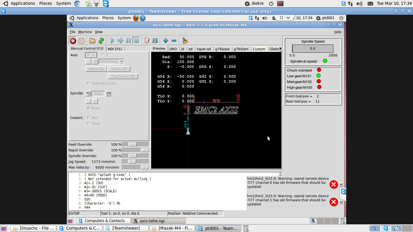

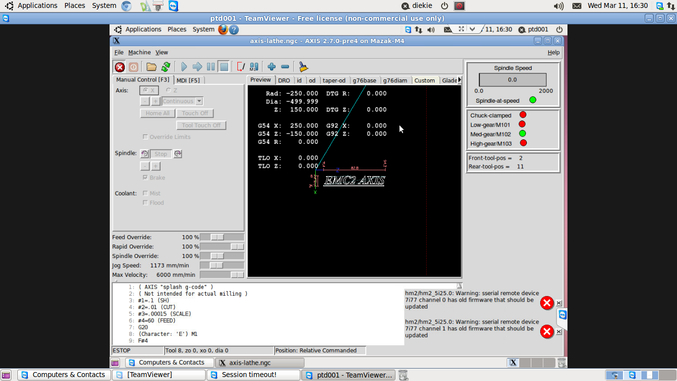

I am in the process to try this, but having difficulty. I tried to look for documentation that explains this process of updating the 5i25, but can't find anything.
I did the following:
ptd001@ptd001:~/linuxcnc/5i25/utils/linux$ sudo ./mesaflash --program 5i25_7i77x2.bit --device 5i25
ERROR: Board 5I25 doesn't support FPGA resetting.
any advice please. even a link to the correct documentation.

11 Mar 2015 18:51 #56667
Replied by andypugh on topic 2.7
Why do you think that an update to 2.7 requires you to re-flash your 5i25?

11 Mar 2015 19:00 #56670
I think that is actually referring to the firmware on the 7i77 rather than the 5i25.
I know of one way to update the firmware on a smart-serial remote, but it isn't terribly elegant.
www.linuxcnc.org/docs/2.7/html/man/man9/setsserial.9.html
There may be another way, I am not sure.

11 Mar 2015 20:10 #56674
Yes, you need to set the 7i77 to a lower baud rate to flash firmware. But you also need to find the firmware.
I suggest waiting for PCW to say something before jumping in.
At the moment you have a working machine which pops up a warning message. A failed re-flash might leave you with a non-working machine.
do I need to set any jumpers?

- Diederik
- Posts: 213
11 Mar 2015 21:35 #56679
by Diederik
Replied by Diederik on topic 2.7
It's still giving the same error.
I'm not sure what to do from here. seems like 5i25 is updated successfully now, but still requires some other update.
I have another machine exactly the same that I will need to update. I'm getting worried now, because I am trying so many different things, that I don't know what I have done to get where I am now. it would be nice to have some instructions so that this excersize will not be so painfull. I have done 27 machines to date, and would like to do the updates to all machines.
