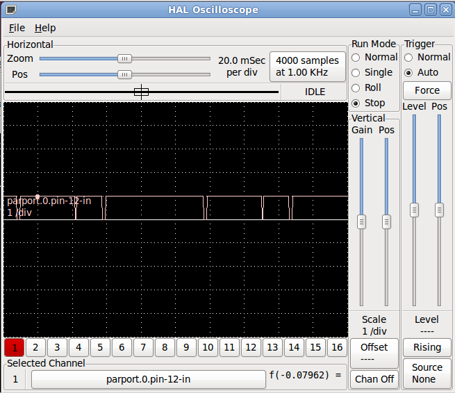

09 May 2015 22:50 #58521 by fc60
Replied by fc60 on topic joint 0 on limit switch error
Greetings andypugh,
"Try running with only one connected at a time, when running the VFD and monitoring the pin with Halscope."
Some clarification for the above. The sensors have three wires. Two appear to supply voltage to the sensor and the third is used as a "trip". The power wires are all soldered together. The "trip" wires have spade lugs and are easily disconnected.
When you say "one connected at a time" does that mean all the wires; or, just the "trip" wire?
According to the BOB documentation, "pin 12 > limit switches status to PC".
HalScope offers two pin 12 choices. parport.0.pin-12.in and parport.0.pin-12.in-not. I selected the former and an image of the result is attached.
Cheers,
Dave
10 May 2015 18:03 #58532 by andypugh
Replied by andypugh on topic joint 0 on limit switch error
When you say "one connected at a time" does that mean all the wires; or, just the "trip" wire?[\quote]
Yes, you can leave them all powered.
Do you know if the sensors are NPN or PNP? I seem to recall that one variant is better-suited to use with 5V logic than the other.
If you look at this page: sensortech.wordpress.com/2011/01/18/indu...e-basics-npn-vs-pnp/
You can see that PNP switches the sense line to GND and the other switches it to +Supply. As most proximity switches don't work below 8V (I have some that say 8 - 30V and some are 10 - 30V) switching the BoB inputs to +12V or + 24V might not be what you want to do.
In any case you want to look at the opto-coupler in the BoB input as the "load" in those diagrams, and try to think in terms of current flow through that opto-coupler rather than voltage to the pin.
The Halscope shows the output permanently high with noise spikes pulling it low. This isn't what I had expected to see as your limit switches seem to be connected to the same parport.0.pin-12-in.
What does the trace look like with the VFD turned off? If it is permanently low then I am very puzzled about what is going on.
