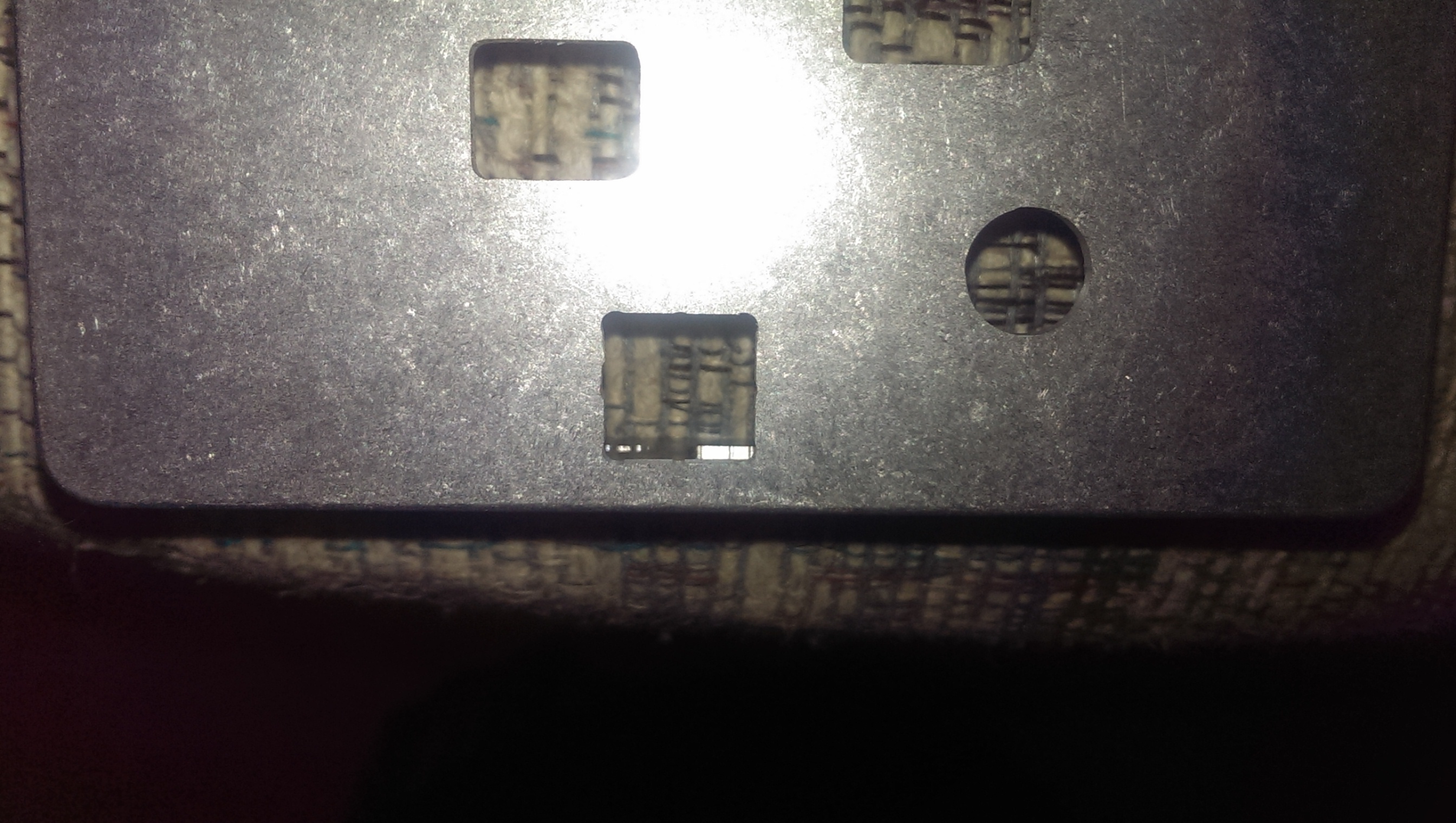

Hello,

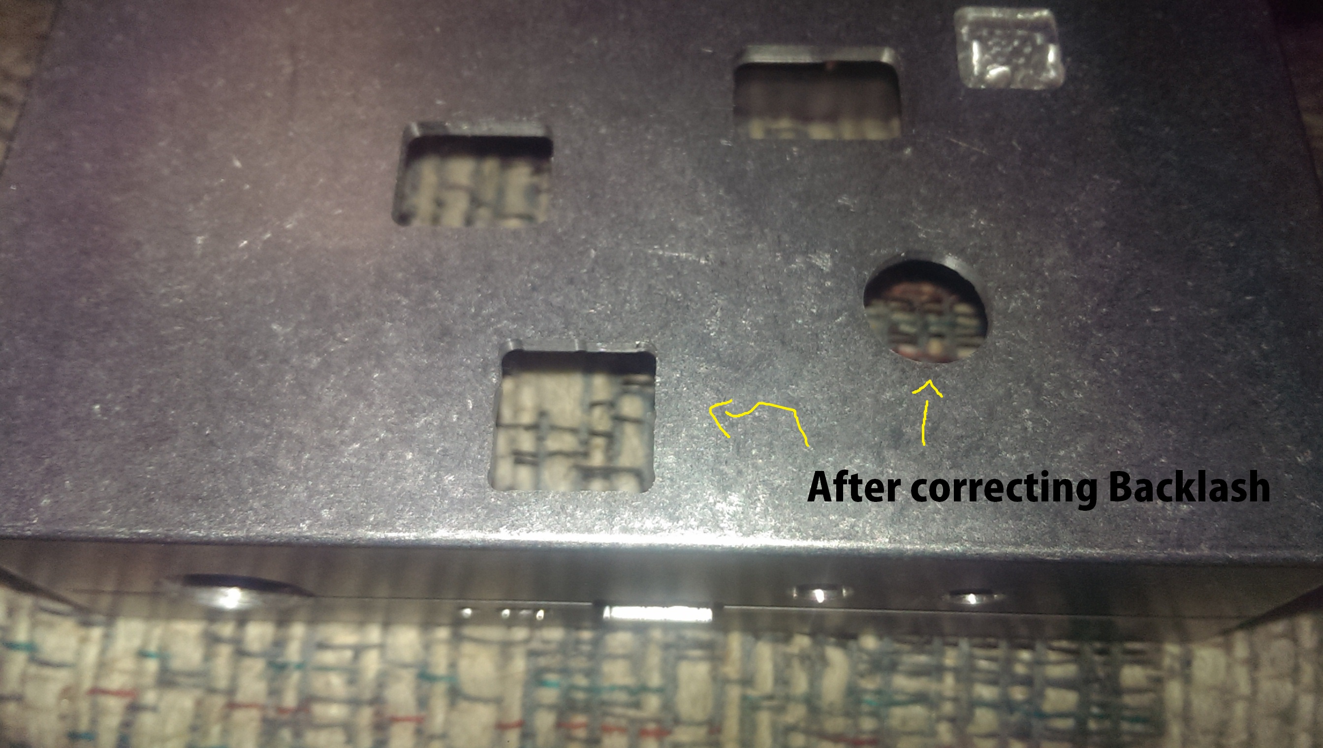

I use my sherline for customer work. I used to use a manual sieg x2, and I was able to produce squares/rectangles that were almost perfect by just counting units on my hand wheel, now with the sherline, I figured I would be able to get perfect shapes, but it looks like the mill is going to far, or not far enough etc. This isn't too much to expect right?
I used a interapid switzerland dial gauge (accurate to .0005") to measure backlash. And I entered everything in to the .ini while also adding 1.5 - 2x the acceleration or whichever unit I needed to change. I had to go back into the .ini a couple times, but now when I got +.01 mm 10 times on any axis, and then go -.01mm 10 times back I end up in the exact spot I started. Completely eliminating backlash, at least within the system. My largest backlash adjustment was .2 mm the smallest being around .03mm. Seems like a lot, could that be the problem, making up that much backlash?
It looks like my circles look a lot better. When I say a circle, I mean I'm taking a approx. 1mm endmill and having the machine cutout a (the most common is 7/16th") circle. My rectangles/squares just look like garbage still. It's just ridiculous in my mind. How much better I could get on the Siegx2 manual mill just using the hand dials.
Do you know what else there is to adjust to do a better job?

Here's a couple links to some other engraving work my mill has done. I'm not sure how it produces such accurate looking engravings, yet the squares, circles look so off.

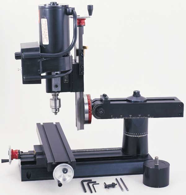

I don't own any hobby mills but I did play with a friends Sherline lathe once but could not get it to cut aluminum so I gave up.
Here is a photo of a Sieg X2 and it is 10 times the machine the Sherline is as far as mass.
If your Sherline looks like the photo ArcEye posted then IMHO your expecting far too much from it.
Software will not fix machine problems.
1. Backlash and CNC don't work well together. If you have backlash you will see that in your finished product. While backlash compensation does exist it is not the answer to a sloppy machine.
2. Weak flimsy machines can flex as cutting loads are applied. This also will show up in the finished product.
3. The lead screws on the Sherline look like normal all thread and that is not very accurate. Have you mapped the screw out to see how far off it might be. LinuxCNC does have mapping compensation .
I have seen some videos from a guy in South America that has modified his Sherline to the point he can make some nice things on it.
