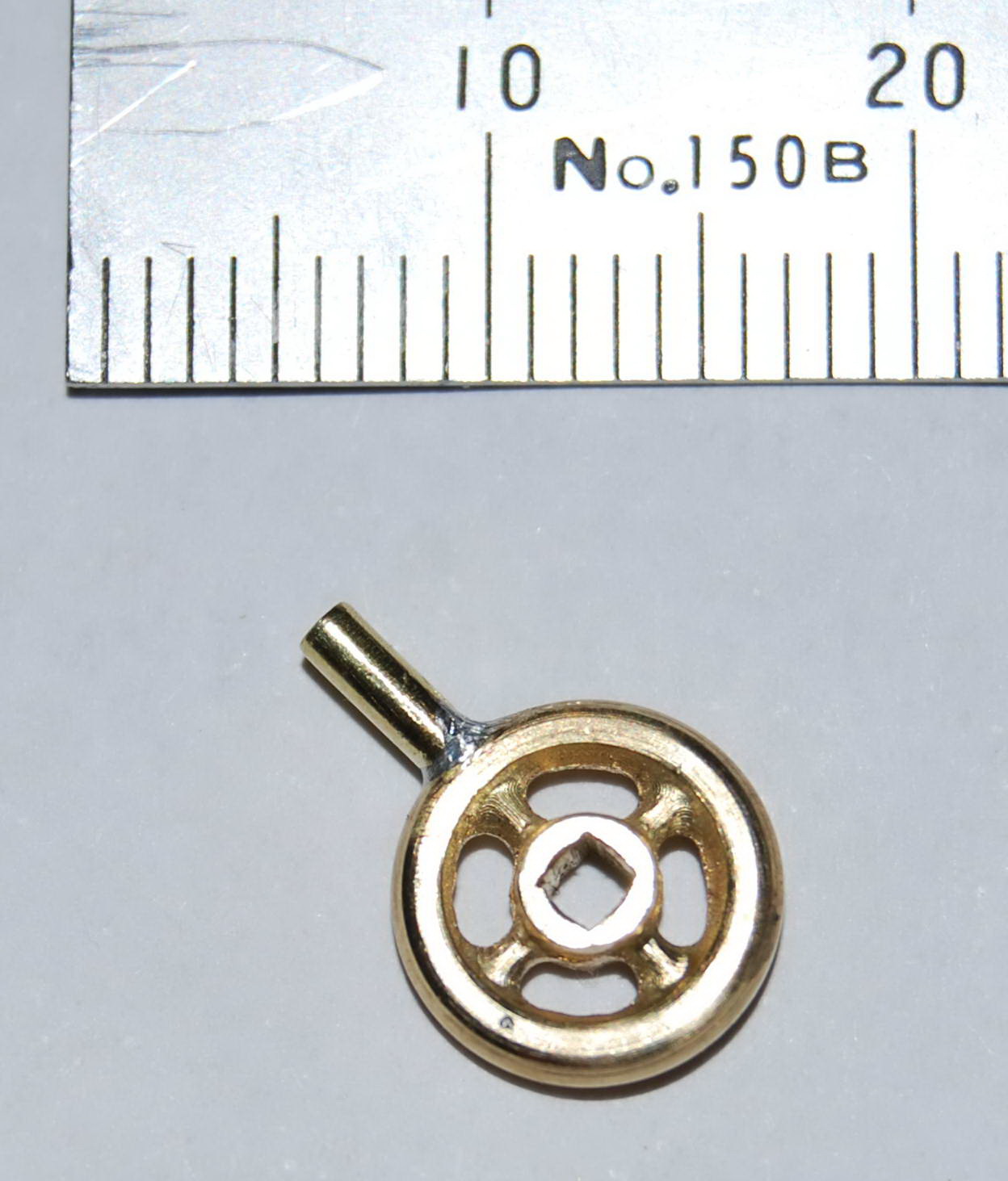

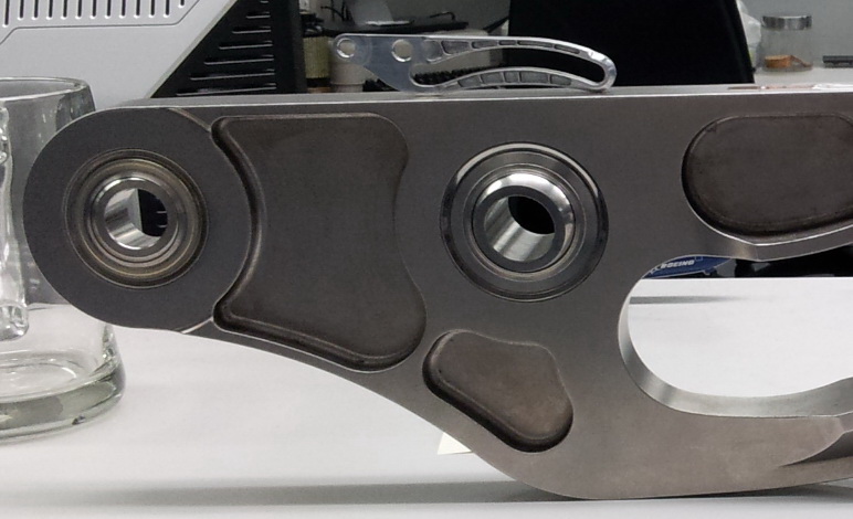

On the sherline mill (the 5xxx version not the 2xxxx "flexy" version) I noticed that I could not seemingly spot drill, then drill thru without seeing the drill noticeably bend. It looked like the y position had moved. What it actually turned out to be, was that the Z axis gib was too loose, letting the spindle deflect towards me when spot drilling, and hence the spot was not in the same place as when the drill came down.
Moral - get the gibs tight, but not so tight the steppers stall when cutting!
As for backlash, I also had issues with things out of round - in my case radius on the end of levers. I fixed it to a satisfactory level of accuracy for what I was doing as follows.
Minimize the mechanical backlash using the mechanical adjustments. Measure using a dial gauge what it is. (at several locations if you care enough)
Use the electronic backlash compensation in LinuxCNC. That's pretty well the best you can do for a low cost hobby machine like the sherline.
You can do useful stuff with the sherline in Aly, Brass, Steel and even Ti, provided you are not in too much of a hurry.
See below a handwheel for my 45mm loco] made using a 0.8mm ball mill. This has had only a cursory de-burr. Sorry about crappy soldering!
Also a miniature aircraft flap track done as a trophy for a work collegue. It's 1:20th full size and sitting on a similar "real" one. Now the real one takes some serious effort to machine!
Edit: Attached my config for comparison (note it is an inch machine!)
