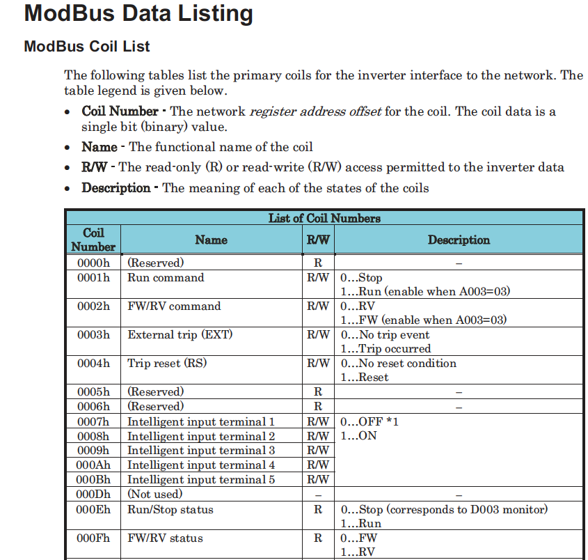

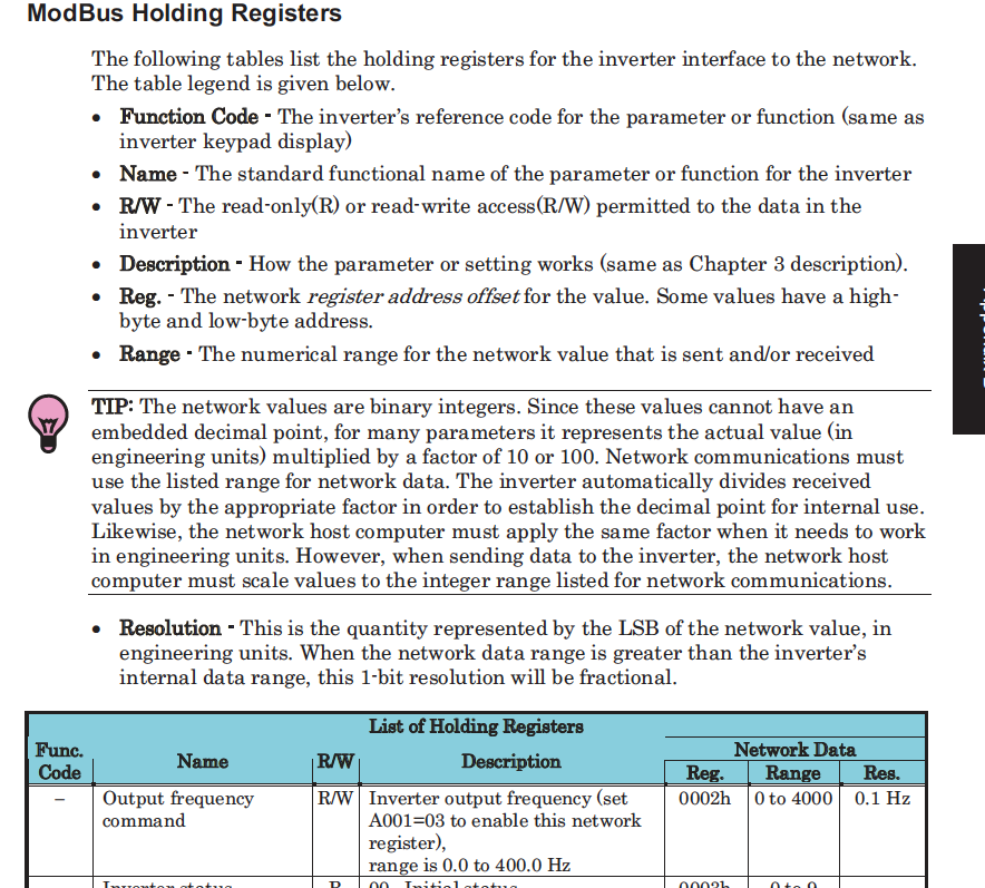

26 Jun 2015 13:08 - 26 Jun 2015 15:03 #60151 by racedirector
Replied by racedirector on topic Modbus Help - ClassicLadder
Ok, some info.

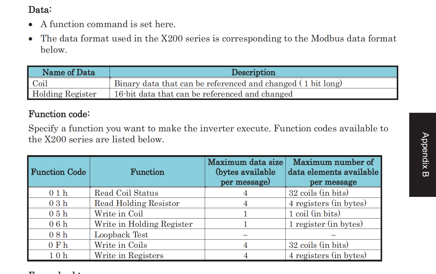

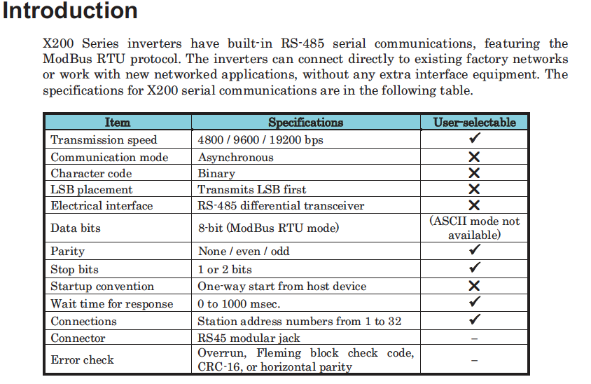

Firstly, the full X200 manual is here: www.dietzelectric.com/documents/Hitachi%20X200%20Manual.pdf
Attached are screen grabs of the relevant sections, Coils, Register and Functions

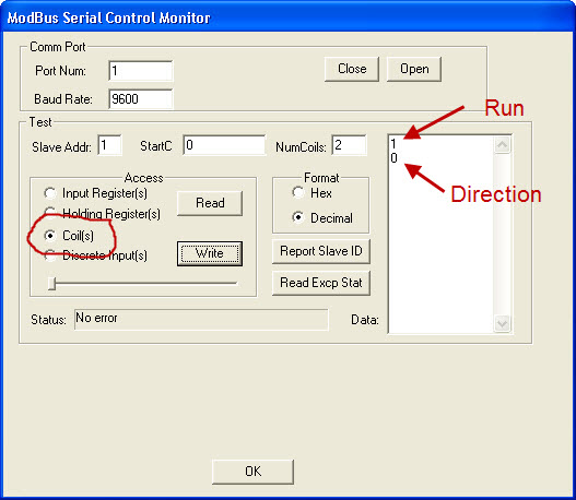

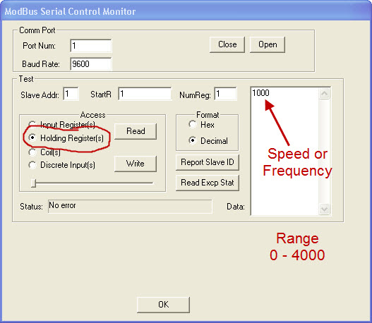

My VFD is set to talk @ 9600 N-8-1 on ttys0. I found out that the Mach3 Modbus Output Coils *IS* Write Coils. X200 has 2 coils of interest starting at 0 writing 2. These set the stat=us to either Run or Stop. Output Registers *IS* Write Register. The X200 has one register of interest starting at 1 writing 1. This sets the frequency.

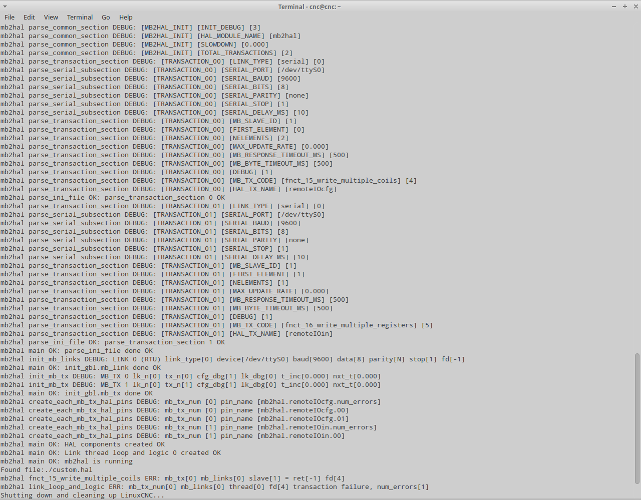

I tried ClassicLadder and finally got it not spewing errors. I switched to Mb2Hal with the following ini and additions to my hal file.
So far I haven't got the VFD to do anything, I need to figure out how to join everything up so I can M3 etc to control it. I must admit I am further long than the other day.... I think.
If the contents of the ini can be confirmed I can do a little more research on connecting things to hsl pins etc
Cheers
Bruce

Oh, and I tried running MB2hal in halcmd but kept getting memory segmentation errors and halcmd died.not sure why....

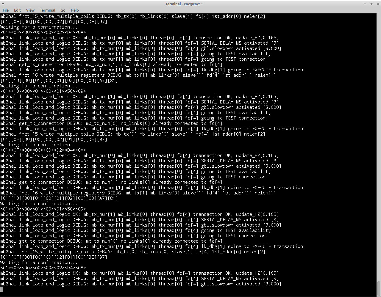

26 Jun 2015 13:32 #60153 by racedirector
One more thing :)
Screenshot from the MB2hal session
26 Jun 2015 14:19 #60157 by VNR
Replied by VNR on topic Modbus Help - ClassicLadder
change in the modbus ini file:
SLOWDOWN=0.0 -> SLOWDOWN=3.0
DEBUG=1 -> DEBUG=3 (both of them)
you should get a better level of debug messages
paste the result here, please use a bigger screenshot than before, i am getting old B) :laugh:
Cheers
Victor
26 Jun 2015 15:33 #60160 by racedirector

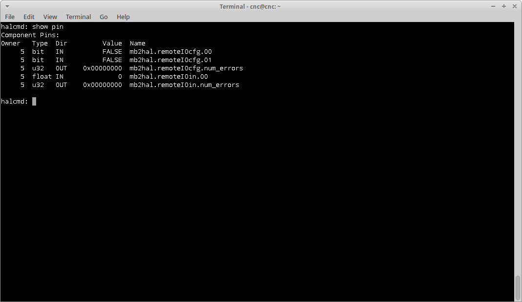

Okie dokie, here's revised screen grabs - DEBUG on each txn set to 3, SLOWDOWN set to 3 plus I managed to get halrun to show me the pins in mb2hal.
Hope these ones are better :)
Cheers
Bruce
26 Jun 2015 15:49 - 26 Jun 2015 16:05 #60161 by racedirector
renamed the txns to spindlerun and spindlefreq.
So now mb2hal.remoteIOcfg.0 is now mb2hal.spindlerun.0 and mb2hal.remoteIIOcfg.1 is now mb2hal.spindlerun.1 and mb2hal.remoteIOin.00 is now mb2hal.spindlefreq.00
So I suppose my next task is to figure out how to connect those to usable hal pins :)
EDIT: I think mb2hal.spindlerun.0 controls the run/stop signal and mb2hal.spindlerun.1 controls forward/reverse so both should be renamed to something like spindle-run-dir given the info (from a MACH3 post) in these pics:

26 Jun 2015 16:30 #60162 by VNR
It is working.
Dont' forget to reduce the SLOWDOWN and DEBUG parameter once on production.
That's right, but first use halcmd command line to test, then configure the INI file.
